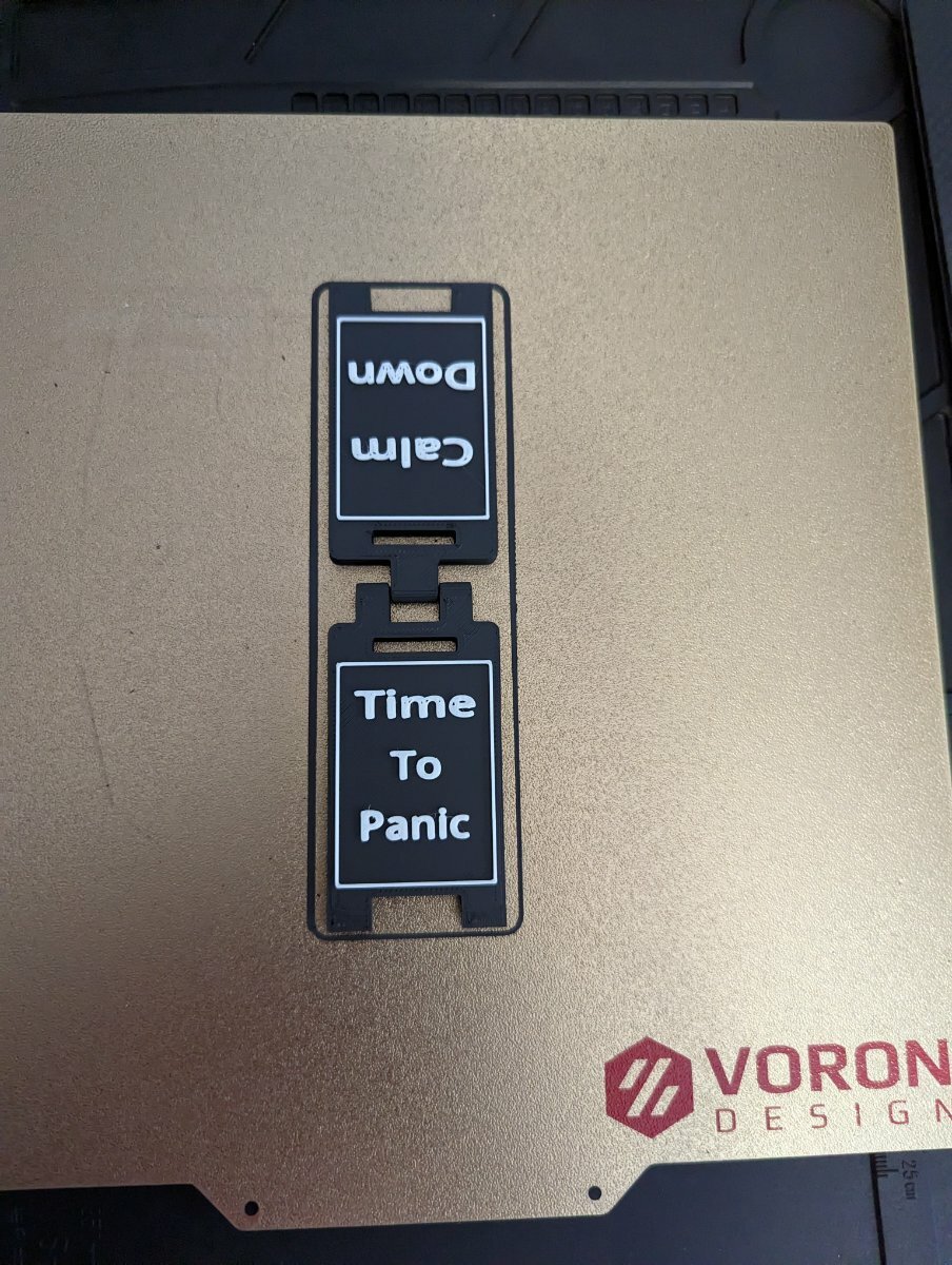

hmm as I often change Colors to have better readable texts on eg keychains or labels i'm currently limited to use my Prusa, where this feature is greatly included.
