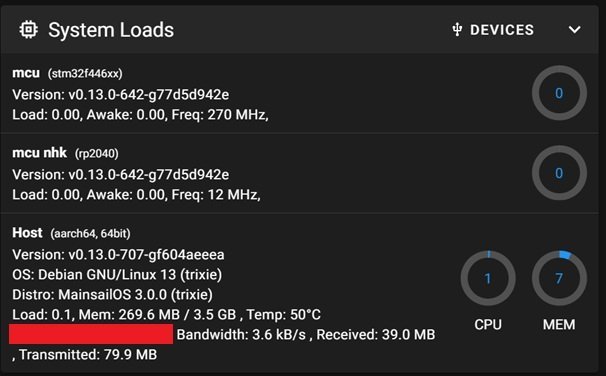

Klipper runtime warning MCU 'mcu' configured for 180Mhz but running at 270Mhz!
Hello All!

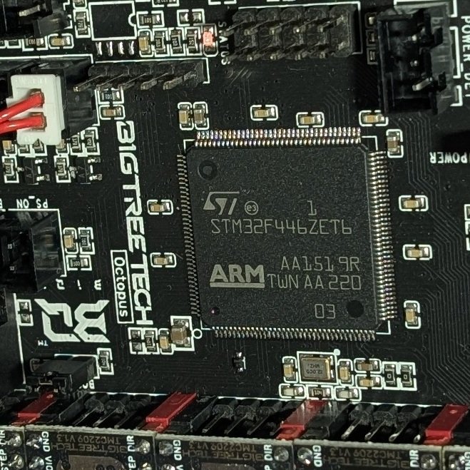

I have tried everything that I can think of to get rid of the warning in klipper "Klipper runtime warning MCU 'mcu' configured for 180Mhz but running at 270Mhz!", but the darn thing is still hanging on there. I suspect there is a mismatch between my printer.cfg [mcu] clock settings and what the STM32F446 is actually seeing, but I'm not sure where to verify or adjust that. Heads up, I couldn't get the printer to include my nitehawk.cfg file, so I had to integrate it directly into printer.cfg (I'm going to attach that here at the end along with the klippy.log and system loads. It's going to look funny, so just figured I'd get ahead of that). So far here is what I've tried.

    • BTT Octopus v1.1 (Chip STM32F446ZET6)

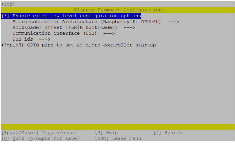

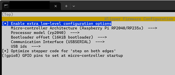

  • Firmware Recompilation:
    • I followed the LDO guide for the Nitehawk-SB: selecting Raspberry Pi RP2040 & 16KiB bootloader offset, enabled "extra low-level configuration options", and added the !gpio8 pin to the "GPIO pins to set at micro-controller startup". Clock frequency is not an option in the menu connfig.

Has anyone experienced this and found a solution? I've been through the Voron discord to no avail, and I'll post this there later if you all are stumped as well. What are my options here? Attaching pictures of the make menuconfig, octopus v1.1 board, system load information, as well as my printer.cfg (combined with nitehawk.cfg, and klippy log.

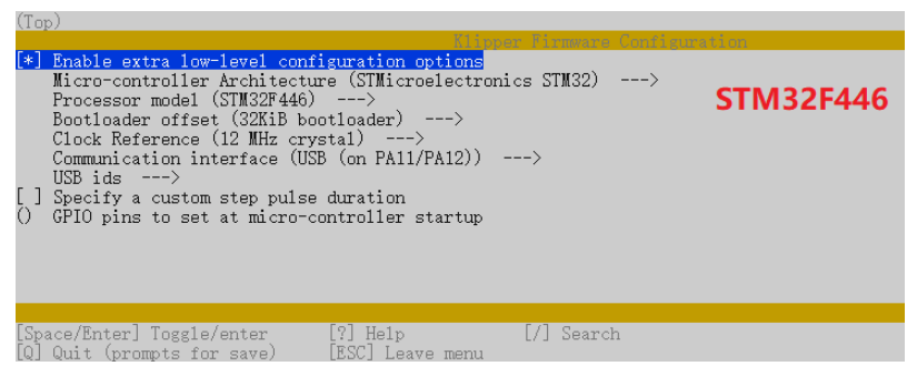

"mcu" normally refers to the printer board - the BTT Octopus. Have you tried reflashing the Octopus board?
The above would be the settings for your Octopus board  designate [mcu] in the printer.cfg file - see theOctopus v1.1  GitHub page.
The nighthawk will then have to be flashed separately with the settings you showed which is [mcu nhk]
