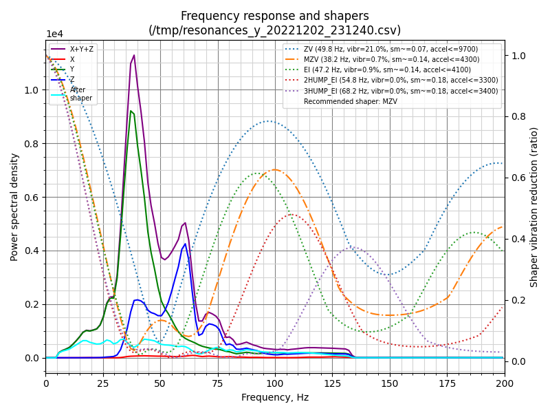

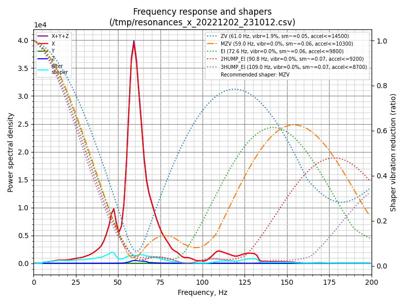

Absolutely normal results, Y is a totally different movement than X.... X only has to move the weight of the duct, where Y has to move (the weight) of Duct and X gantry.
I had a result on my V0 that I dont even want to share, X normal, Y, three peaks, but it doenst matter, input the data and it will do wonders.
You can rerun it a few times, but if its the same, its the same, its good!
