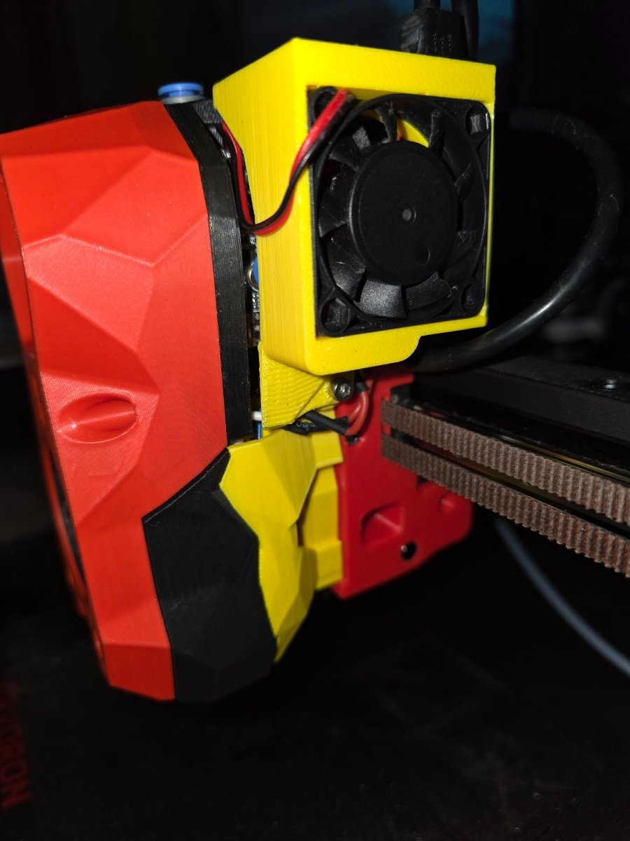

I've already tried all that, and now I've also glued all three heatsinks to the board. The only downside is that the fan should stay on because the heatsink for the TMC2209 stays warm longer. I'm going to mount everything on the X-axis and do a test print. Since I had to mount so much, I'll recalibrate everything first and then print... then we'll see. Thanks for your help...

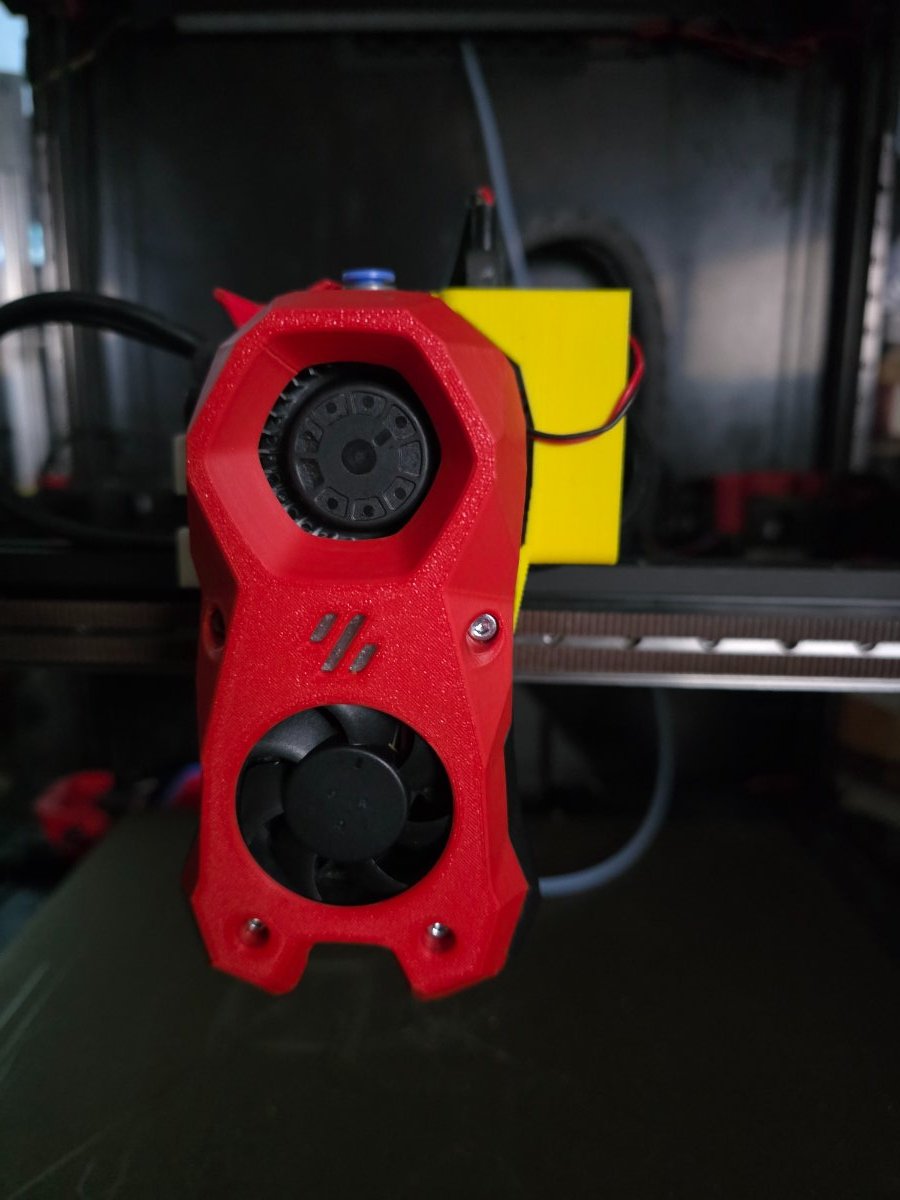

Hello, another update on my problem: I completely redesigned the base of the Stealthburner to prevent misalignment and inaccurate assembly. I joined the rear motor and extruder plates as a single unit, ensuring the front panel is mounted straight. I also changed the fan's airflow direction from the outside to the inside. Now I have values for a 500mm extruder NTC at 52°C and the motor at approximately 55°C, with a run_current of 0.65. If it stays like this, I should be satisfied.
