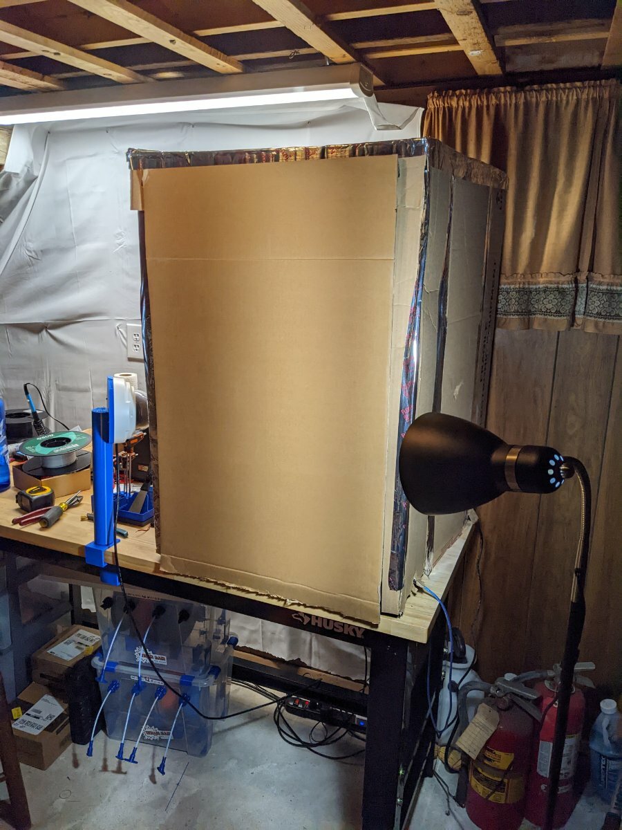

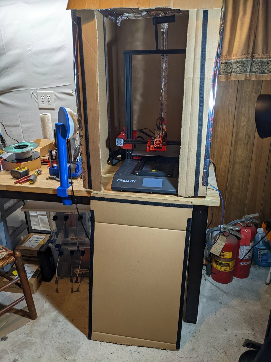

I decided to take your advice and try to build a cardboard enclosure as I had an over abundance of carboard and silver duct tape lying around, and here is what I came up with. I made the front face attach via velcro so it could be removed more easily to take the box on and off (short ceiling in my basement, gotta finagle this thing on and off the printer.).

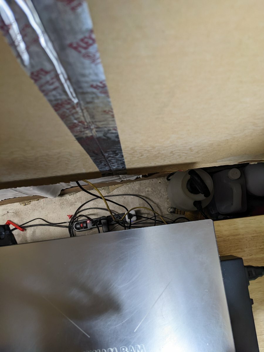

I know air tight isn't the goal with something like this, but due to the depth of my desk I do have a small gap at the rear of the base of about 4 or so inches. Do you think I should seal this up before printing, or will that be okay? it can be seen in the final photo.

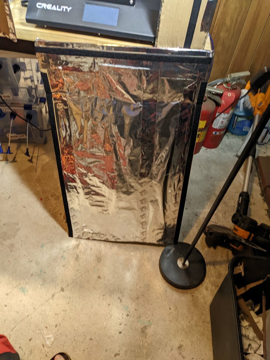

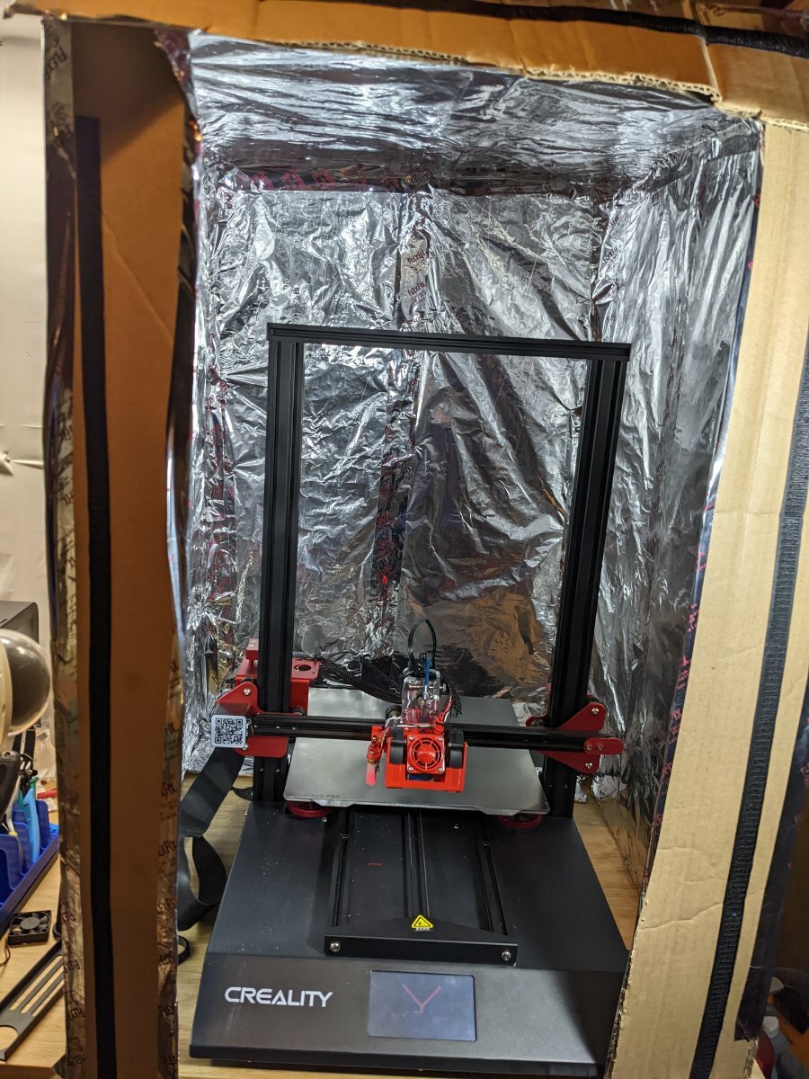

Part of Fun of building a Voron. The cardboard box will work well for printing ABS. To help minimise the possibility of warping, consider a chamber "heat soak". Heat the bed and hotted to the desired temperature and allow to settle for 20min or so before starting the print. Lining the inside of the cardboard with some foil will prevent accidental fire to the cardboard. (The chamber may reach temperatures up to 50C). I initially used a fire blanket over the cardboard enclosure for additional safety

Draft is the biggest enemy to ABS - it causes warping. Seal it if you can - duct tape or even a temporary seal such as a piece of foam stuck into the gap.

Can I just use standard aluminum foil for this?

That box will do fine. I had similar (though smaller) gaps with the box over my Prusa Mini. It worked fine. The only parts that gave me trouble were the feet and skirts. Those are the larger parts, so warped. I used some glue stick and big brims and that solved my issue.
