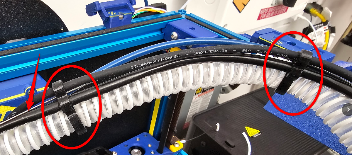

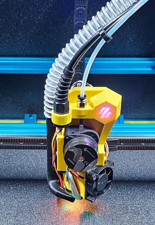

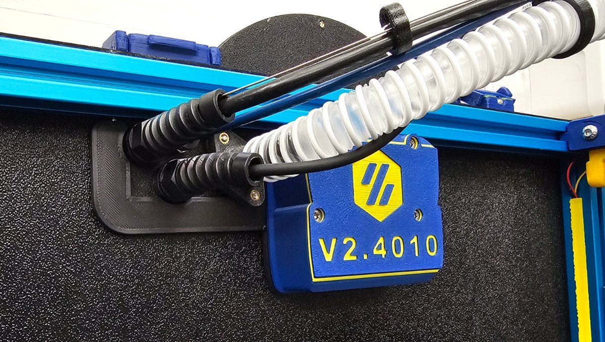

For my custom toolhead and CPAP system I have incorporated PG7 Cable Gland for every umbilical cable for both ends:
and to keep everything from flapping around, I have printed some TPU rubber holders to guide everything together. Also, to keep the cable/tube curves smoother, I have added a piano wire. At this moment there are 2 wires (CAN and USB nozzle camera)  and the CPAP air tube.
PS. The toolhead picture shows only one cable (CAN) as the picture taken before added the nozzle camera!
I am working to add the PG7 Cable Gland for the nozzle camera cable too.
