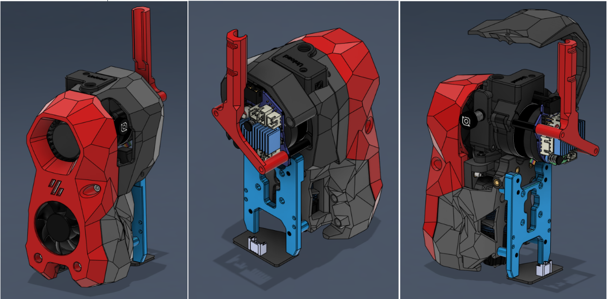

Extruder gears have been an issue since very early on. So much so that vendors are selling precision extruder gear sets, etc. and the issue goes even deeper when you give people STL files to print and inserts to melt in which imparts a good amount of variability in part size, shape, strength and how well the fit and work together as an assembly. I have storage bin full of old after/stealth burners and other old extruders. I found that over time I'd need to unscrew the fan shroud and tighten everything down every so often as the stress, vibration and heat cycling from printing tended to loosen screws over time. Eventually I built a RatRig V-Core that came with a Bondtech LGX-Lite extruder which led to me swapping out the CW2 extruder on my Voron 2.4. These days I'm rockin' the Orbiter 2.5 with Orbitool o2s toolboard and Smart Filament Sensor. It's been a really good combo so far.SBOrbiter-04.thumb.png.7d3635527bb3adc249edf704e2e702af.png

I recently picked up the Orbiter 2.5. I like the Cable Cover door in this model. I have been looking at the orbitool board, or the nighthawk.
Do you have a link to this model for the cable cover? It wrapps fully over the top and I really dig that!
Here's a link to my 2.4 Refurb Build Diary...
The arrow in the upper right takes you to the CAD and STL's that you can download / modify to suit whatever you need.
So, a couple things to be aware of...
Print and use all of the parts as a set, they work together and you could have issues if you reuse old SB parts.
The front hotend fan is moved 1.5mm forward to clear the center hub in the extruder. The front cowl is also sized for standard length hotend or you can print the one that I recently created for @TitusADuxass that works with the Rapido UHF hotend.
As for the flip up door... It kind of flips up. What I mean is it used to flip up until the new smart sensor came out. It's a little taller so if you want it to flip up... it'll need a little 1-2mm trimming or you're welcome to edit the CAD model. TBH, I've never once had to open it or change the tension screw once I had it set and by set, I mean turn it in until it stops and then a 1/4 turn. It's also possible to unscrew the tension screw and rotate the tensioner out without even flipping up the door.
The design utilizes a generic Fysetc CNC Carto/Beacon mount. I'm pretty confident that any Voron mount would work, even the printed ones. In fact, the only Voron part you'll need to hund down and print is the hotend mount. Any of the ones on the Voron Github will work.
And lastly... I recommend taking a look thru the build diary. I designed some pretty cool stuff that's also on there like an upgraded rear filter box with activated carbon sheet and hepa filter, camera mount, full Fusion 360 tutorial on how to design a custom klipperscreen, etc.
