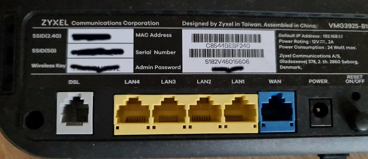

If it's helps here's an image from the back of a random wifi router that I've got. It's purely illlustrative as there are oodles of different models:
The yellow ports (the colour is not actually relevant) are the ethernet ports I was talking about above (they are referred to as LAN (Local Area Network)  ports). There are also the labels giving me the (default) WIFI SSID (both a 2.4Ghz and 5Ghz versions, not very helpfully labelled as 2.4G and 5G) and possibly most important the Admin Password. If I wanted to reconfigure the device I would point a web browser at the router's IP Address (most likely the default gateway address on all the other devices) and use that Admin password (probably using the login name "admin") and I could reconfigure it.
If your Internet Provider  hasn't provided a manual for the router, you could possibly google one using the model  number off the back of the router. Trouble is the manual would not give you the admin password....that will have been set by the Internet Provider (unless they left it at factory default, which will be in the manual).
