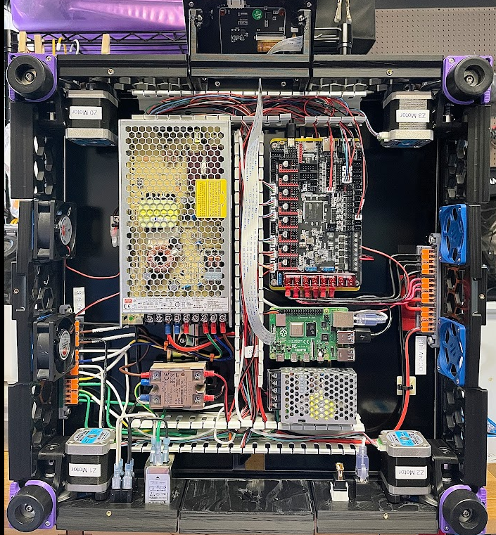

The 300mm model I built was a lot of fun to do, and along the way I ran into some neat mods that required me to shift gears a little along the way. These include the new front X/Y idlers, the LDO style electronics bay layout (including the wire channels), toolhead PCBs, hall effect X/Y endstops, sexbolt Z stop, Nevermore air filter, and after having trouble trying to get the supplied Omron prox sensor probe working I switched it over to the Euclid probe with a gantry mounted dock.
I love Klipper and how it's whole ecosystem works -- it's really cool. Coming from a programming and linux systems admin background it's right up my alley. I am still working on fine tuning things, and love the new "Z calibration" script that auto sets the Z height for you based on bed measurements. My next mod is the nozzle brush cleaner, although I am concerned about the potential for it touching the Euclid probe part on the toolhead. I have some of that yellow tape I'll use, but I'm hoping I can mount the brush low enough that there's no chance of it contacting the Euclid electronics.
Well, thanks for reading my long introduction, and if you've made it this far I'll reward you with photos of the build, with this link.

Love the pictures, we do always love a good build around here, nice neat wiring in the electronics bay. Beyond modding your current baby, guess the onlly question that remains is: What you building next? (For clarity, that'll be another Voron, and we do expect a build diary 🤣 )

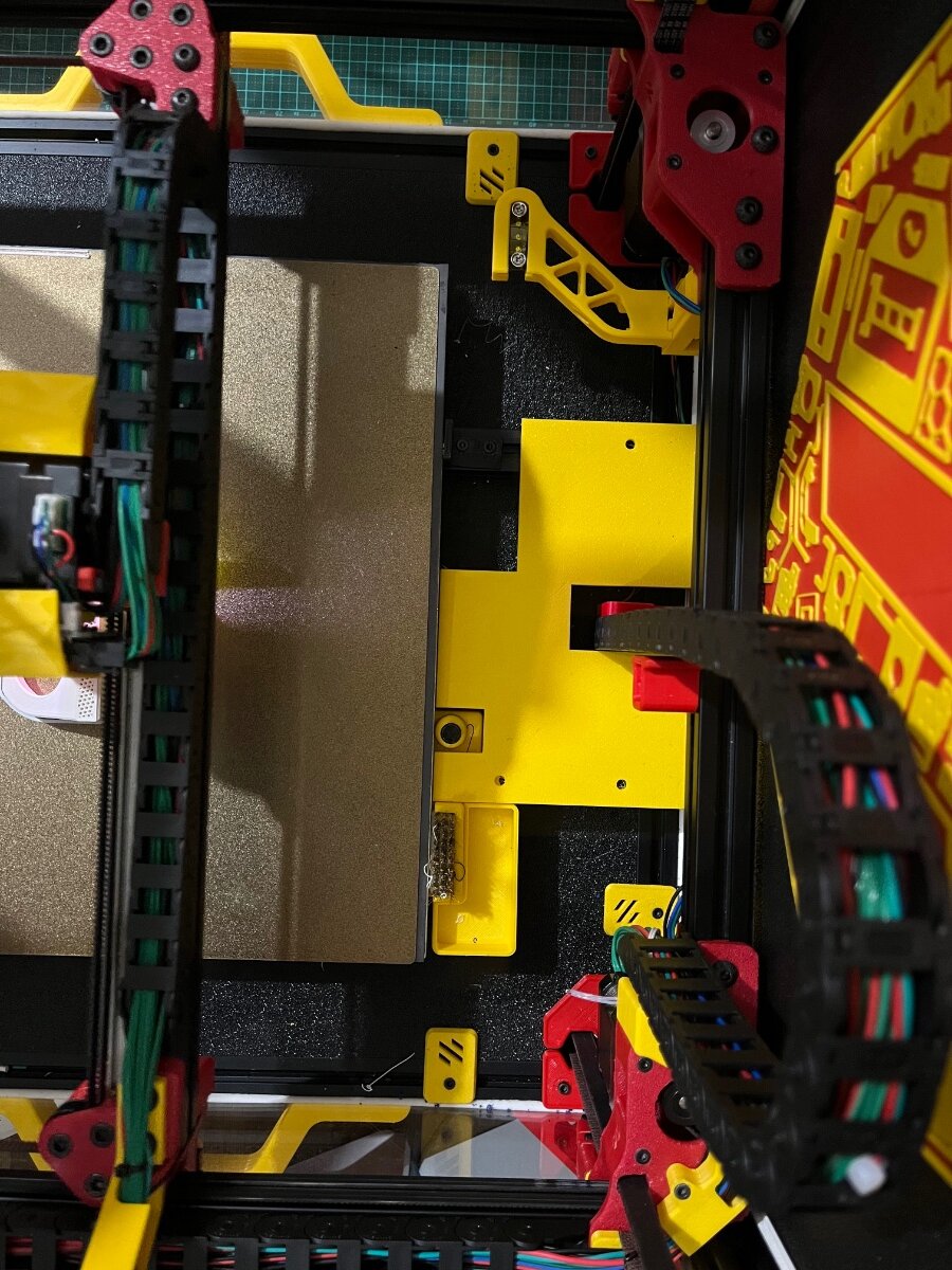

This is the setup I went for - Well away from the Euclid probe and works great
https://www.printables.com/model/201999-nozzle-scrubber-with-a-little-bucket-for-voron-24
As seen in the picture(not the best) taken from the top, the Euclid is on the left and the nozzle scrubber on the right - well clear of the probe.

While I run Klicky probe rather than Euclid, my layout is generally the same as @mvdveer shows. I keep the probe locked on the toolhead through my startup procedure, so it's on there while I clean the nozzle. No issues at all, I just make sure to have the toolhead movements keep the probe clear of the brush (i.e., get front-to-back moves done before  and after scrubbing).

Nice butt side:
Mine looks likje this:
