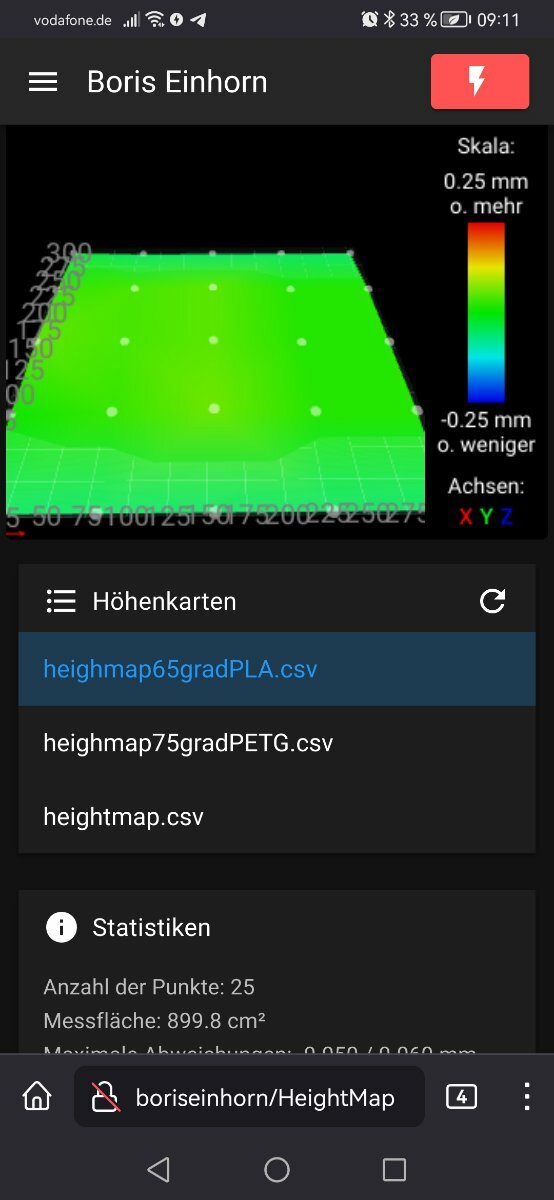

Currently im rebuilding my custom Cartesian Printer to print all the voron parts but I have a major problem :
The z plane is tilted and I try to go away from zero it with switches.
I did reguild it so the bl touch is tramming both z axes and the gets the zero point in the middle of the bed.
But 2 questions coming up :
1.
Is it before or after tramming needed to pre level the bed?
2.
I used the old z diff distance for the bl touch.  Is it needed to tramm the bed and the recalibrate the z height of the bltouch?
Aditional Info for the bed:
I have a magnetic change system where I could use PEI sheet and FR4 but currently I'm using FR4 and can't use a Inductive sensor.
Fot tips hints and a advice I am happy,  helps me speed up the voron build.
