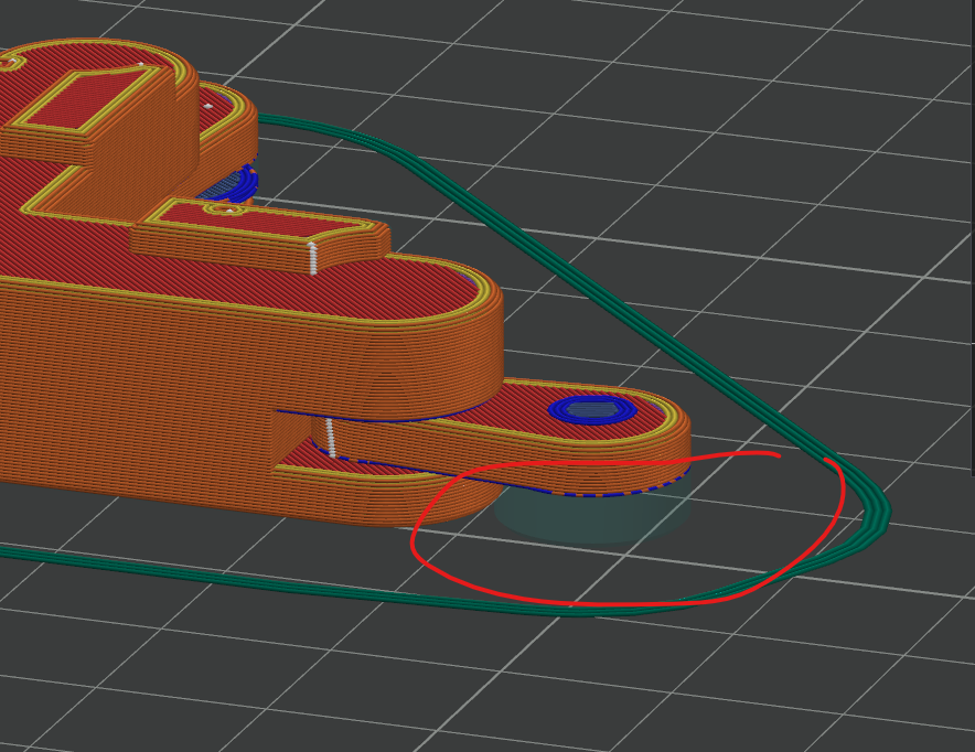

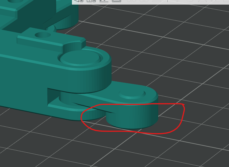

So, I was attempting to print some new panel mounts which I have printed in the past with no issues but they kept failing.  I almost gave up but went back to look at it layer by layer.  It turns out that for some reason, OrcaSlicer was removing parts of the print!
Here it is in the preview. Pay attention to the area circled.
Here is the print sliced.  It removes the area circled!  You can see that its showing the model as is, but its not slicing it! And its not printing it(the area circled.  This obviousely ends in a failed print.

This is Orca Slicer, current version, 2.3.0.  Yes the part that was not sliced is supposed to and does touch the build plate.  In looking closer at this there was a warning that came up when I loaded the model that I missed.  It was for non-manifold edges.  I found this when I cleared the plate and reloaded it again in Prusa Slicer and it also complained but in a very different way.  I was able to repair it there using the windows service repair method and it sliced fine.  Back in orca slicer I then noticed the non manifold edges warning and clicked repair.  So, it was just a model that had some issues and I missed the warning box in my haste to run a few of them off for the new side panels.
