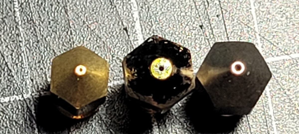

Okay, so I know this is a thing everyone has heard, and generally "gets" but I had to re-learn this lesson today. And maybe this is in the wrong section of the forum, but the frustration I was facing was all around trying to tune ABS on my prusa so I could print my voron 0.1 parts, so maybe it's worth saying if it saves someone else the day of test/calibration prints that make no sense. So, without further ado, here it is:
If you just can't get a new filament tuned (extrusion multiplier, temp, etc) on your "workhorse" printer that you sort of neglect and just throw anything at, maybe check your nozzle? I had a Microswiss hardened plated tool steel nozzle on my prusa mk3 that I've printed countless spools of anything and everything on. I re-learned today (while struggling to get ABS to print cleanly so I can print my parts for a voron 0.1) that just because a nozzle is hard doesn't mean it's impervious to wear. Picture: (left is a new .4 brass nozzle of a different type just to show the reference opening size, middle is my "formerly .4" hardened plated tool steel nozzle, right is a new .8 microswiss hardened plated nozzle).

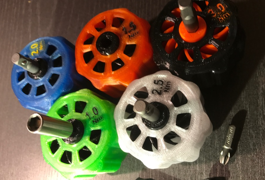

I can advise a good nozzle tool, I love this print and it works wonders... - https://www.thingiverse.com/thing:2613057
I printed mine in PLA+ and it clicks on 2.5Nm, what is often a good tension I think.

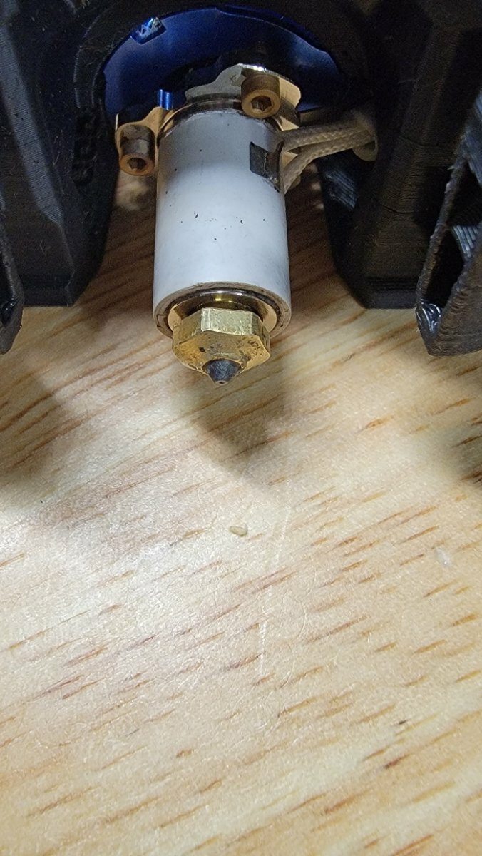

FWIW... I use Diamondback nozzles. They don't wear out. Ever. All you need is one. Period, End of Story.
Here's my nozzle after printing at least 2-3 spools of white and as many in Glow in the dark. Zero wear after running 3 miles of filament thru it. And don't believe and of that "Oh, It's only a diamond tip and it will come loose and break off BS. I've lost count of how many times I've dragged it along the bed, etc. plus the company that makes these has been making diamond tip drills for industry for the past 30+ years.
