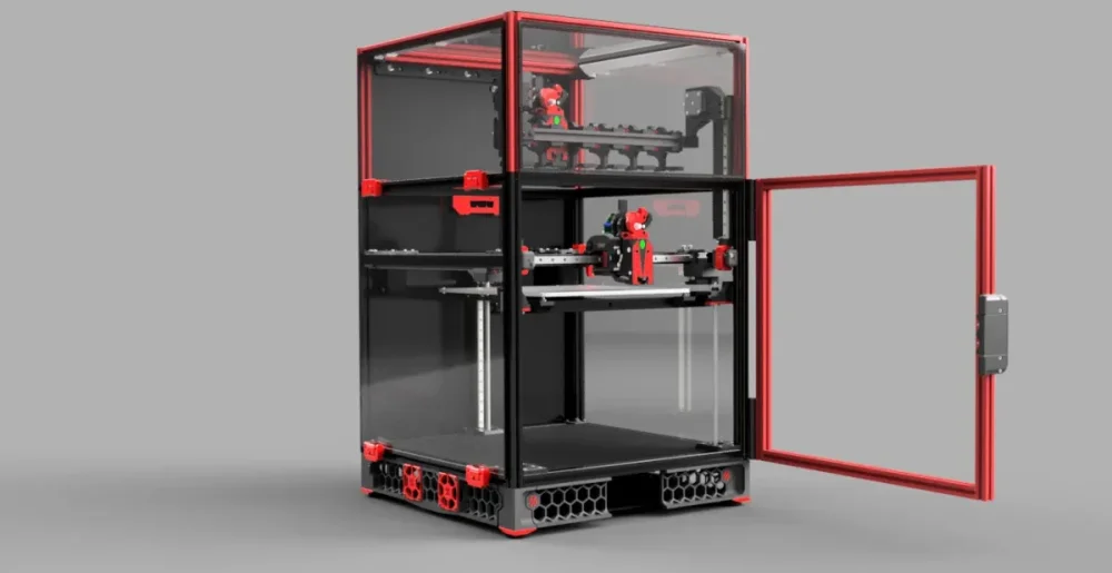

Using the STEP file, release 1, from the Bondtech Github I have done some studies on how the INDX system possibly used with a Voron 2.4r2.
I believe a Voron 2.4.r2 can be adapted for INDX system by only moving the vertical linear rails 35 mm from the bottom and adding a stationary 2020 extrusion almost to the top for holding the Nozzle Tool Carrier. With this configuration, we should not lose any printing space! For a heated chamber, a “hat” enclosure will be added to accommodate the PTFT tubes and retain the heat. All existing panels, doors etc. will be used. My current CPAP system, cable entry etc. will mostly work with some minor re-design.
I am waiting for the updated STEP file from Bondtech as there is very little information on the Nozzle Tool carrier, and mounting points for the INDX toolhead.
Let you know when I have any updates.

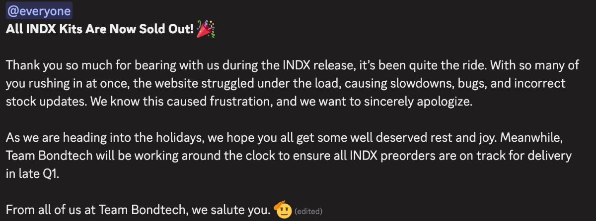

Wow!
I never before show a web site so busy!
I do not know if they already pre-sold and closed it, but I only get the info. page.
Btw they have on the GitHub a new STEP CAD file ver. 1.14.

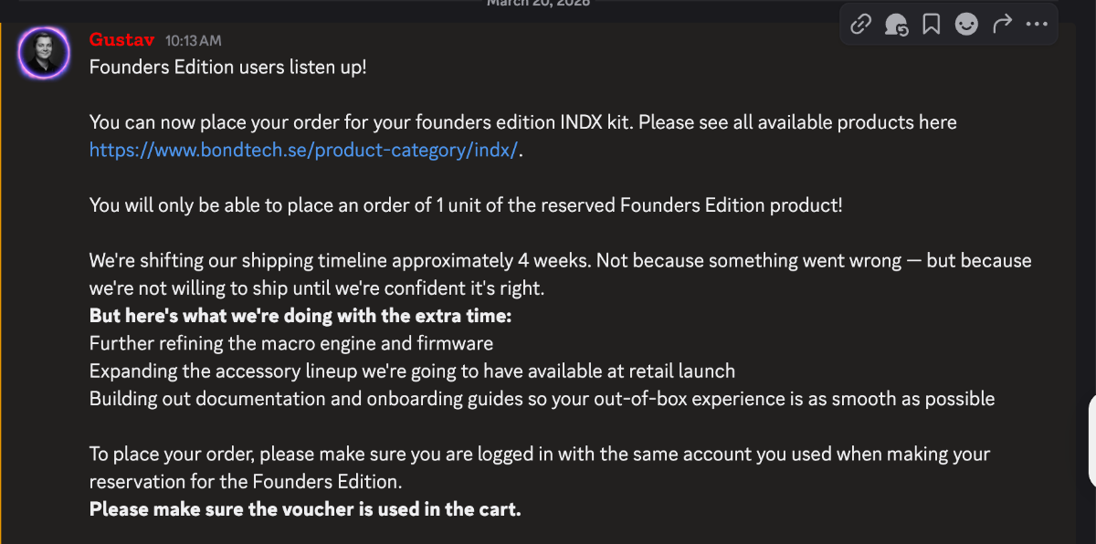

Finally, on Discord they are talking about a “Founder” code you need to pre-order?
