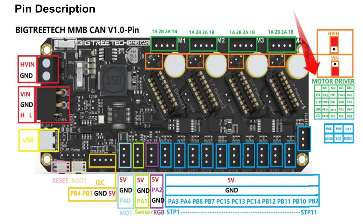

Hi guys , i'm struggling with ECRF V2 MMU . I have faulty driver M2 that makes the selector work , i want to check if the MMU can be used or fall in the recycle bin .
Since that it has 4 driver for motor how i can set mmu.cfg alias associations ?
I can choose any driver or there is some rules to follow ?
Many thanks for help
image.thumb.png.c95fedc727a70c3a1365cc51a5a09c43.pngimage.png.88ef98232c48a5600ad8c9c5bae7cebc.png

Move the selector to motor 3 if motor 4 is faulty and define as such. Easiest way is to change the pin out definitions in the MMU_SEL_XX section.
So for motor 3 it would be:
MMU_SEL_UART=PC6
MMU_SEL_STEP=PD0
MMU_SEL_DIR=PD3
MMU_SEL_ENABLE=PA15
The MMU_SELECT_DIAG, MMU_SEL_ENDSTOP, and MMU_SEL_SERVO will stay the same.
Hi mvdeveer many thanks for the tips.
I asked this for an issue on selector motor that no longer turned , seems died.
After some test as specified by you i moved motors to gate M3 and M4 without results .
I happened to be reading a post for update happy-hare files for a similar issue : i removed first current installation and again reinstalled Happy-hare .
Now all works well .-)
