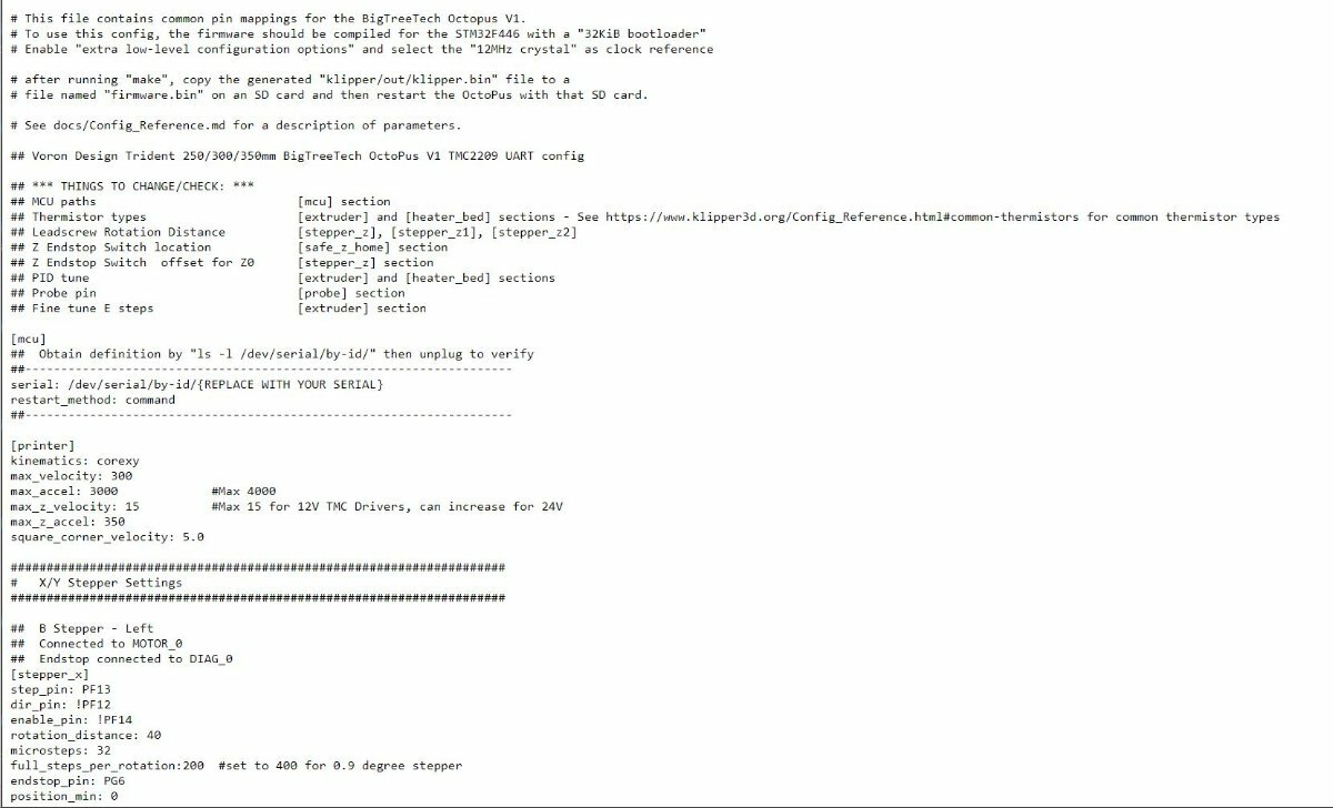

So I'm going through and trying to do as much as I can while waiting on the printed parts.... already loaded mainsail / klipper on my raspberri pi (stand alone, not connected to octopus), was able to connect via web browser and update programs just fine... however what confuses me right now and might be due to the fact that I am not connected to the octopus board is how do i download the default trident printer config? I found link to the standard printer config file but when i select it it opens in a browser. Do i just select "download" and rename, copy / paste to notepad and save? I think I tried downloading, renaming and when i open mainsail uploaded that file but it didn't appear to like that... again, might be becuase pi isn't connected to octopus.

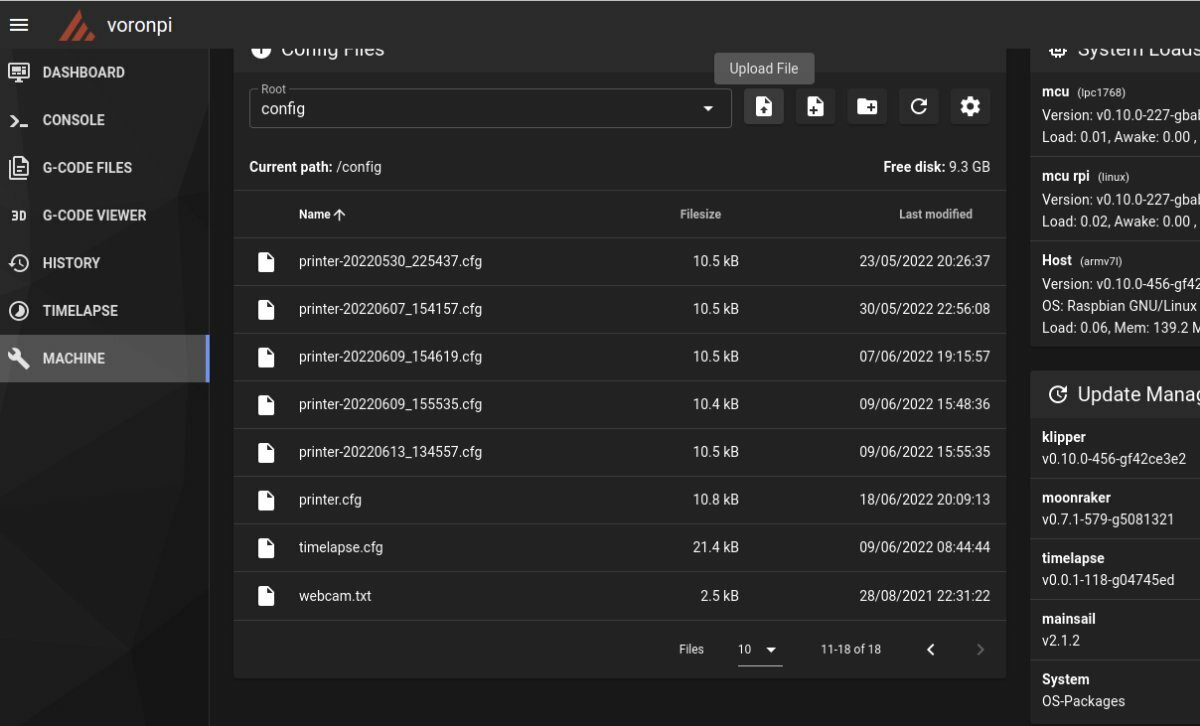

You don't need the controller board connected to the PI to upload/create the standard printer.cfg file. The worst you'll get is some grumping from mainsail/klipper about the MCU not responding. Now having said that, you will need the controller (Octopus) board connected to the PI to figure out what USB ID that Linux (on the PI) is using. You then need to plug that ID into the appropriate place ([MCU]) in the printer.cfg file. However, you can absolutely create the printer.cfg file without a valid MCU connection.
Other than that there are multiple ways of getting a printer.cfg file onto your PI. Easiest way is to uploading file existing file (like the one above) using the mainsail interface. It's in the "MACHINE" section of the mainsail site and there's a button for "upload" in the "Config" files panel.
As you also guess you could just create a file (in the mainsail screen) and then copy and paste your contents in. Hell, you can even SFTP it onto the raspberry PI host. All the config files will live in the /home/pi/klipper_config directory.
Sorry, re-read your question and realised I'd answered the wrong question. You could download the file and rename it (to printer.cfg and upload that), but to be honest a copy and paste is probably easiest. Use the mainsail interface to create an empty/new file (it's the button to the right of the "upload file" button); and call that file "printer.cfg"
