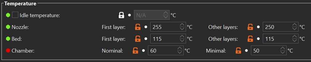

@BrentDW Most of the time I print with ASA/ABS with my 2.4r2s (300 and 350mm). I always pre-heat the chamber to ~60 deg. C before start printing. I do not have a separate thermistor for the chamber temperature; I just use the hotend thermistor. I have a macro that moves the head to the middle of the chamber (150,150,120mm for the 300), it turns on the part fan to 100%, and of course turns-off the hotend. Then after 30 minuntes or so, I read the temperature from the Mainsail page. The whole Voron OEM cabinet vent is being replaced with a blank cover, and all the plexiglass panels are airtight (as can be!) with thin weather strip foam. My printers are located in a relative cool garage, and I am running a Nevermore V5 Duo (check update at bottom of message!) Voron cabinet filter during ASA/ABS prints; it also helps with circulating the warm air in the cabinet during printing.
Also, do you use specific Heatmaps for your bed for ASA/ABS temperatures during printing? I have found out that the bed deforms even more at these temperatures, especial after 30 min. or so. My PLA and ASA/ABS heatmaps are quite different. I use standard aluminum "flat" aluminum beds and with PLA I get 0.065 when at ASA I gets up to 0.17!!! Btw from the four screws holding down the bed only one is very tight. The rest are "finger" tight to let the bed expand.

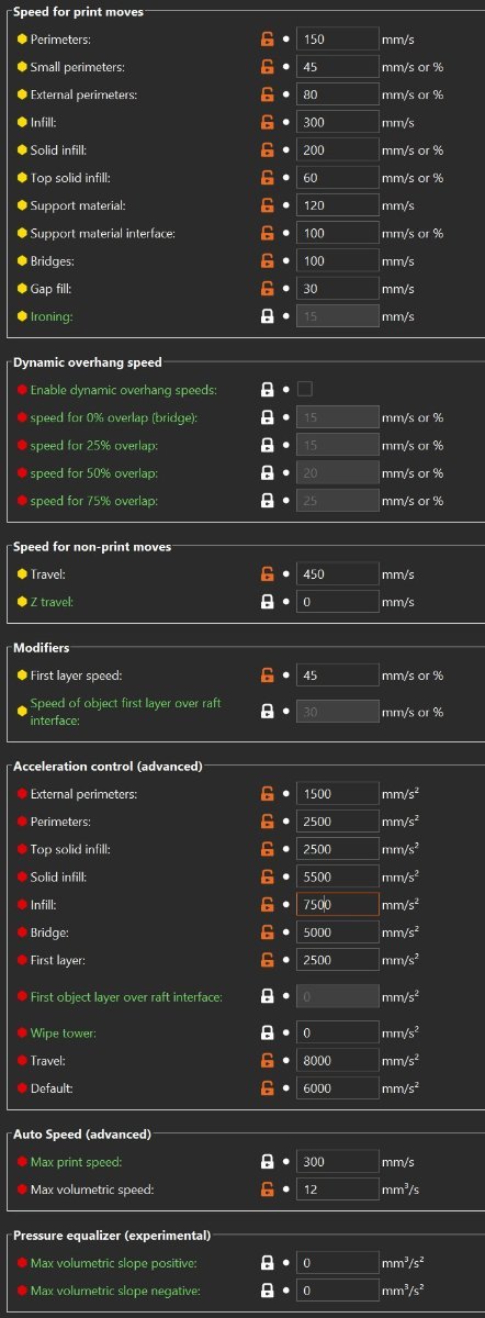

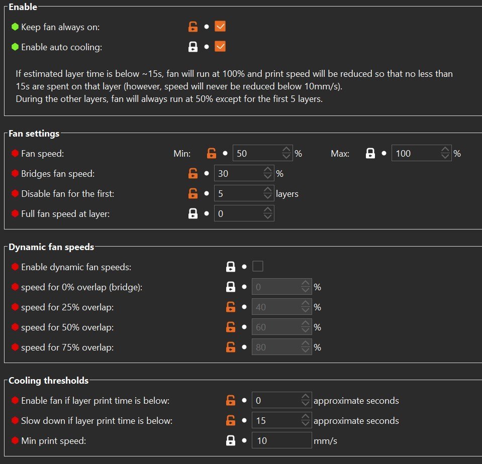

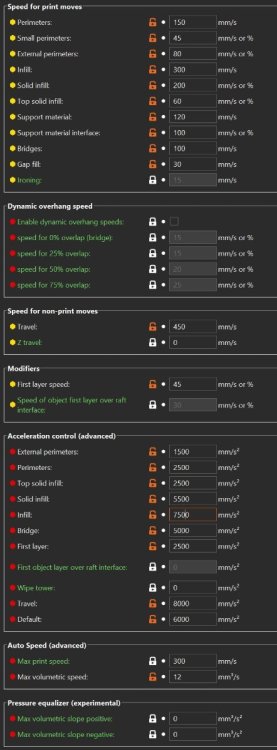

My PrusaSlicer setup below; which is based on Andrew Ellis's recommendations:
UPDATE: I just show @VoronManiac wonderful V2.4-Aire filter. A quick look convist me to give it a try and replace the Nevermore filter.

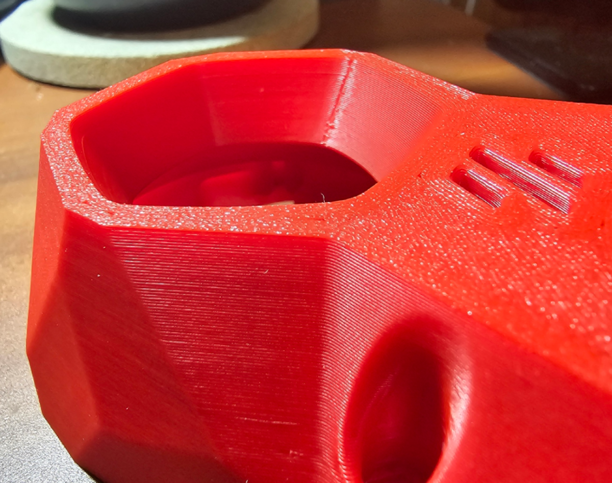

I rarely if ever use a smooth PEI sheet. Sometimes I've used those hologram and CF sheets with a pattern that get transferred to the part but... 99% of the time I'm using textured PEI.

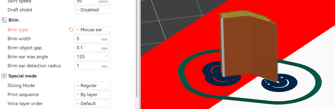

Do this... Add Mouse Ears in your slicer. I use Orca but, Super Slicer and Prusa have them as well.
And you should be good to go.

Thank you.  The mouse ear brim seems to be spot on for where I need the extra support.  Love it.  The Nano Polymer is stupid expensive...and will be here Thursday.

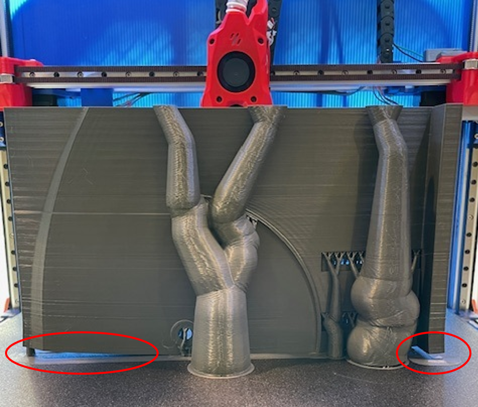

I printed this the other day... Same settings as I described, Polymaker ABS, N=240 B=110 Speed 200mm/s 10k accel on top and outside walls, 300 mm/s 10K accel print time 1hr-25m
