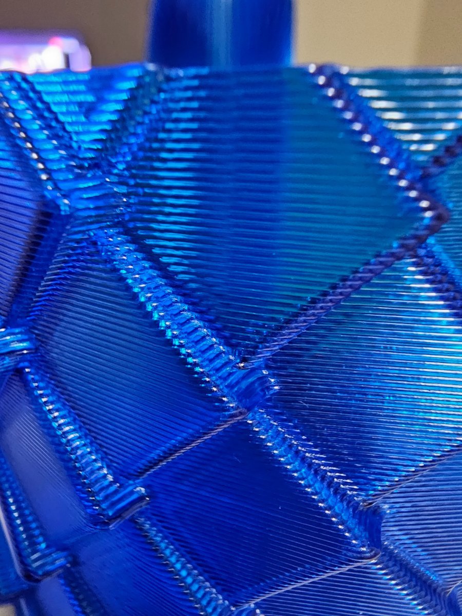

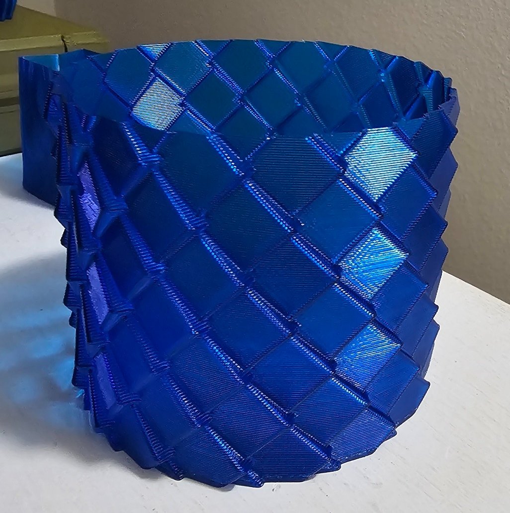

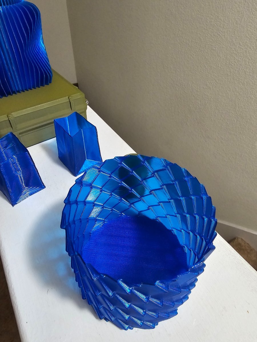

If you like the look of large filament then it can look absolutely stunning.
Plus, you need to pick a part and material color that pops.
This is transparent blue PETG with a 0.8mm nozzle and the slicer settings are 1mm wide extrusion with x .5mm thick layers.
The paper bag prints in the background are printed with a standard 0.4mm on the right and the 0.8mm on the left.PETG-1mm-02.thumb.jpg.e45b0712cce5c2a102f433ae304e3fd3.jpg
...and a close up.
