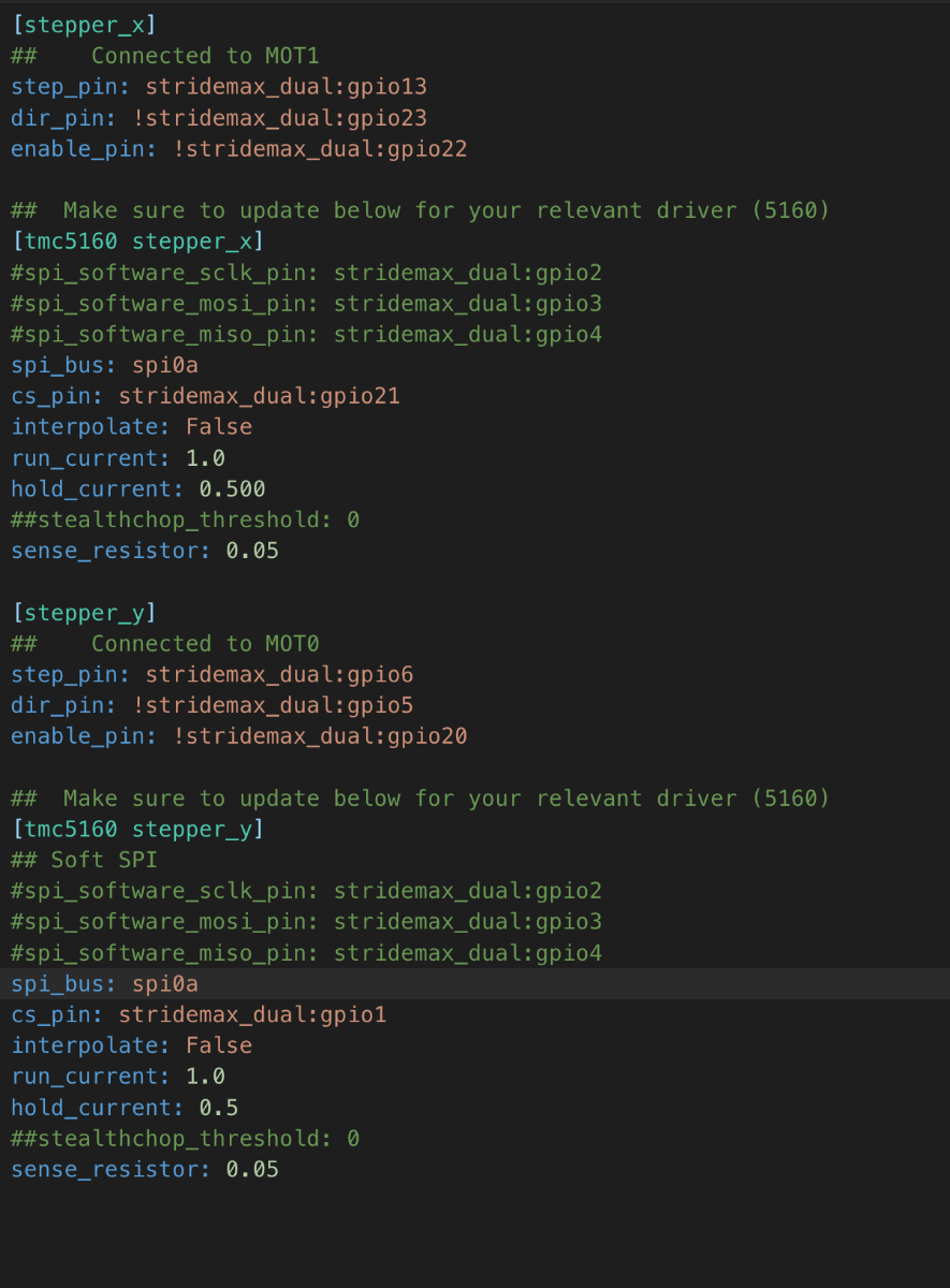

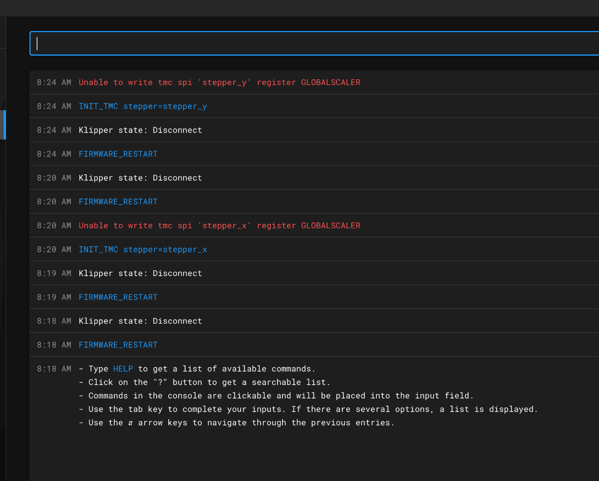

I have a couple of StrideMax Dual FD v2, but they always get an error "Unable to write TMC spi 'stepper_y' register GLOBALSCALER"
I've tried steps using information from
https://github.com/FYSETC/Stridemax_Dual_FD
https://github.com/emebecnc/3DPrintingTutorials/tree/main/StrideMax Dual FD v2 USB %26 CanBUS Mode
The issues in the first link mention SPI pin issues from the non-released units; the change was made to allow hardware SPI for RRP firmware.
I've cut and pasted the examples, re-typed them, swapped SPI pins, and tried hardware SPI. The example image has hardware spi configured.
Does anyone have experience with these units and know what I should try next?

Make sure that you have all the power supplies to the board. I had the same issue with my VzBot. I had wired the 48v to the the TMC5160s, but I had not wired the High driver power on the board (not the same board as yours).
