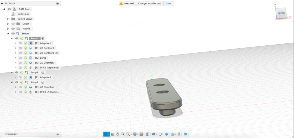

Glad to hear you got the machine working. I'm using Fusion 360 free version, but the drawback is that the tool changes require generating gcode for every tool change. In this example, there are 5 tool changes.

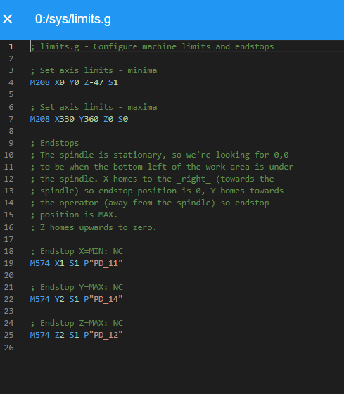

Okay so I am trying to fine tune my settings..
My official work area on my cnc are:  X 335  Y 365
I adjusted LIMITS.G and put those.. but Y is showing 400 still..

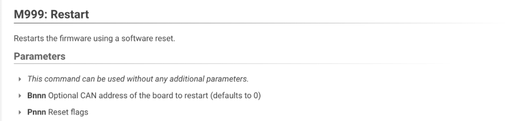

Did you do m999 (firmware reset) to see those changes? Again, any changes you make to a G file should be made in user-config.g, so if you update the RRF the changes won't get overwritten.
Edited by PFarm

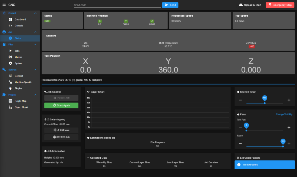

Hey buddy, I could really use your help with your CAM setup...  Since we have similar setup, would be easier.  I am thinking I need to do something with my config files/cam setup.  Really could use your help on this..
Okay so I have done a couple tests... fixed an issue there and here.. but right now I am using EASEL just because its fast..
I noticed though because my Y endstops at the front, my XY intersect at 0 and 365.  Instead of 0,0.  So as a result my projects come out inverted.  Is there a way to fix that?  so when the Y endstops it is at 0.  and when it moves backwards, it is positive increments intsead of negative?
