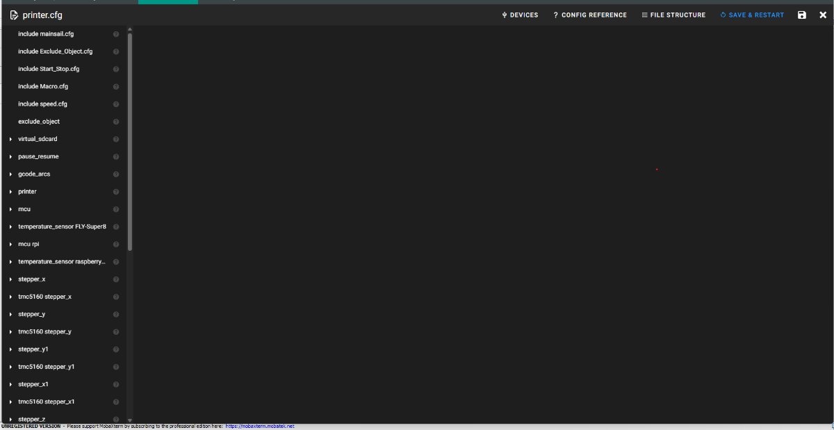

How do I get back to the details, the only way I can edit the file is via  SSH.
This has happened to me on a few occasions. Restart mainsail and it should be back to normal again.  Another option is to uninstall mainsail in KIAUH and then re-install if the first doesn't work.
