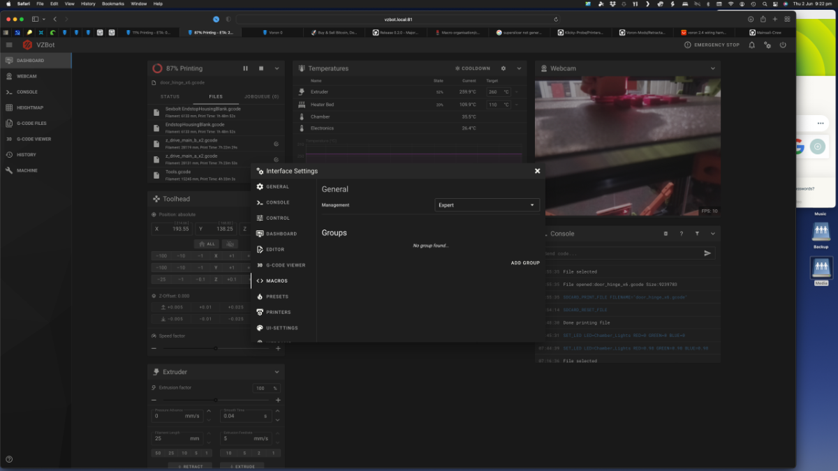

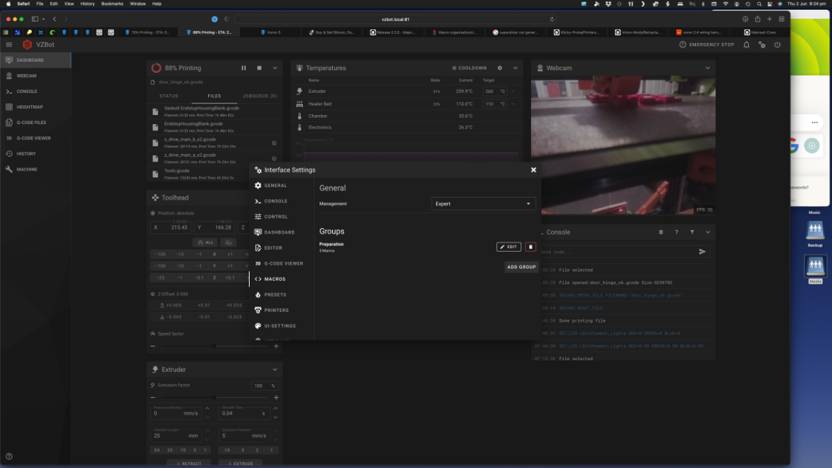

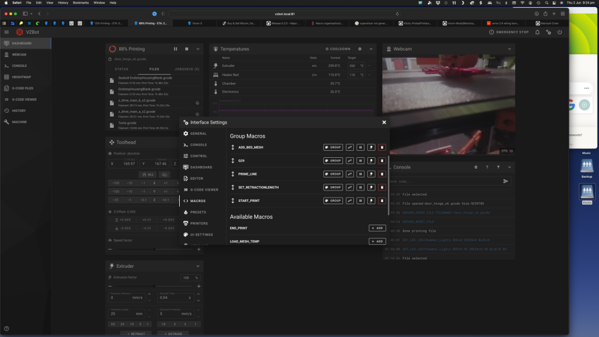

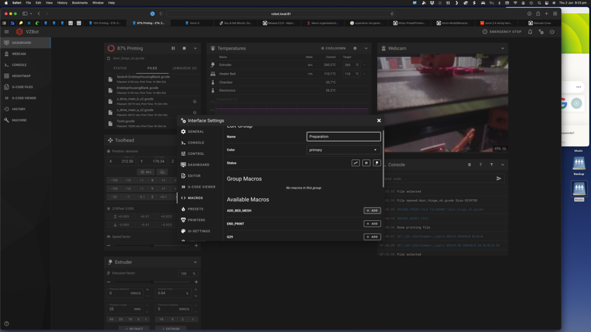

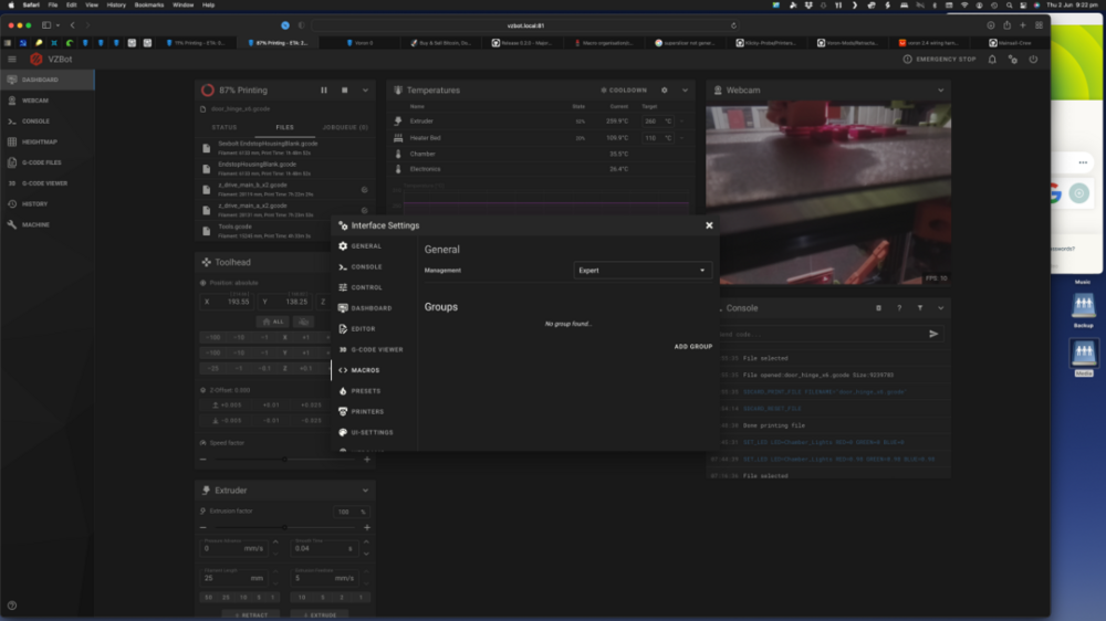

As far as I am aware you create groups in mainsail. In top right hand corner - click gear icon, choose expert mode and create the groups. Allocate the macro to the group you want. Close the group and create the second. Hope this helps
