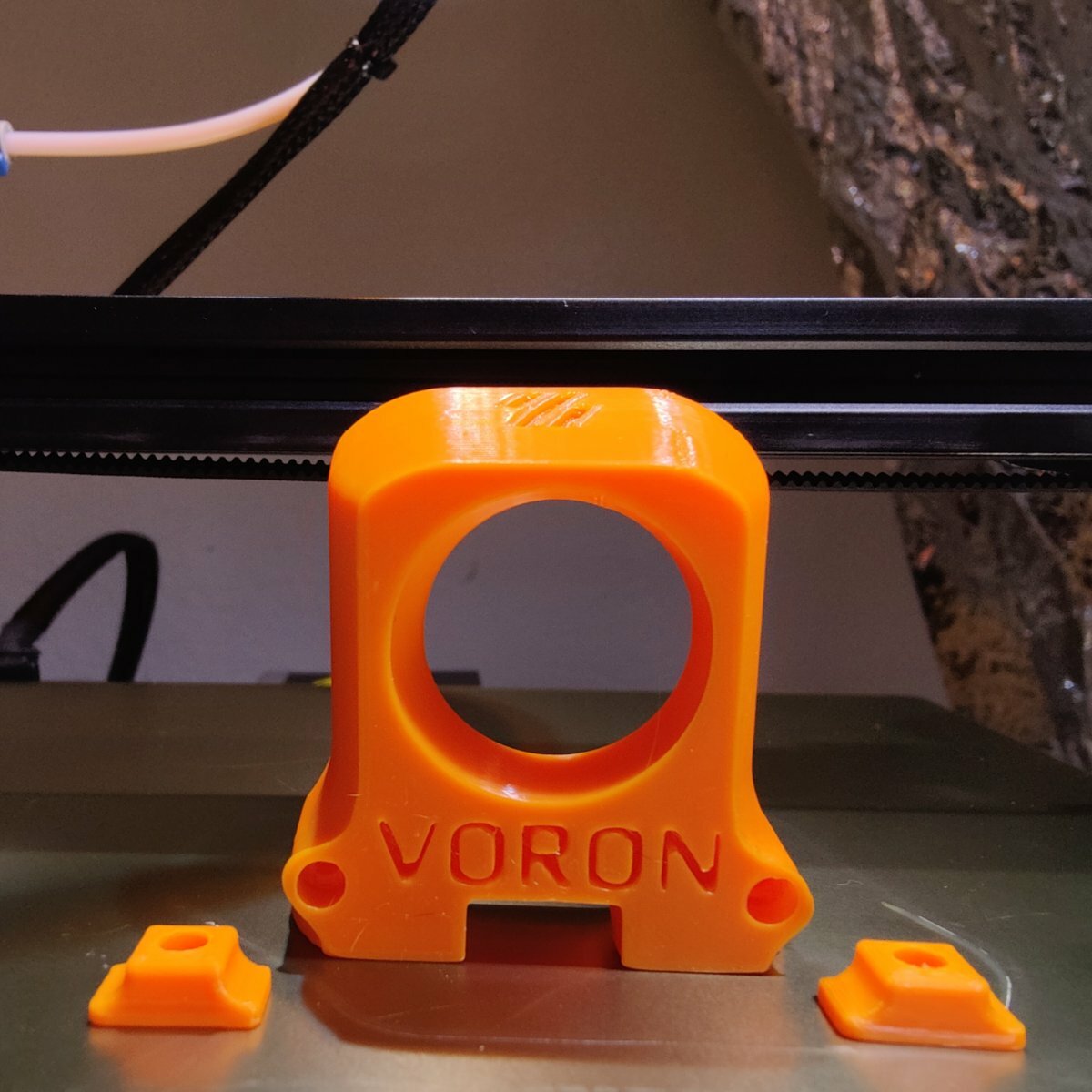

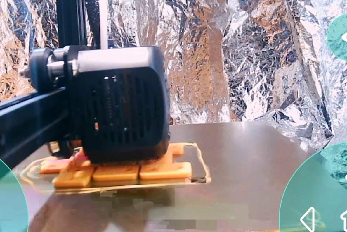

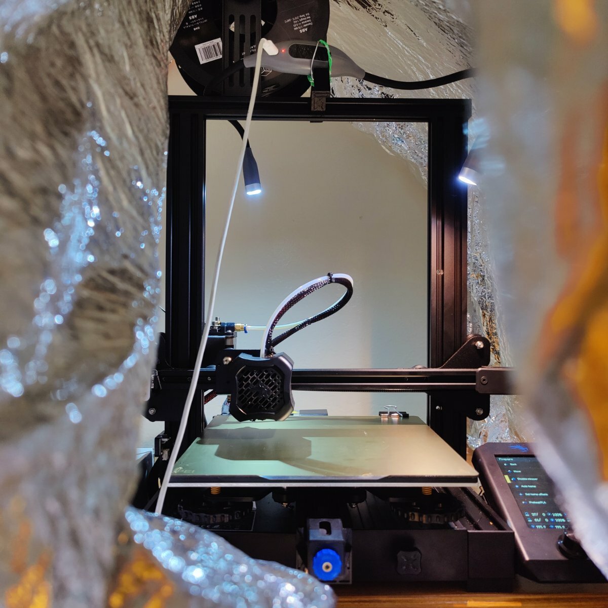

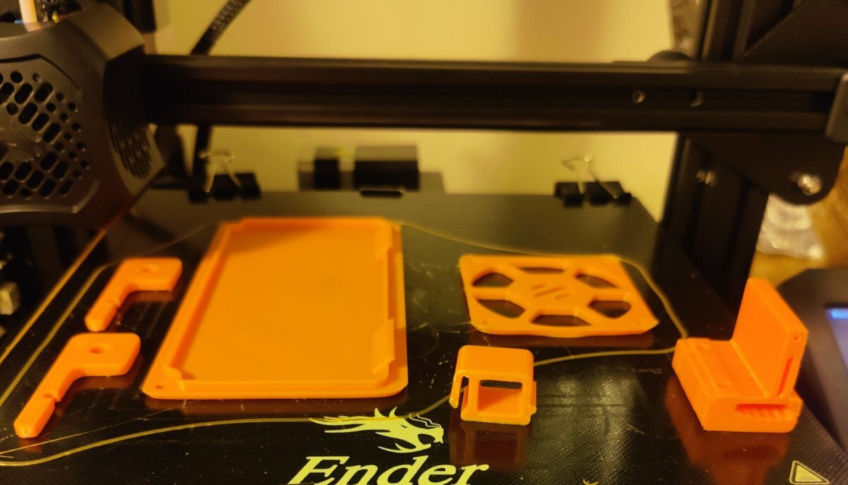

If you would like to print your own parts for a Voron, but do not have an enclosure, I have had success using an emergency Mylar blanket. If you don't have any laying around they are only a couple dollars. One is big enough for an Ender 3 or CR-10 size area. They are very sturdy for how pliable they are, and can hold shape with minimal support or even folded on themselves properly. Additionally they are highly reflective, and will light up well if you use LED's inside. I have found a simple domed tent works well. I keep a small opening on one side (rear) up high, with a lower opening on the opposite side, which I use to view and adjust to control the temperature.
Yep, I did the same on my Sidewinder X1. Except I used a large plastic bag. I tucked it under the bed so the electronics in the case underneath could still breath some fresh air though.
Works extremely well. Makes you really wonder why people spend extra on thick insulation panels for their Voron. As long as there's no draft creating a temp difference around the parts normal (cheaper) panels should be fine.
