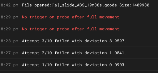

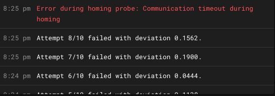

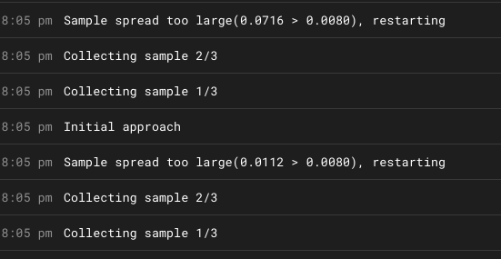

Since upgrading to cartographer touch and the latest firmware, I just cannot complete a print.
Followed the instructions in the documentation to the letter, but getting persistant errors on all 4 of the machines.
The first print generally progresses, but ANY subsequent print fails
Verry, very frustrating:

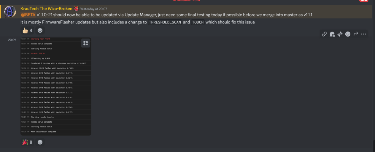

The latest announcement from Cartographer. Seems an update will be pushed soon for those affected. (Exactly the issue I have been having)
Currently in Beta Testing. Will be merged too v1.1.1 through update manager

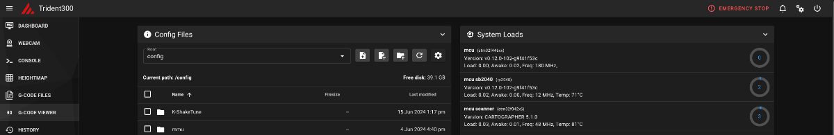

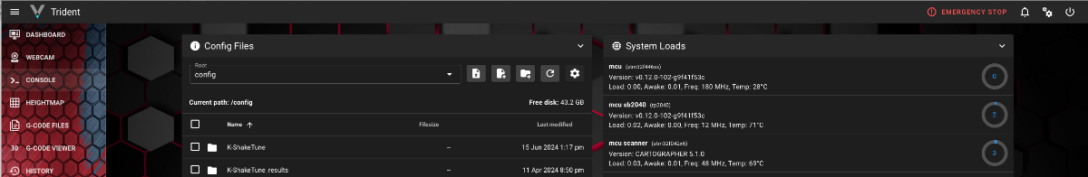

Trident 250:
Trident 300

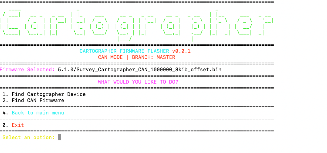

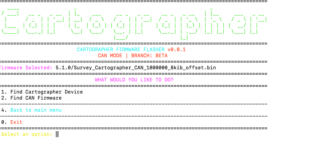

@mvdveer don't suppose you wanna try 5.1.1 and see if it continues? 🤔 All testers so far it's stopped for but if yours seems consistent it'd be a good test.

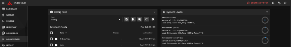

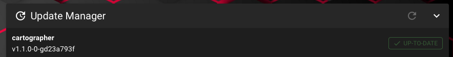

Just ran an update - latest firmware was 5.1.0
and cartographer v1.0.0
Problem still persists.
Will check again later tonight and see if 5.1.1 is available. Not that keen switching to the Beta branch.
However Beta Branch shows same firmware:

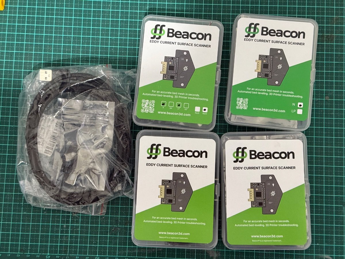

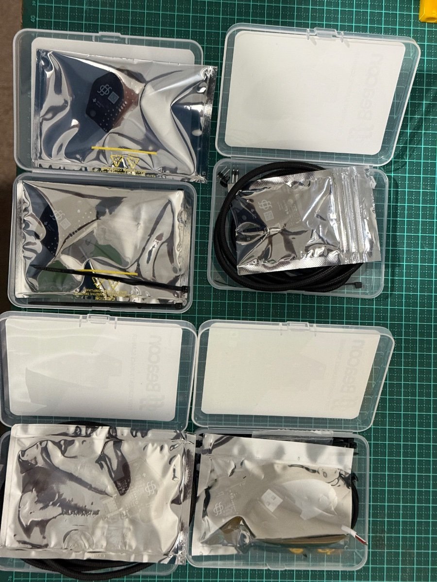

HELLO BEACON
All four the machines with cartographers are now fitted with Beacon probes. I bought the 3 x H Versions in June this year, but how easy was it to install and setup. During the install process with the following commands,
cd ~
git clone https://github.com/beacon3d/beacon_klipper.git
./beacon_klipper/install.sh
it did not only install the Klipper plugin but automatically updated all the probes to the latest firmware. Talk about a hassle free installation.
Unfortunately I only had 3 x H probes, which the V2.4 300; V2.4 350 and Trident 300 got. The Trident 250 got an Revision D probe (just doesn't have the accelerometer).
All machines calibrated and BACK in bussiness!
