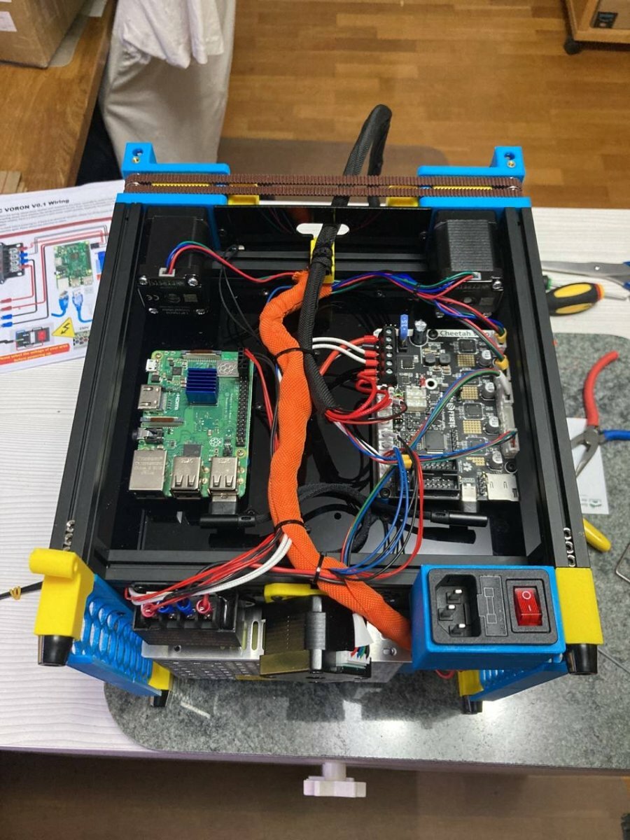

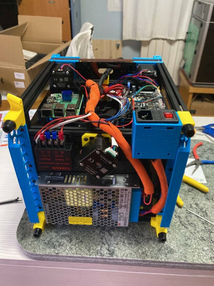

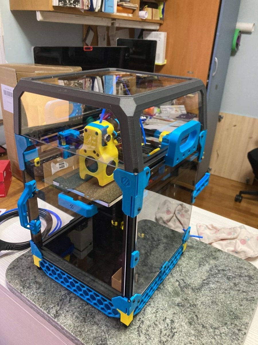

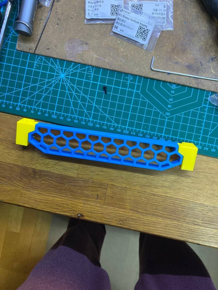

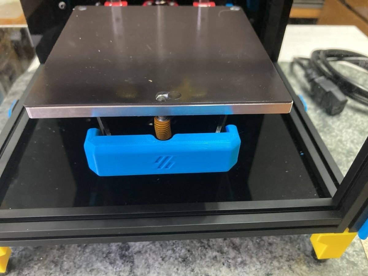

Fysetc kit, official stls.
Kirigame bed from scratch

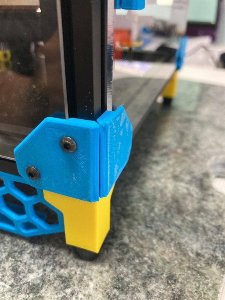

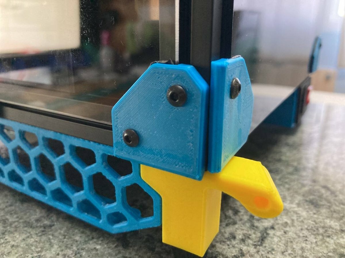

Top Hat unibody,  handles and a little mistake solve in a quick clever way.

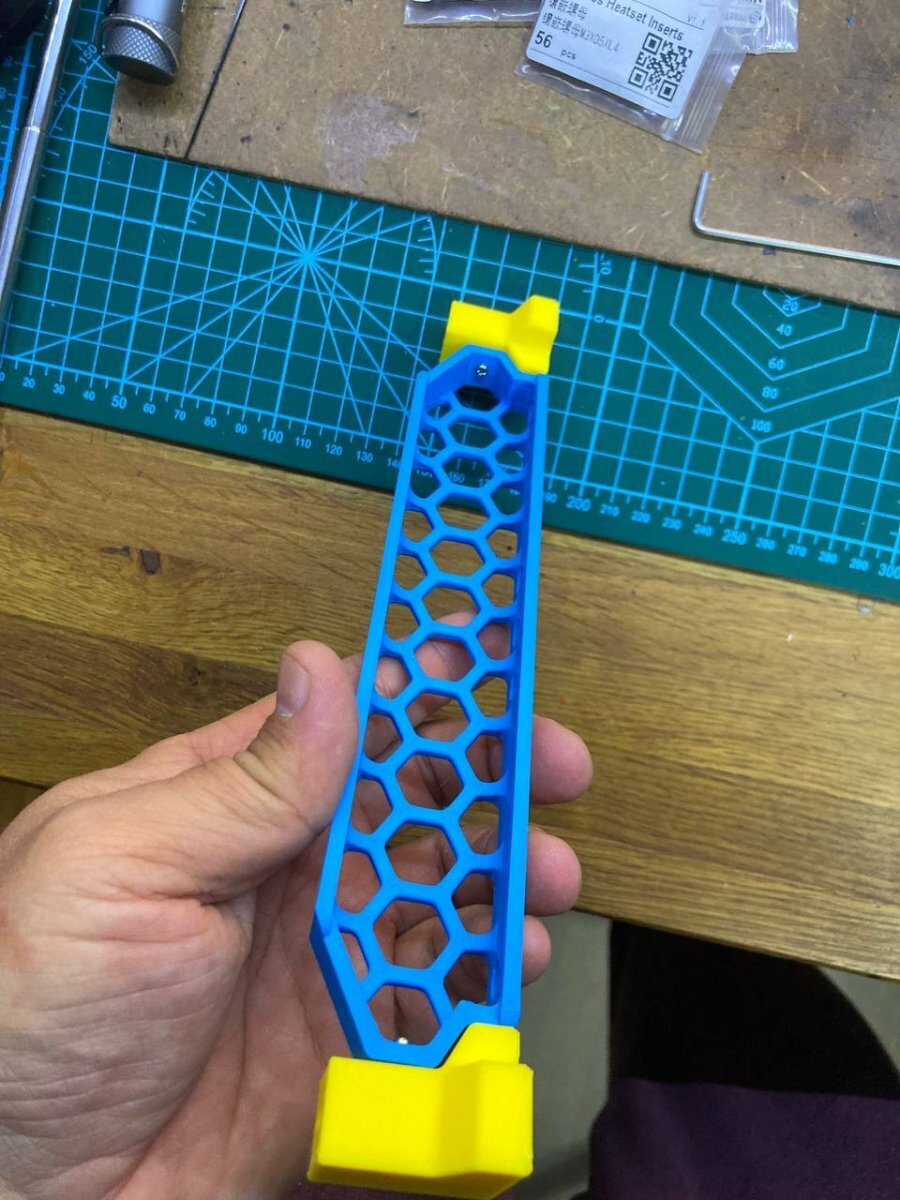

Forgot to insert 3 nuts in front bottom rail for the front skirt, so I only had one nut, solved printing a unibody moddified skirt and selftapping it to both feet and the only one top nut avaliblable.
I´ll drop you pictures not sorted by date.
