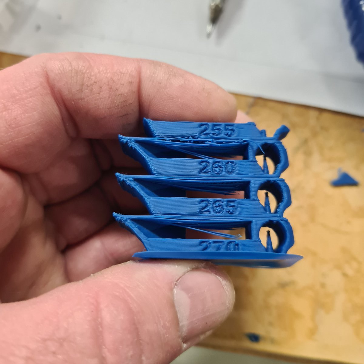

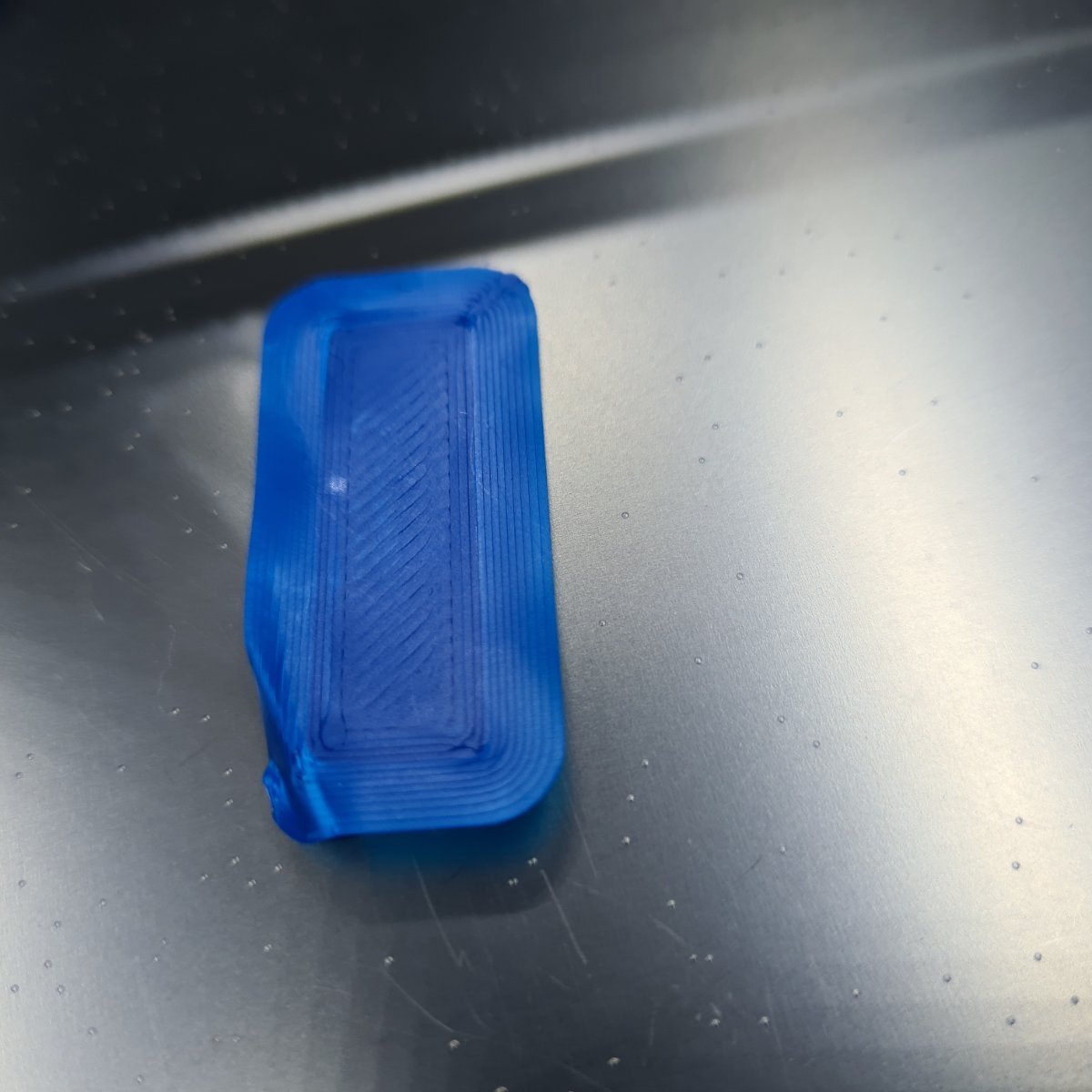

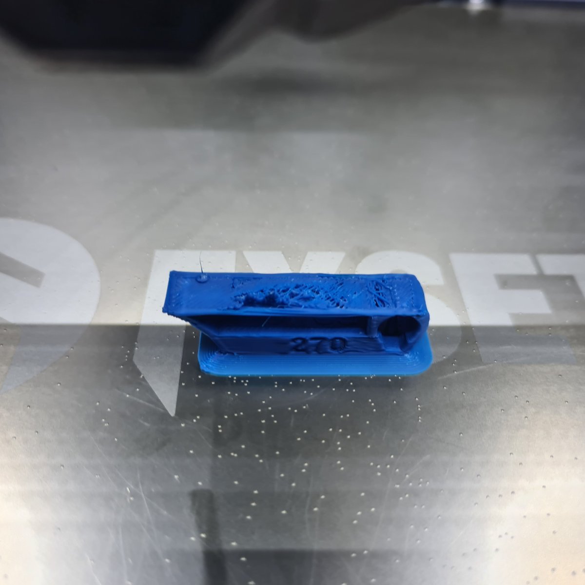

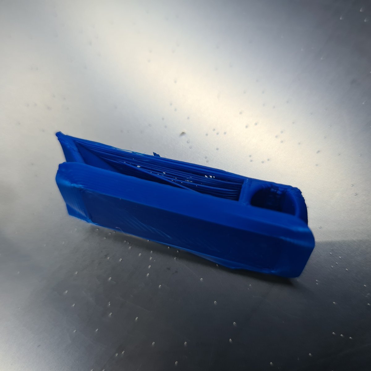

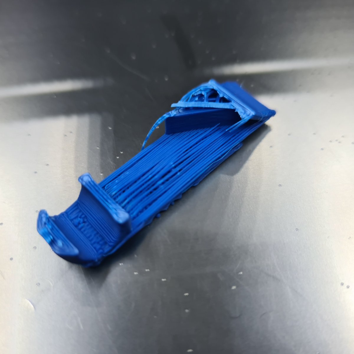

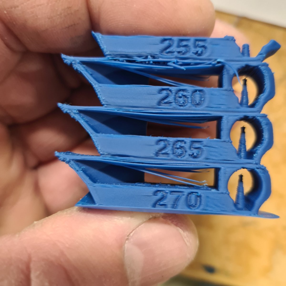

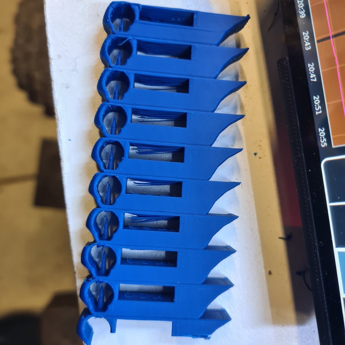

Having trouble with my abs printing bad with the temp tower from orca bed temp is 105 starting temp is 270 parts fans at 30 percent trying some with less fans tried more and no fans and still getting trouble the problem is on the bridge of the temp tower prints arr sticking well to the print bed hoping some one might be able to shed a little bit of light as to what might be the problem I broke the prints to help u all see the problem
270 is way too hot for regular printing. Printing bridges is a balance between speed and cooling, too hot and the line of filament cannot be cooled fast enough to prevent sagging.

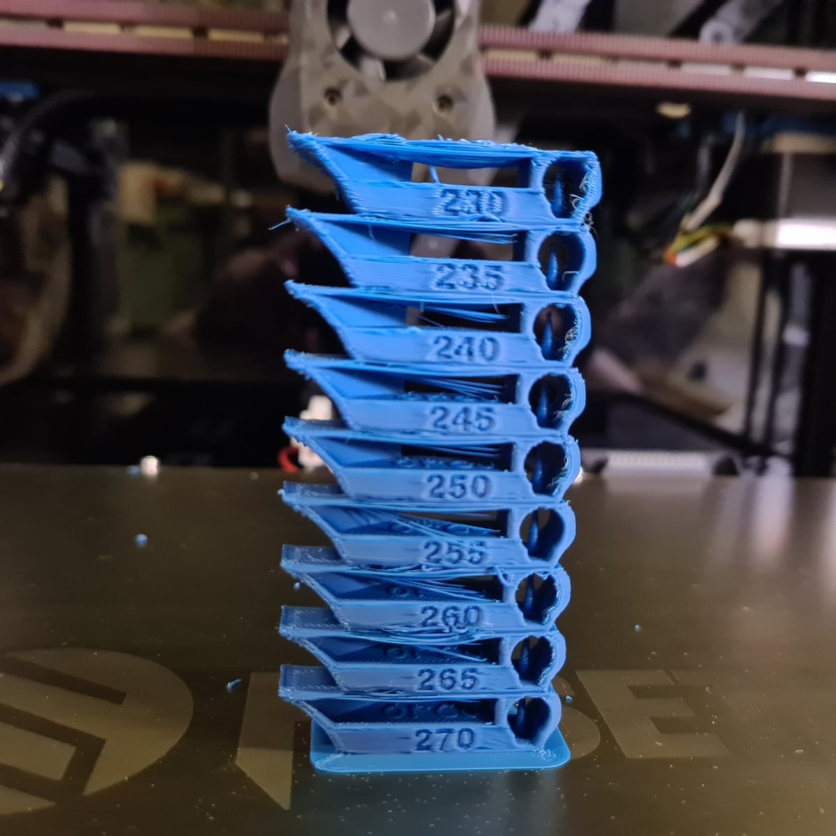

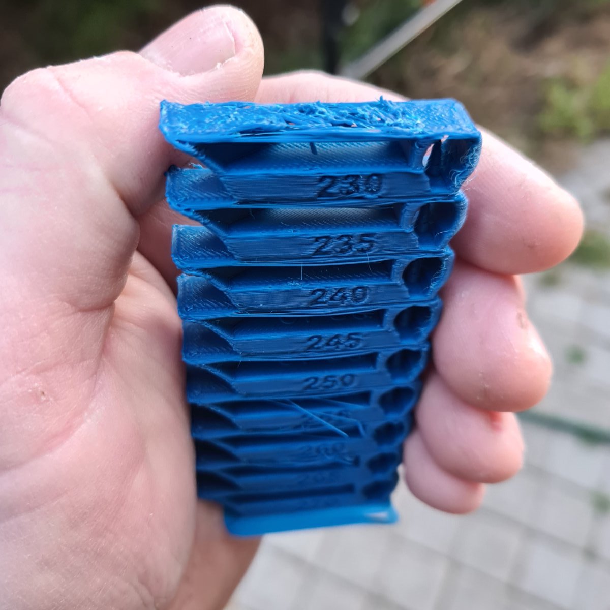

I would recommend printing a full temp tower from 270c to 230c then, inspect the print to determine what temp gives you the best bridges. You probably also want to print multiple test towers with different fan speeds. There are 3 fan speed settings that you want to dial in. 1, fan off for the first X layers. 2, nominal fan speed throughout the entire print. 3, overhang & bridging fan speed.
The image below is for PLA but you get the idea.

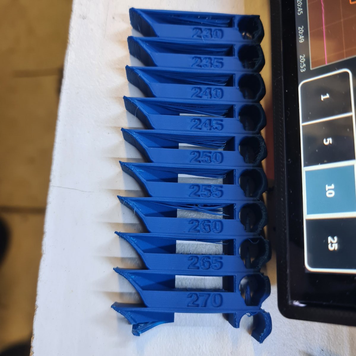

This is what I am going ro run this time with the temp tower like u said or should I change one of them
Edited by sleepster217
Don't know why you insist on stopping the print before you get to a reasonable temperature but OK...
Your baseline numbers to print ABS effectively would be 260 max 240 min with 30% fan all the time boosting to 80% for bridges and overhangs.
I would redo the temp tower with a range of 260 to 230 😎👍

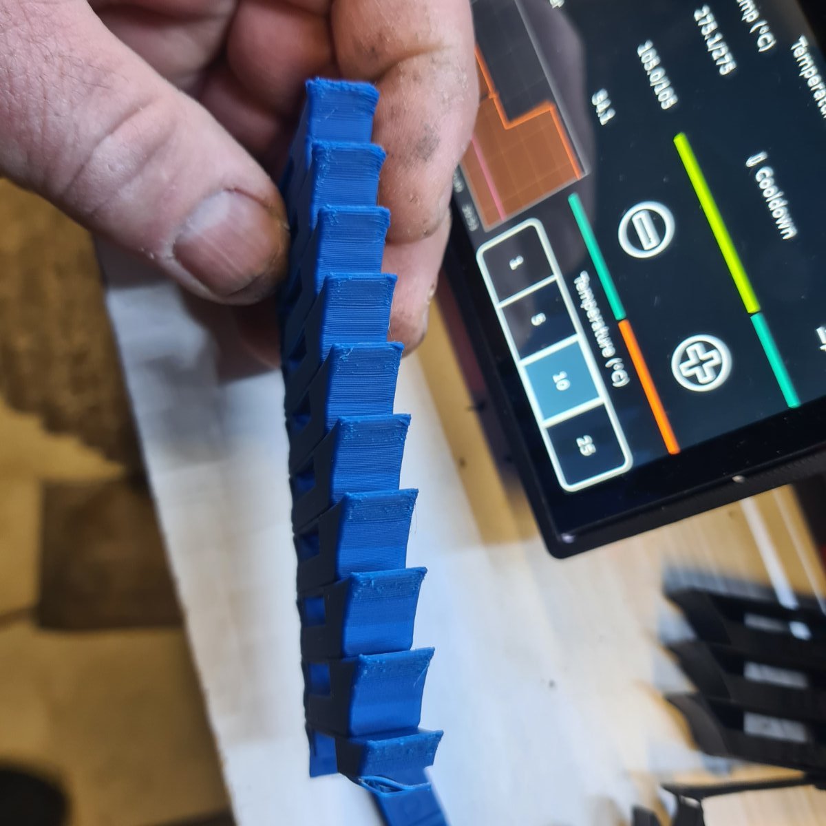

Something really screwy is going on with your top layers. Plus you're getting blobs on corners, etc. that you shouldn't be getting.
I had a similar issue come up when I recently upgrade my RatRig to a Rapido 2 UHF hotend. I thought I had a 0.4mm nozzle installed and I had my slicer setup for a 0.4 nozzle as well and when I checked, I found two things...
1, My nozzle was loose
2, I had a 0.6mm nozzle installed
So, I swapped out the nozzle for a 0.4mm and made sure it was at 240c and tightened it to spec with my handy printed torque driver.
Then everything magically fell into place and it started printing beautifully.
Perhaps double checking the nozzle size and tightness might be that dumb thing you overlooked.
Fingers crossed. 🤞

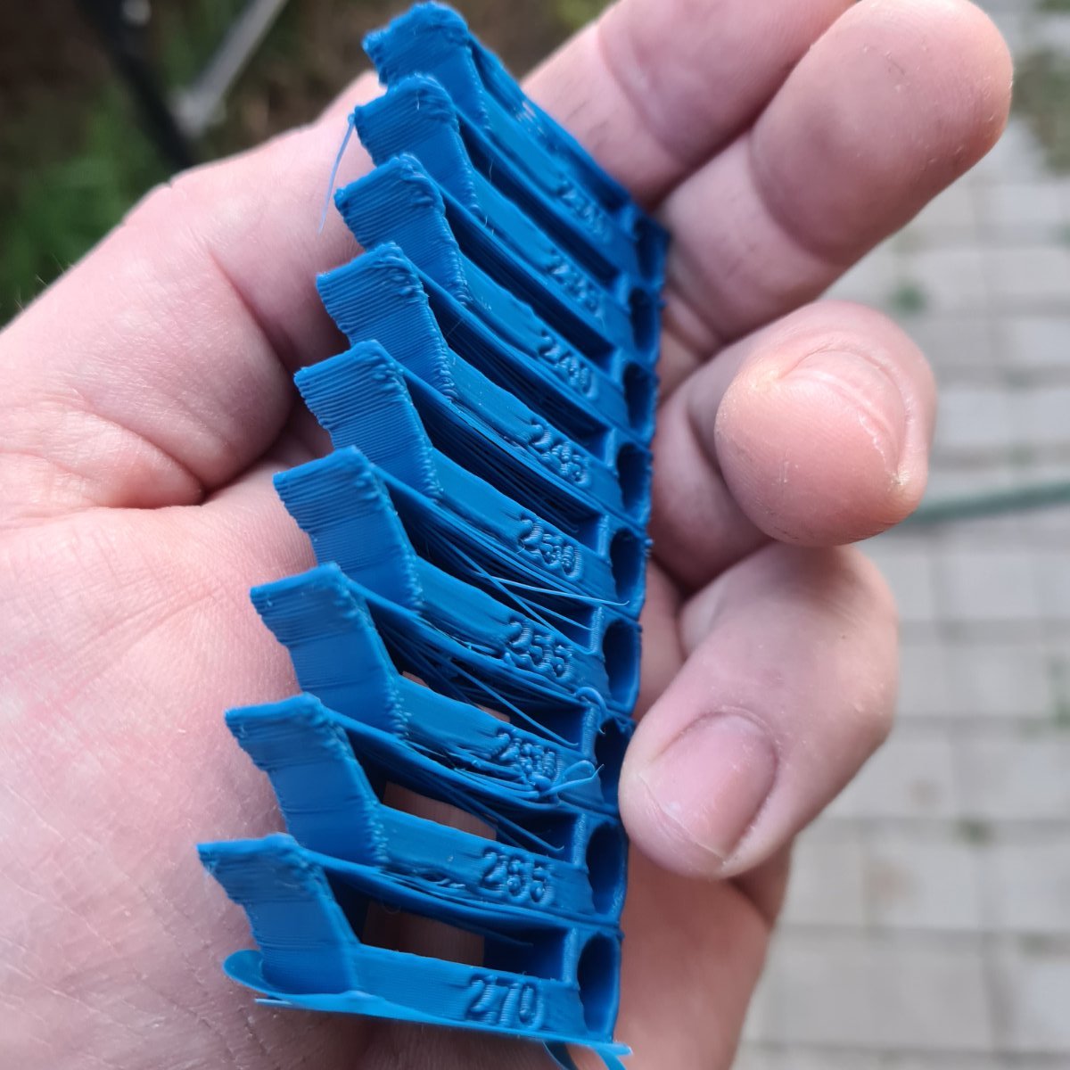

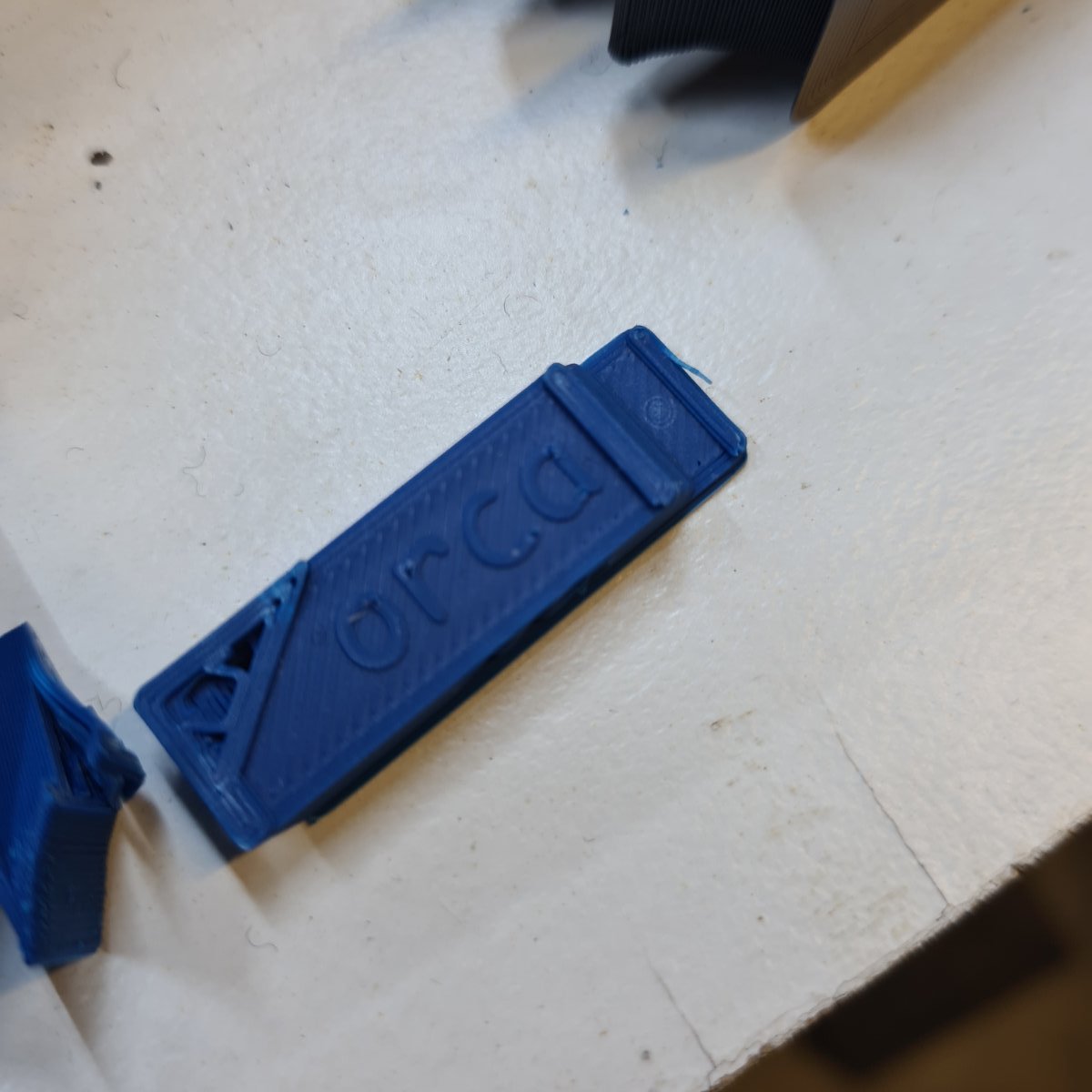

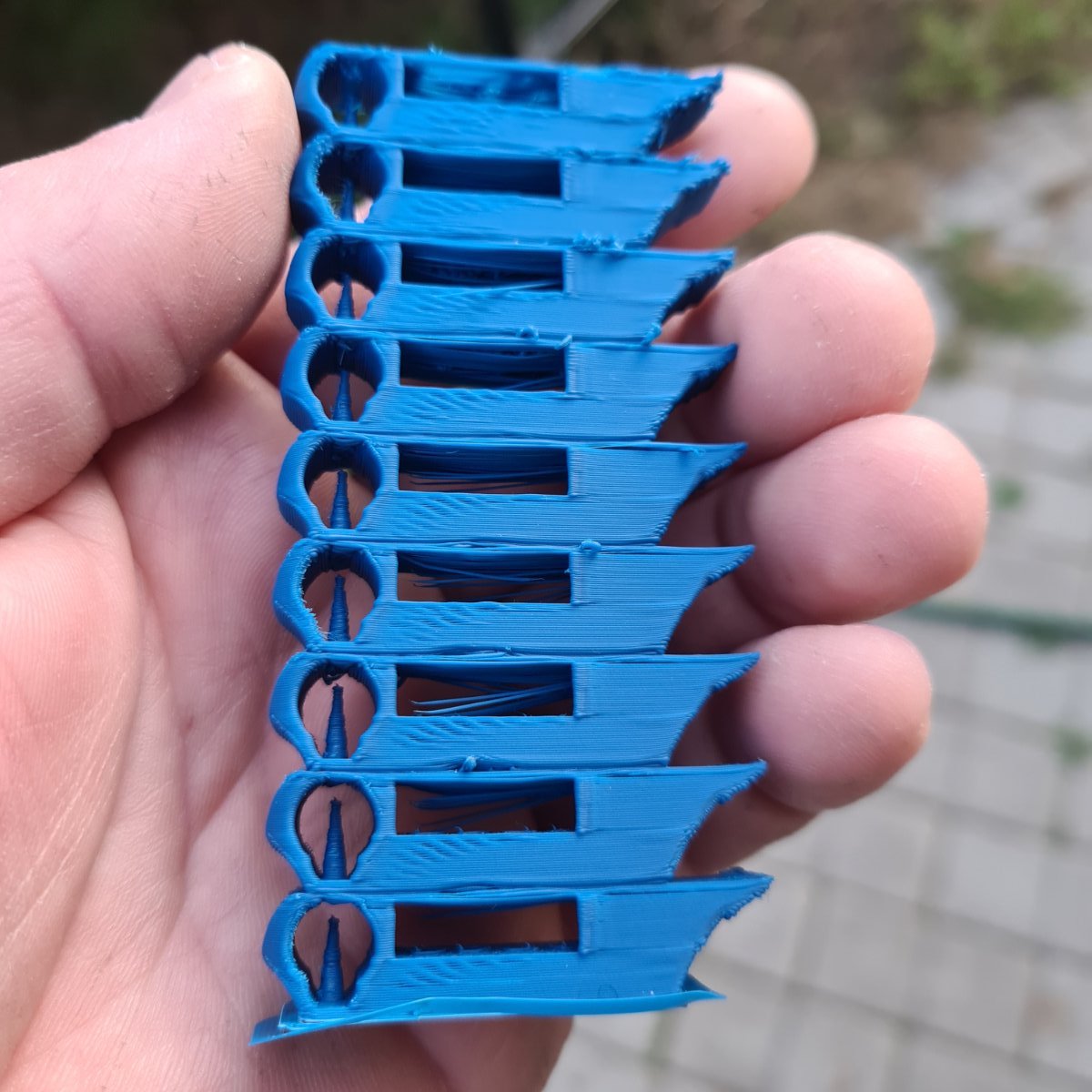

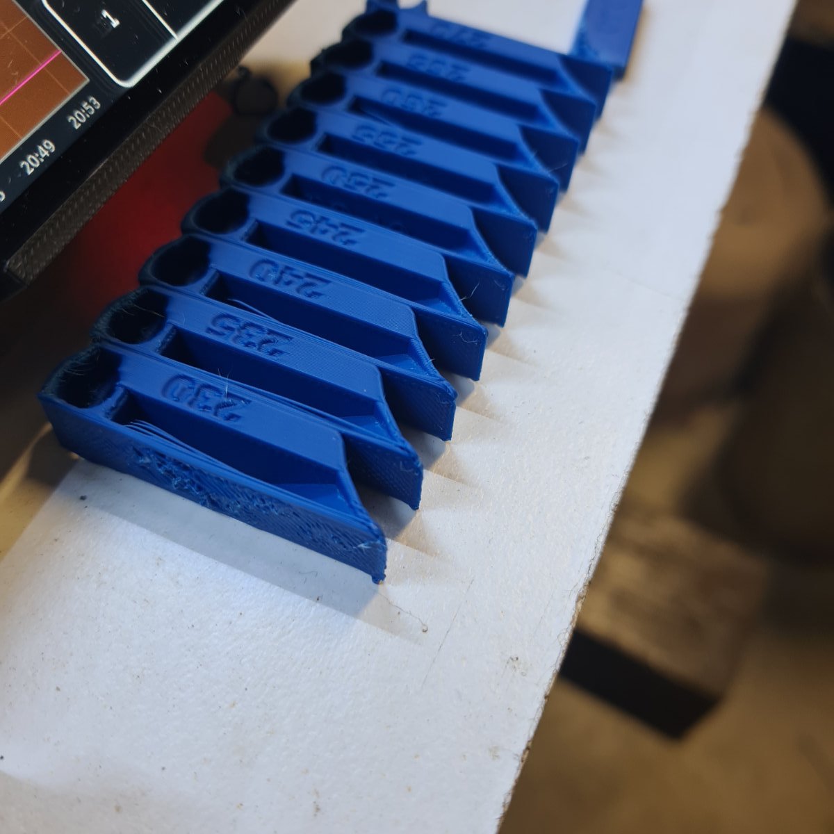

So went back to pla last night as my partner wanted some stuff for her kids and well it printed fine once I got the abs out of the print head seems I don't always get it all out when I change over and it blocks up no full.block just enough that the extruder clicks and flattens the fillament but heat hot end up pull fillament and cut end off and re insert and hold extruder out of the way and push more through by hand and we are off and racing but it seemed to print fine as.in if nozzel was wrong would print like crap or os pla that forgiving
Looking much better!
Looks like 240-245 is a good number.
You might need to slow down bridging

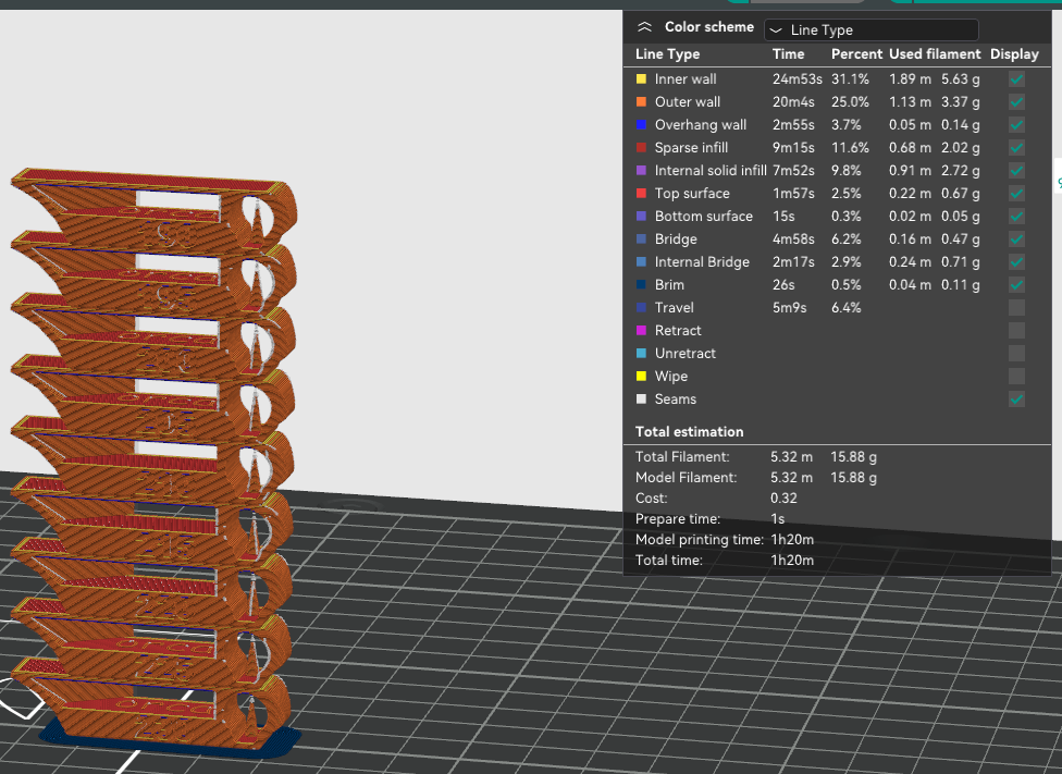

As for switching filaments... you'll need to purge a couple hundred millimeters to clear the heatblock. If you're switching from ABS to PLA... purge at 250c until all the ABS is gone. Obviously, you will print with the PLA at a lower temp, but you need a higher temp to purge out the old ABS.

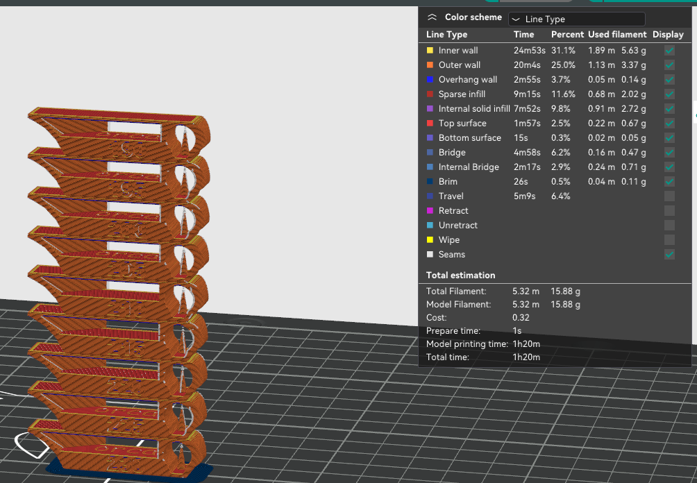

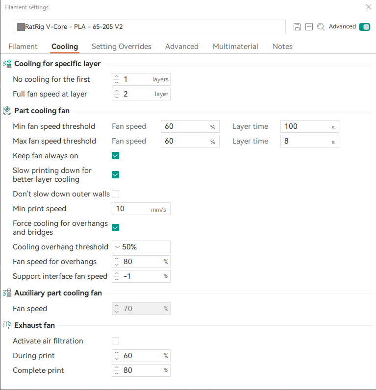

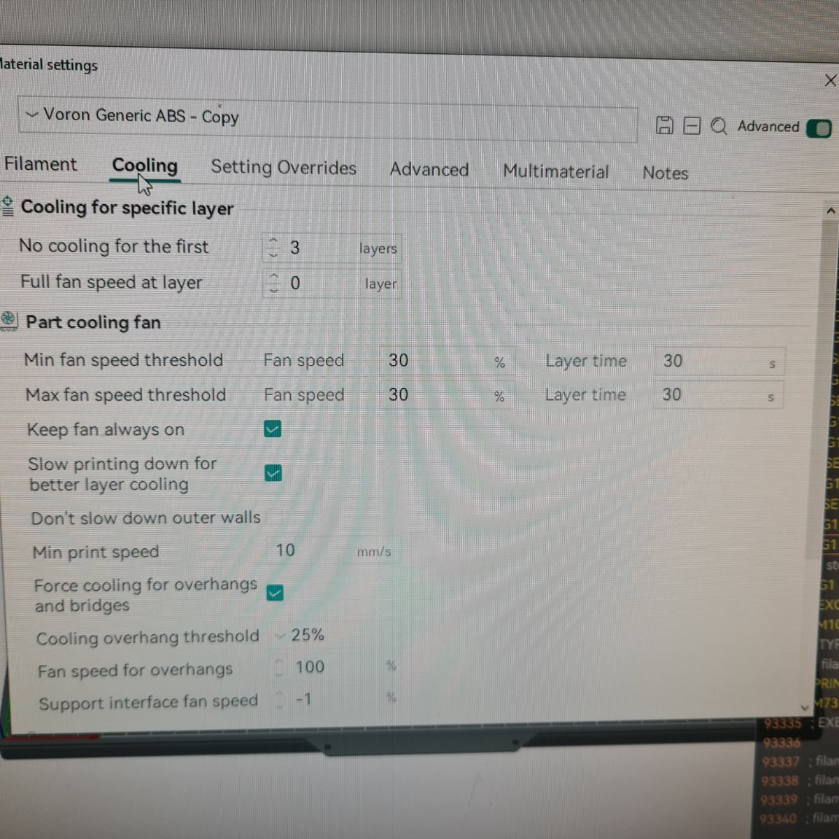

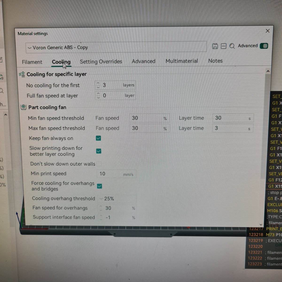

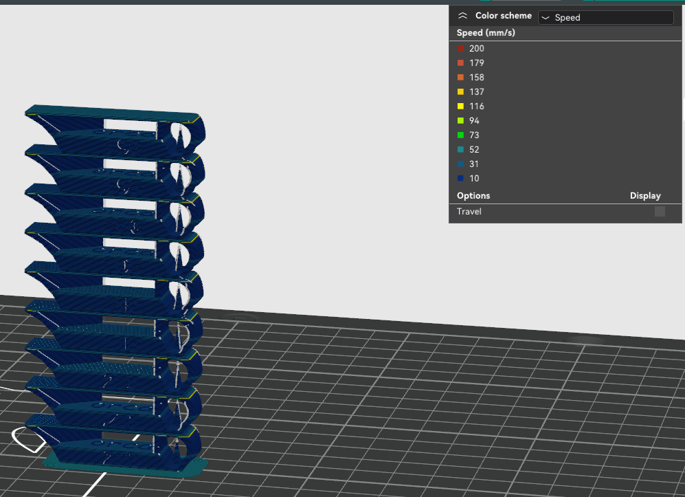

Maybe set "Full fan speed at layer" to 4. That will slowly ramp up the fan but other than that... give it a try and see.

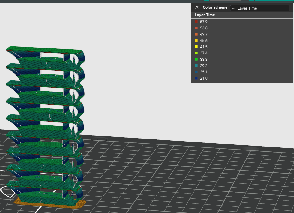

On the Max and Min fan speed threshold... I would set Max to something like 8 and Min to like 100. The reason why is that setting the max to 30 means that the print speed will literally slow down any layer that takes 30 seconds or less to print.

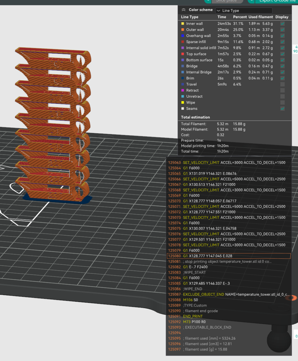

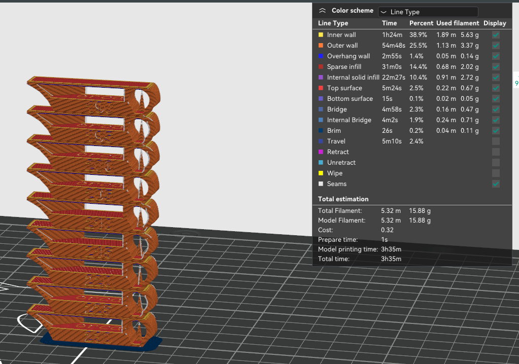

Below is a temp tower with your settings... It will take over 3 and a half hours to print.
And if we look at the print speed, pretty much everything is being printed at a blazing 10mm/s
And if we look at the layer time... we find that every layer takes at least 30 seconds to print.

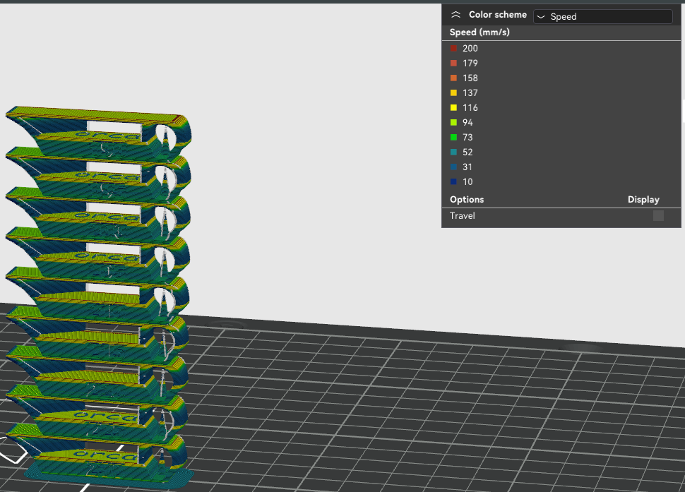

Now we'll adjust the min/max to 100 and 8 respectively.
Big changes from the 30/30 settings. Average speed is in the 80mm/s range with slowdowns happening where they should for bridges and overhangs.
and just look at the time... 1hr20m. Huge difference, literally 300% speed improvement.
So, spend the time to get to know the preview settings window on the right and explore the various "Color schemes". There is an incredible amount of valuable data that you can reap the benefits of and also save yourself a ton of failed prints and wasted time.
