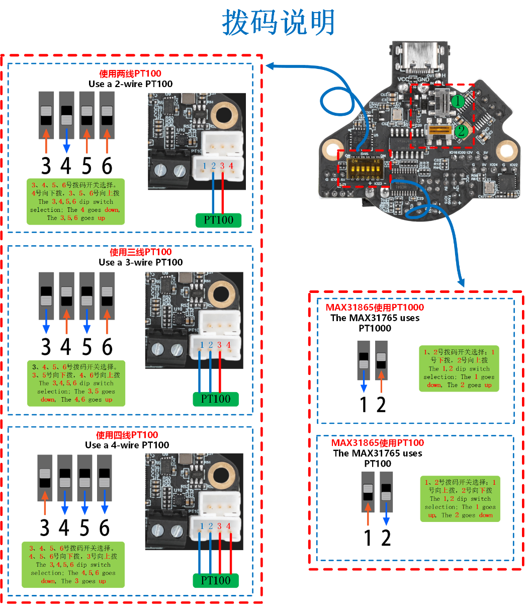

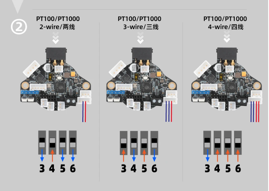

The way I read it is
For PT1000, 2 wire:
SW1- down, SW2-up, SW3-up, SW4-down, SW5-up, SW6-up
For PT100, 2 wire
Sw1-up, SW2-down, SW3-down, SW4-up, SW5-down, SW6-down
But, then I may be completely off the mark, and I can see the dilemma in the reversal of the switch positions between the two switches.
