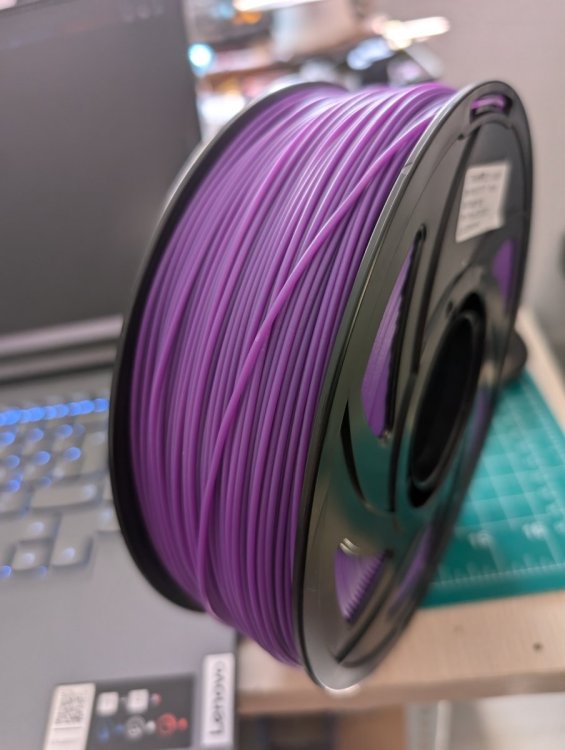

I picked up a spool of Euroharry HIPS in shocking purple from Amazon for a whopping 15 of our yoyos.
I think it's just the colour for the accent parts of the monolithic panels.

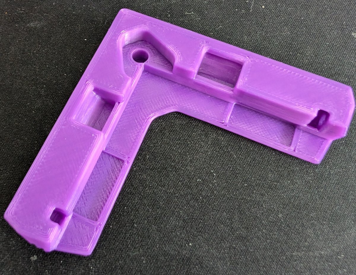

I'm just starting the Orca calibration tests.
17 hours ago, 5twenty said:
Those walls look underextruded, with the gaps I'm seeing. Maybe it's my screen?
Do you think so?
I'll raise it 10% and reprint them.
I do have a tendency to be a bit lean on the flow rate.

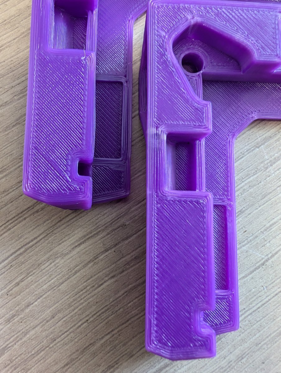

Okay, I raised the flow ration from 0.75 to 0.9 and reprinted it.
PXL_20240830_123711744.RAW-01_MP.COVER.thumb.jpg.ea4f2f18977adc739aab602a5180814a.jpg
The left hand one is the reprint with the higher flow ration, you can just see some signs of over extrusion on the surfaces aways from the walls.
The walls could do with a bit of tweaking, you can still clearly see, and feel, the individual lines. Do I increase the line width (it's at 0.42)?
