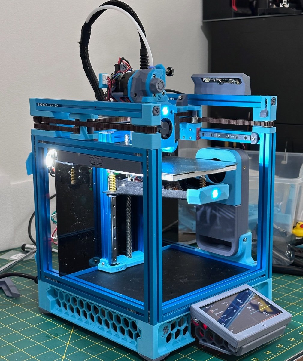

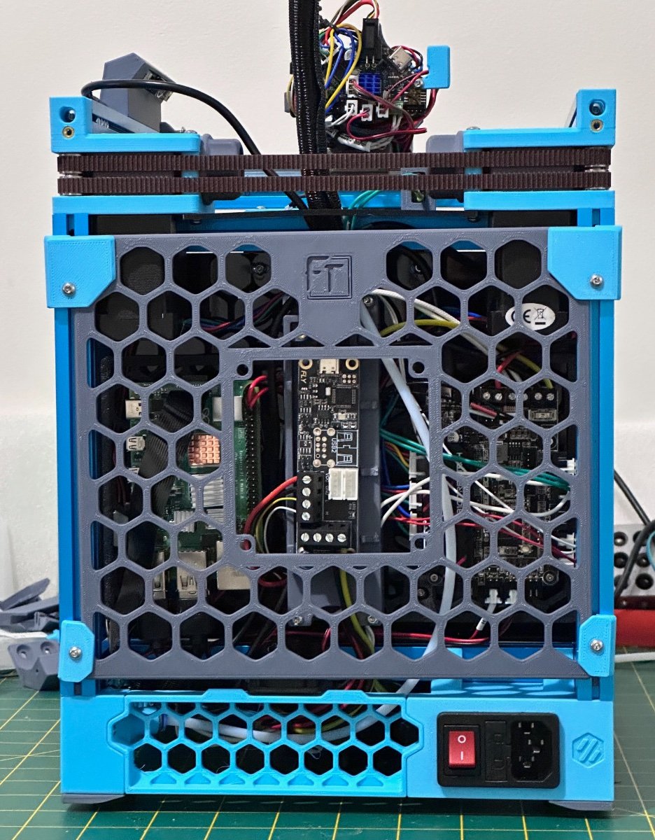

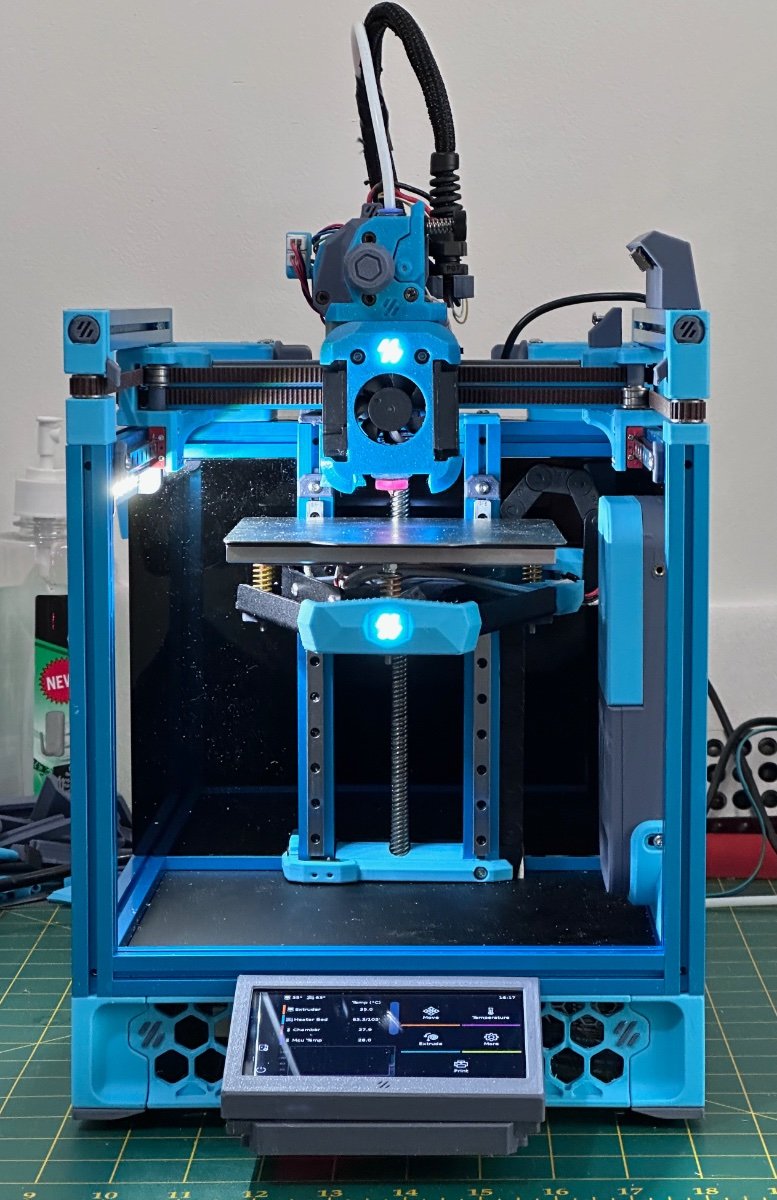

V0.2 Build Manual Pages 213 - 222 Skirts and Panels
All fitted and final testing done before enclosing the printer. Fitted some case lights, A Crazy Cam (Damn thing is autofocus, not fixed focus which may cause an issue) and the Bento Mini instead of the Nevermore.  Fitted the BTT TFT 4.3 screen, loaded klipperscreen via KIAUH.
Just for those that may experience this as well.. When installing Klipperscreen via KIAUH or command line , right at the end you get asked whether you want to install the network panel for klipperscreen. As it defaulted to yes, I just pushed enter. Raspi Pi disconnected from the network!. What the... Read the screen output on the terminal and turns out you need to turn on your wi-fi through klipperscreen or connect the Pi to ethernet and run the command "nmtui" which will then give you the ability to restore your wifi.
" If you were not using NetworkManager you will need to reconnect to the network using KlipperScreen or nmtui or nmcli"
The klipperscreen network manager, however did not correctly display my wi-Fi SSD - so I opted for the ethernet method. There is always something!

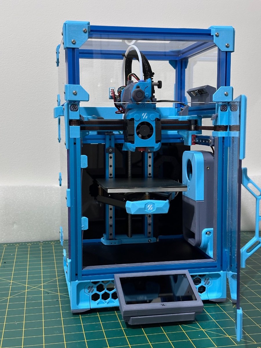

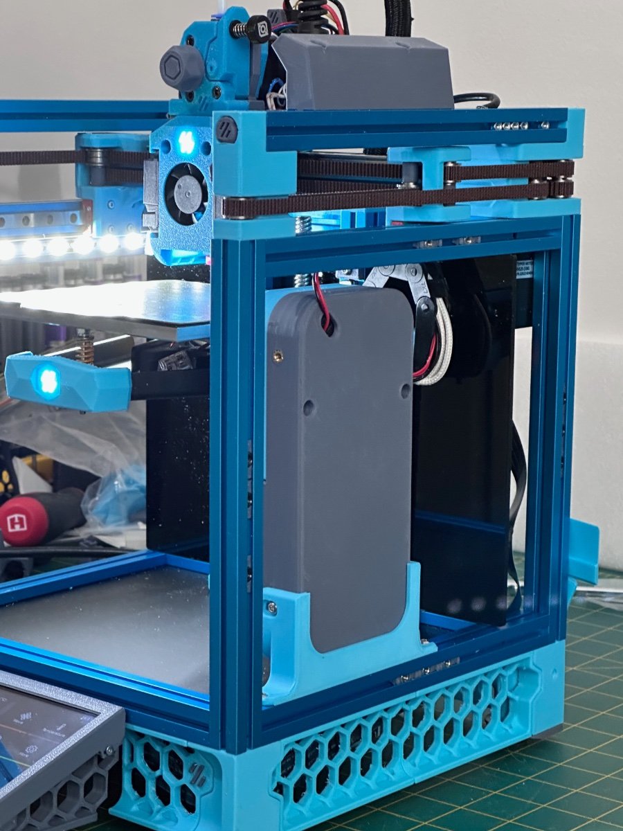

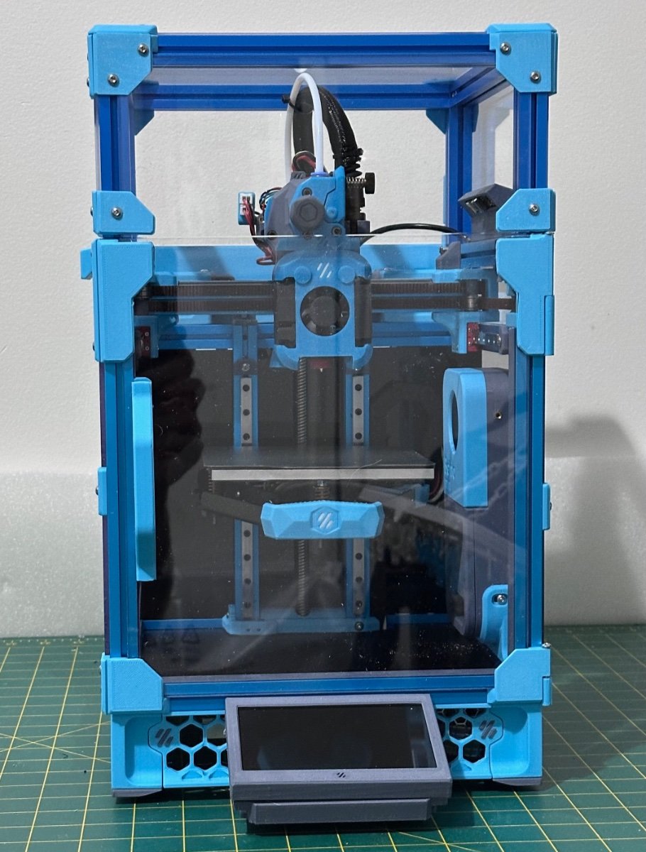

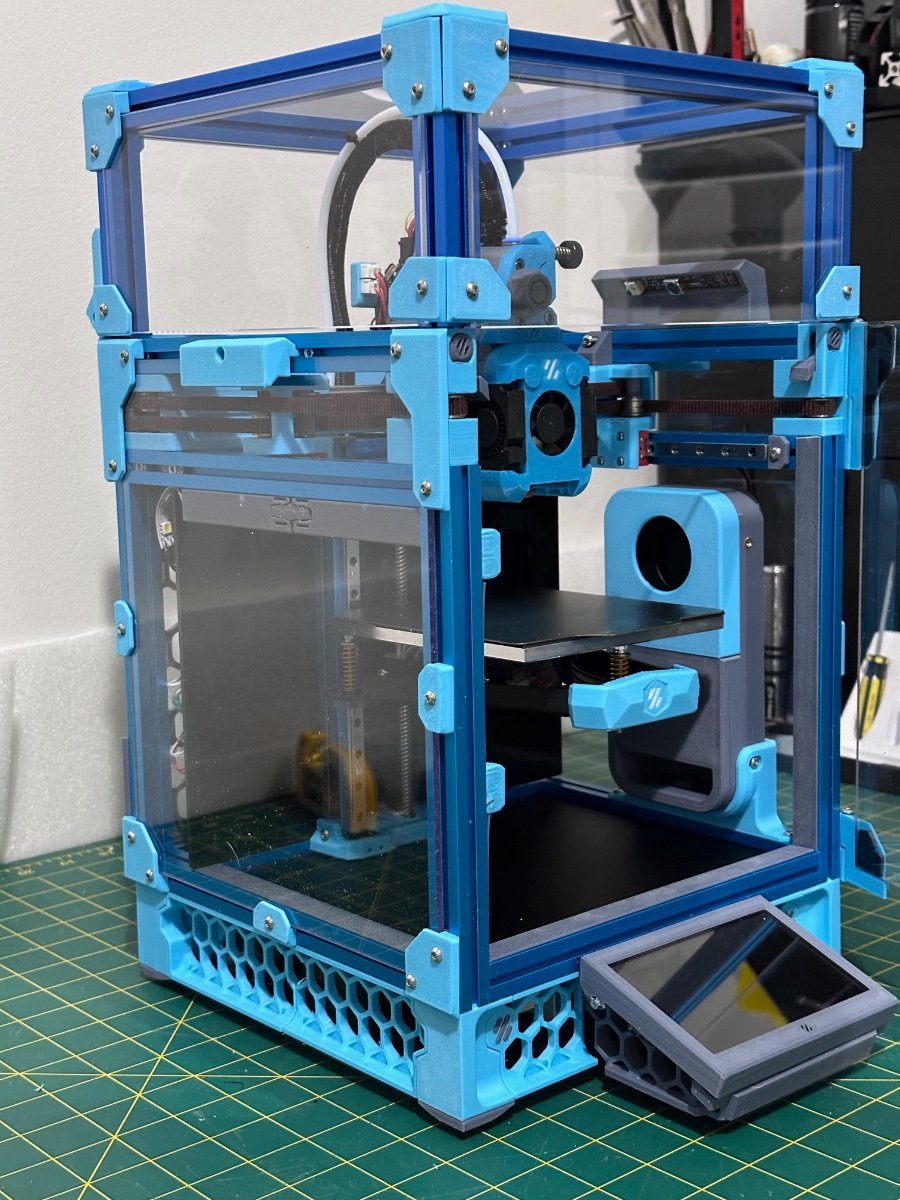

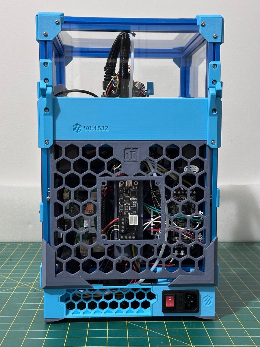

Here she is - all configuration checks completed, PID and Rotation Distance done. Ready to enclose. Going the Zero Panel way, so printing those now.

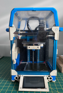

Well I have come to the end of this journey. Really enjoyed this build.
Renewed V0. 1632
IMG_7285.thumb.jpeg.fc05677f9f3b93438098a239b8f3f59c.jpeg IMG_7286.thumb.jpeg.254c1e152fdfadac73a29f67700eac38.jpeg
IMG_7287.thumb.jpeg.3ec587759bedf16911888b8a4b097539.jpeg  IMG_7288.thumb.jpeg.ea438173442f38362d93296d240fdde4.jpeg
From this:                                                                                                         to this:
IMG_7217.png.24d8b973338e69d8116ab0645aa7efd3.png                                             IMG_7286.thumb.jpeg.254c1e152fdfadac73a29f67700eac38.jpeg
As you can probably see, I gave up on the. Zero panels. Just could not get a solution for the door. Tried various options all without success. Also had to modify some of the panels to fit the V0.2. I have attached the files for those that are interested. The Zero panels had 3mm foam attached. Is it really needed? Thus went the traditional way as I do not see any reason I would want to remove the panels in the future.  If I do, I just need to deal with the screws 😄
