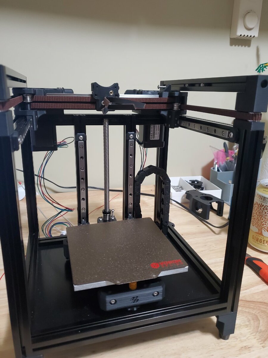

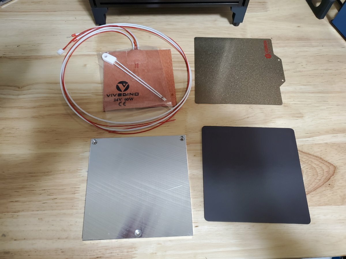

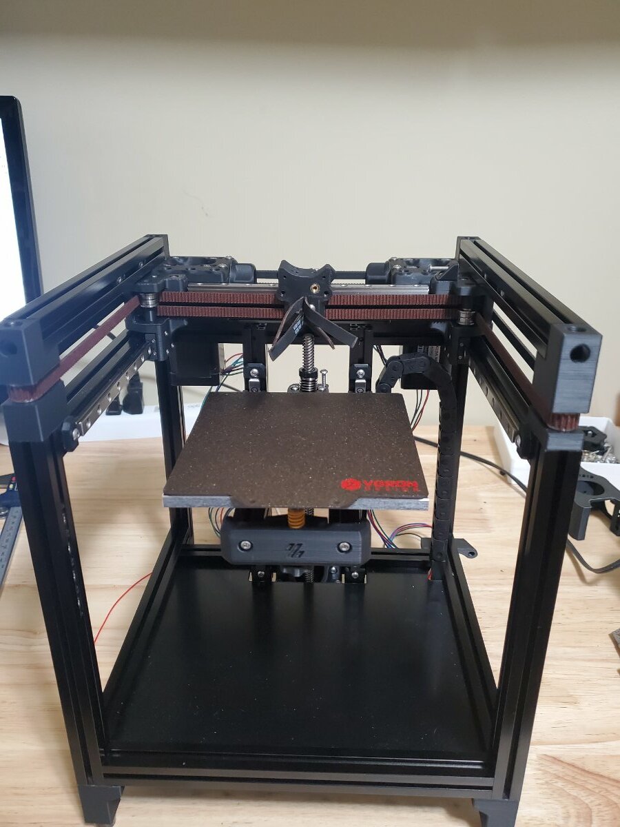

Once finished playing with the belts, I tackled the print-bed. Carefully applied the sticky back pieces to either side of the 6mm aluminium plate, after cleaning with isopropyl alcohol, and assembled it onto the printer. Had to cut some holes in the magnetic sheet to get the screws in, not my best work with a razor, however it is easily hidden with the fantastic looking PEI sheet. The heater is a Vivedino branded 60w 24V heated sheet. For the time being I have omitted the thermal fuse as I dont really have a method to splice the wires on hand that I can be happy with.
Old Faithful Ender3Pro is still humming away in the closet printing the last few ABS pieces. I'll be switching to PLA very soon for the exterior parts. I anticipate being held up waiting for the BTT Pico to arrive in the mail from wherever it is coming (hopefully not Shanghai)...
