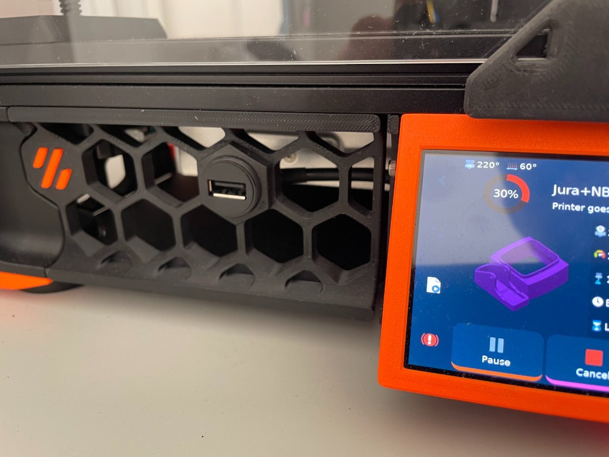

Hi all,
Is there a way to print from SD like other printers, I don't really need the option as the thing sits next to a pc, but I would like the option sometimes to just print?
I have Klipper screen etc so don't need the interface, but I don't know how to tell Klipper to look for files in a connected USB drive.
Plus I went to the trouble of making a snazzy modified front panel with a hole for the USB adaptor.

Oh i'm 100% network connected, the monitor I am looking at to type this reply is almost touching the side panel and the router is about 2 meters away 🙂
Its a 1st world problem, but a couple of weeks ago I was installing a new graphics card which (as seems to be the trend) was the size of a small family car, I had to rearrange the hard drive layout and at that moment 7pm Sunday, PC in bits on the floor, I would have traded one of my children for a 5.25 to 3.5" tray adaptor.
Not to worry I have an awsome 3d printer I could have them in an hour, but no way to print without said pc, so like any conscientious guy would, I screwed them onto one side of the dvd bay with poorly fitting screws and called it good, but it got me to thinking.
I know I can't slice without a PC so the point is slightly moot, but I would like the option like my good old Ender 3, plug in a SD and play.
I have a decent TFT and Klipper screen so most actions can be completed without the web interface.

I'll look into that, i did see a "sort of guide" to mounting a usb drive to auto open in a subfolder in the main folder where the print files are based that you could just navigate to when the USB was connected.
But it was above my current understanding.

I have installed a USB extension to the front skirt of the Voron. I can print gcodes from USB stick in Klipper, although I hardly use it, since it's more convenient to send files over wifi. I set up some auto-mount mechanism in the Raspberry Pi OS, so the USB-Stick folder gets auto-mounted when I insert a stick. A small sdcard reader to USB on the Raspberry Pi should be doable as well.

DId you follow a guide to do so?
I'm way more hardware than software orientated and always worry I will break everthing.
