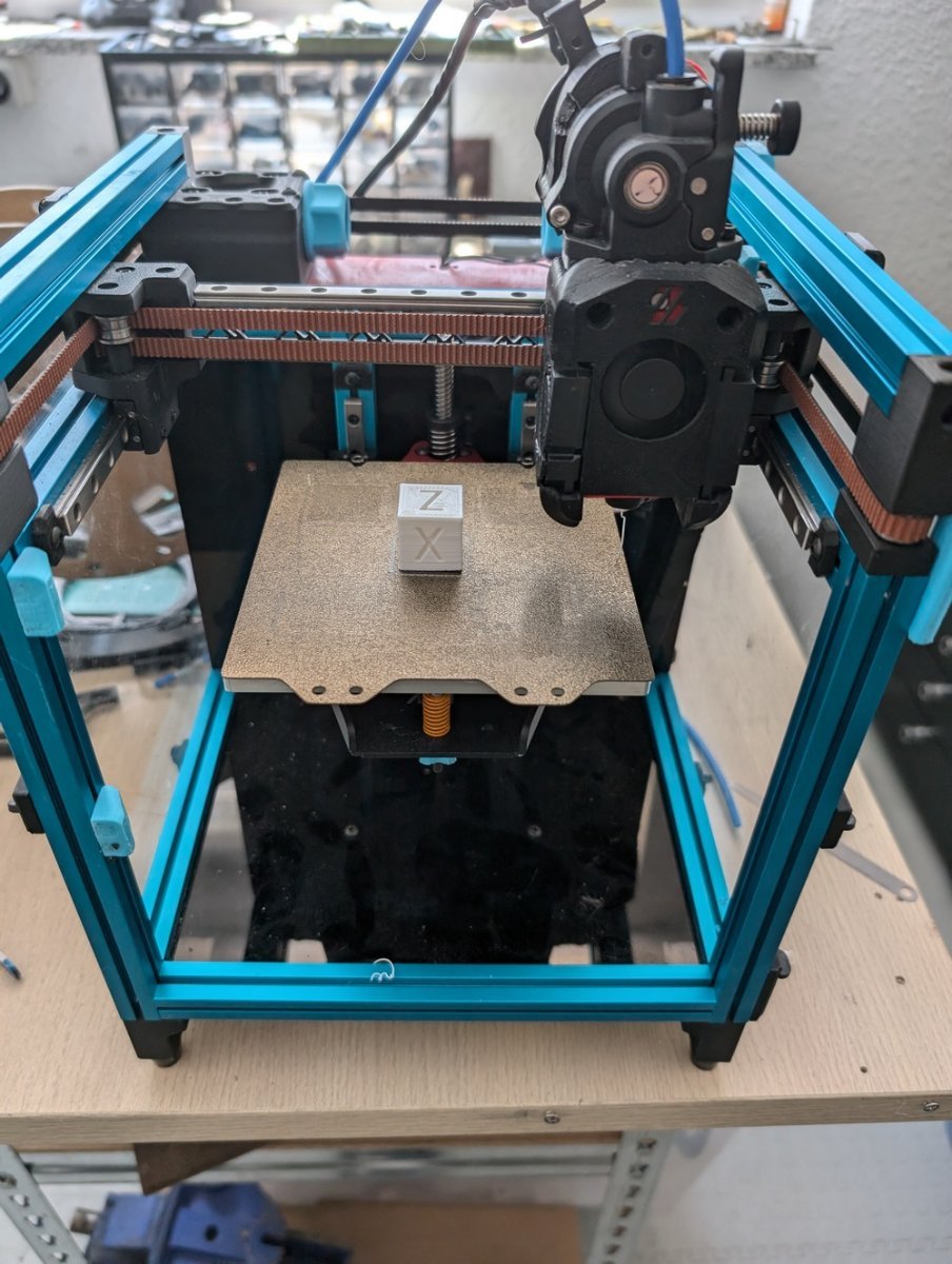

I managed to get my v0.1/2 back up and running.
I ditched the troublesome Manta M5P / CB1 mainboard. I could not get it flashed.
It used to be relatively straightforward, but something has been changed, and no the esoteric guide does not help (it's Pi orientated).
After a bit of research and a few YouTubes, I went with a BTT SKR Pico, a BTT Pi v2.0 (I got it cheap) and a BTT U2C. I kept the EBB36.
The whole lot went together easily and with the U2C being pre-flashed it was up and working in no time.

I'm just about to start the Orca calibration tests. Then there's a bit of tidying up of the wiring.

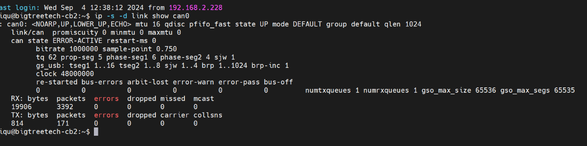

See if your can network shows up when you ssh into the BTT Pi and issue:
ip -s -d link show can0
You should see the can network. If not try a different can adapter if you have one. The waveshare Pi canhat is very cheap but don't know if it will work with the BTT Pi.

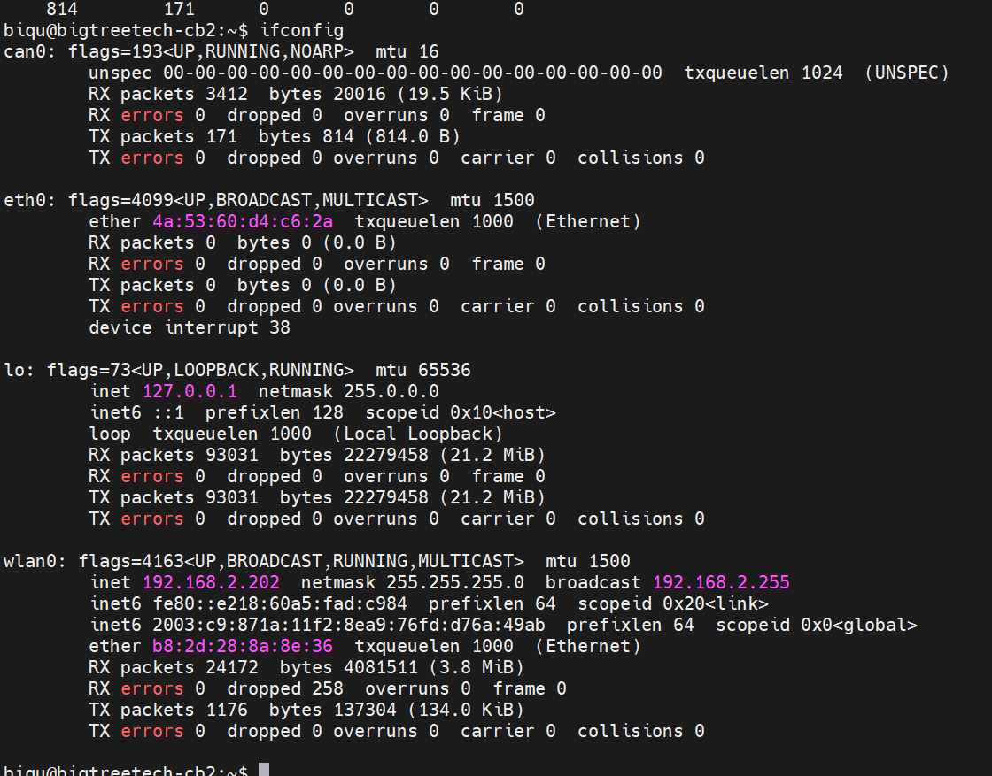

I think the EBB36 had gone down. I replaced it and can see it's UUID with python3 ~/katapult/scripts/flash_can.py -q and it's in Katapult mode.
But now I've got the no buffer space available again.
mcu 'mcu': Starting CAN connect
Created a socket
mcu 'mcu': Unable to open CAN port: Failed to transmit: [Errno 105] No buffer space available
webhooks client 548395522704: New connection
webhooks client 548395522704: Client info {'program': 'Moonraker', 'version': 'v0.9.2-6-gf735c04'}
I updated the /etc/network/interfaces.d/can0 to what is in the esoterical guide, rebooted.
The no buffer space error has gone, there's now this error:
File "/home/biqu/klipper/klippy/serialhdl.py", line 61, in _error
    raise error(self.warn_prefix + (msg % params))
serialhdl.error: mcu 'mcu': Serial connection closed
I cleared that be changing the can L & H around.
Now klipper log gives me this:
Created a socket
webhooks client 548069465056: New connection
webhooks client 548069465056: Client info {'program': 'Moonraker', 'version': 'v0.9.2-6-gf735c04'}
Which looks okay.
