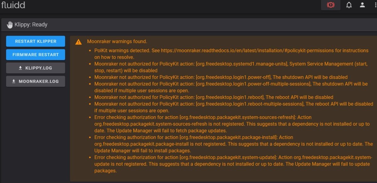

Let me start by saying, I'm not so computer savvy when it comes to using the command prompt for making corrections. So, like many of you after installing Fluidd or Mainsail and going into Klipper you have a list of errors (see Attachment). I can't seem to be able to figure out how to locate the necessary directory  to make the changes on cmd prompt. Can anyone send me the step by step instruction how to accomplish this? I know that once in the correct directory I have to do the following:
To resolve this warning you have to install the PolicyKit permissions with the set-policykit-rules.sh script.
SSH into your system and execute the following commands:
cd ~/moonraker/scripts
./set-policykit-rules.sh
sudo service moonraker restart
HELP PLZ!!!

My son helped me! He said at the cmd prompt;
ssh pi@fluiddpi.local
next is the :
pi@fluiddpi.local's password: Raspberry
Then you can preform:
I hope this can help someone else as well
That's pretty much it.
SSH in to the pi. For me I have to use the IP address and I use Moba XTerm; you can also use the ssh command from the cmd in Windows or load putty. Any of them work.
Assuming you didn't change login credentials, user id is "pi" and password is "raspberry" Case matters. You will also want to change the password to something else.
From there copy/paste the three commands:
One at a time. They:
Change directory to the correct one ("~" is a shortcut for home: /home/pi).
Run the script--same thing as a batch file.
Restart the service to implement the changes.
