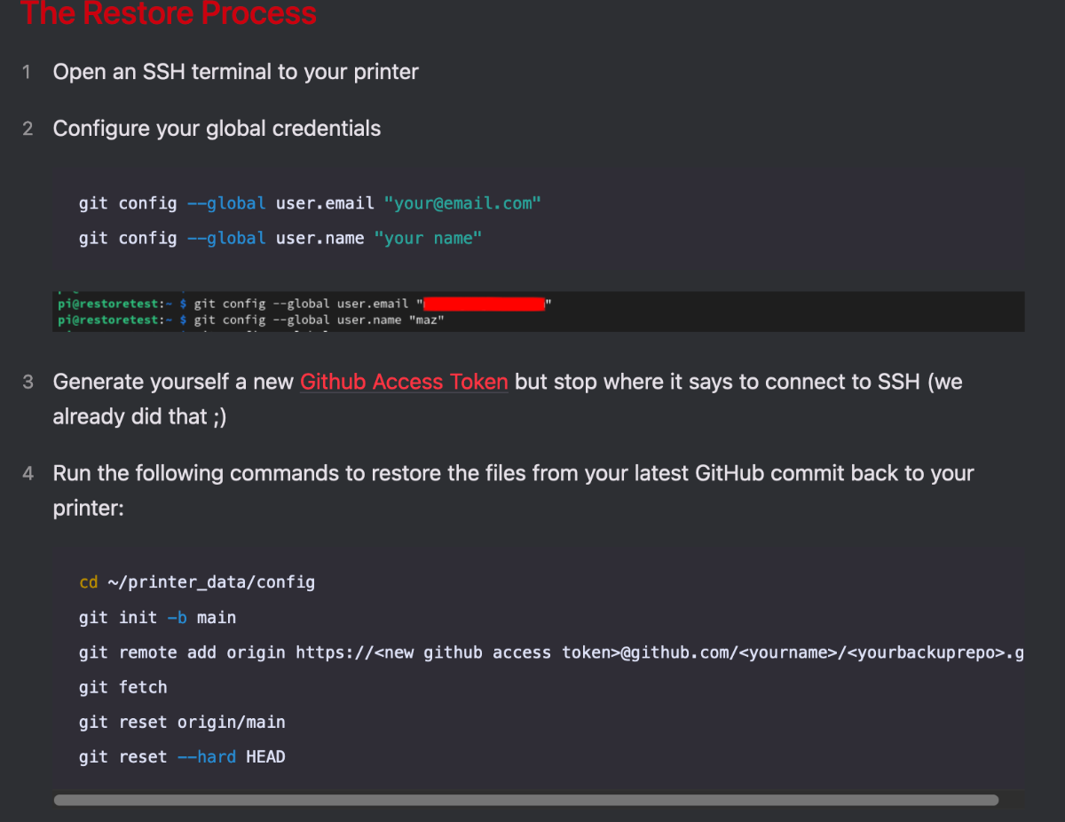

Do it as @TitusADuxass indicated, easy and hassle free,  or you can follow this guide - much more complicated though, but just for your info.
