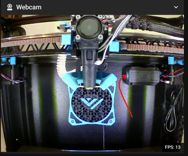

I have a VzBot 330 with CPAP.
Pros:
Light weight
Huge air volume
Cons:
Toolhead has to drag around a hose
CPAP fan is very slow to respond. ~2 seconds lag from issuing a command to fan speed ramping up or down and maybe another second or so before the airflow makes its way down the tube and to the nozzle.
Myths:
It does not pull air from outside the chamber
It does not pressurize your chamber
Where does it pull air from then?
the unit I was looking at has the impeller unit mounted on the back of the printer, outside the chamber with the hose passing through a custom exhaust plate. If not from outside the chamber where is the air coming from?
