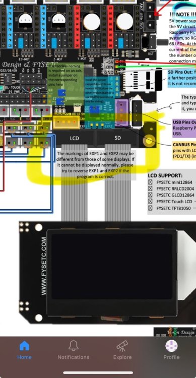

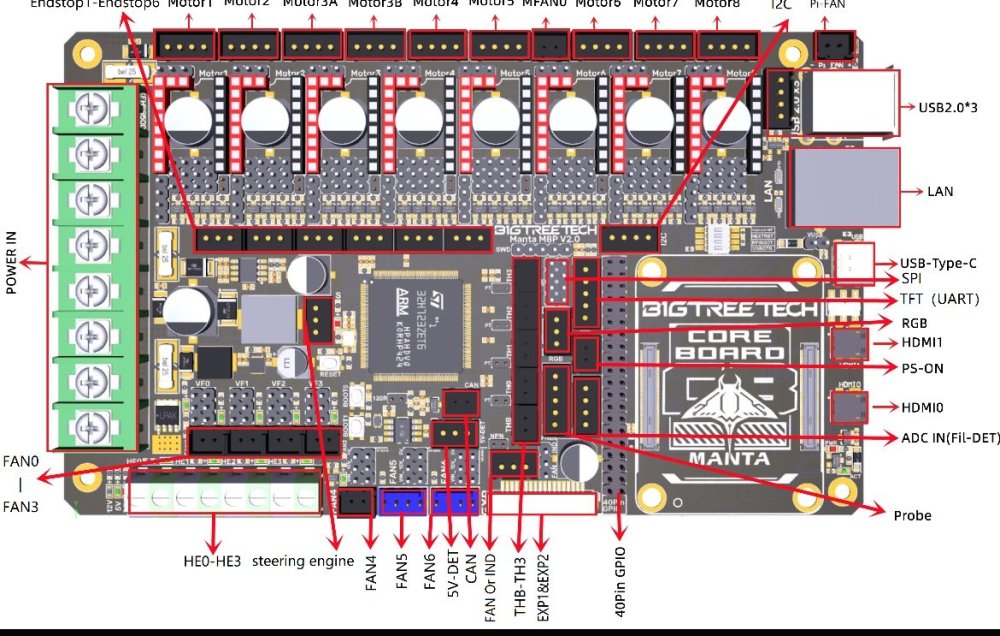

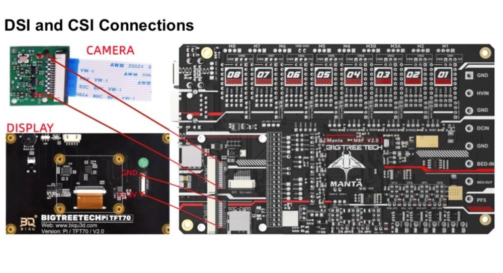

I recently upgraded my v.2 to a manta mp8 with cb1 and sb2209. Without prior knowledge I didn’t realize the mp8 v2 dosent support the exp1&2 connections that the v1 had. Same as using the spider 2.3(see pic). I have an extra raspberry pi 7 inch touchscreen laying around not being used. Is this possible to use with the manta v2, with a cb1? I realize that the cb1 dosent support the csi and dsiconnections if your not using a cm4 compute, which i wasn’t aware of till after the fact. I really don’t want to buy another screen if I can use the pi7. Is it possible to use it just via usbc? I didn’t plug it in because I’m still wiring the can and configuring can bus.
