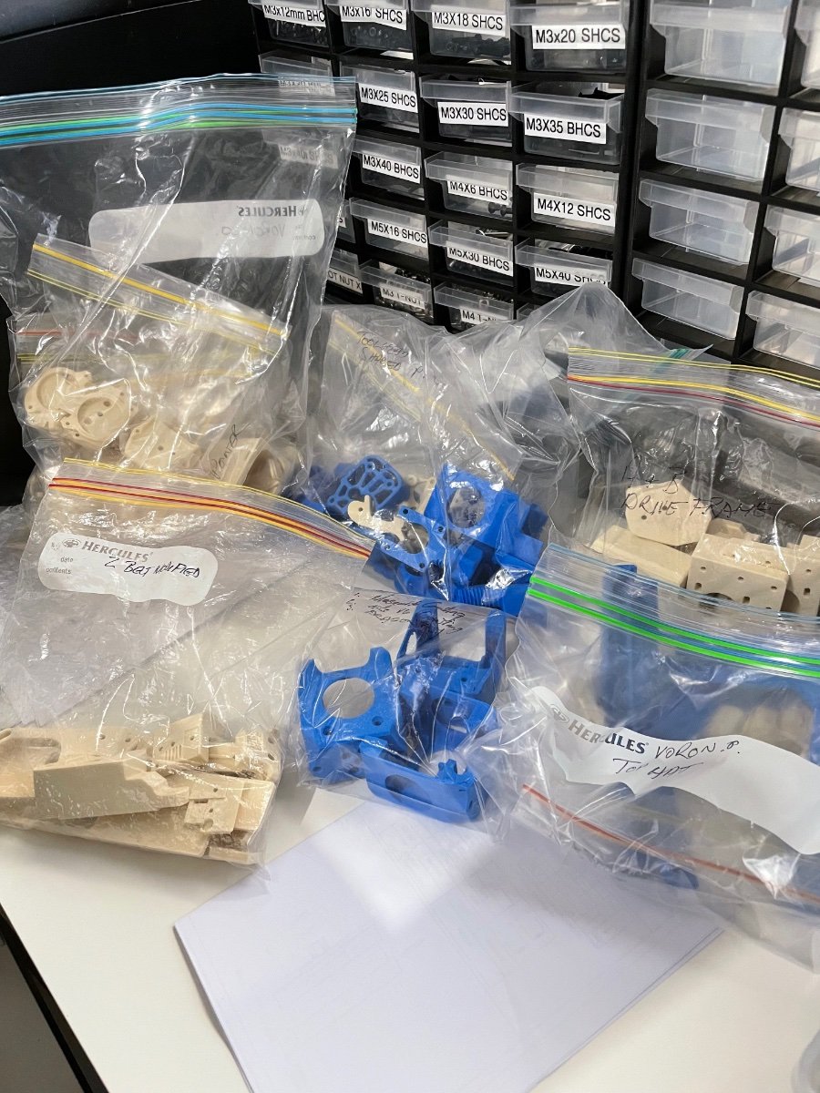

Well, my journey in the world of Voron. Having modified several printers, decided I was going to build a Voron 2.4 300mm. Sourced and printed all parts. Guess what - it went from 2.4 to 2.4r with a bit of reprinting to be done.  Read a lot, thought a lot, decided - put 2.4r on hold (put away all individually sourced parts and printed components - took a BIG tub to fit it all in) and why not start with something less complicated - a Voron0.1

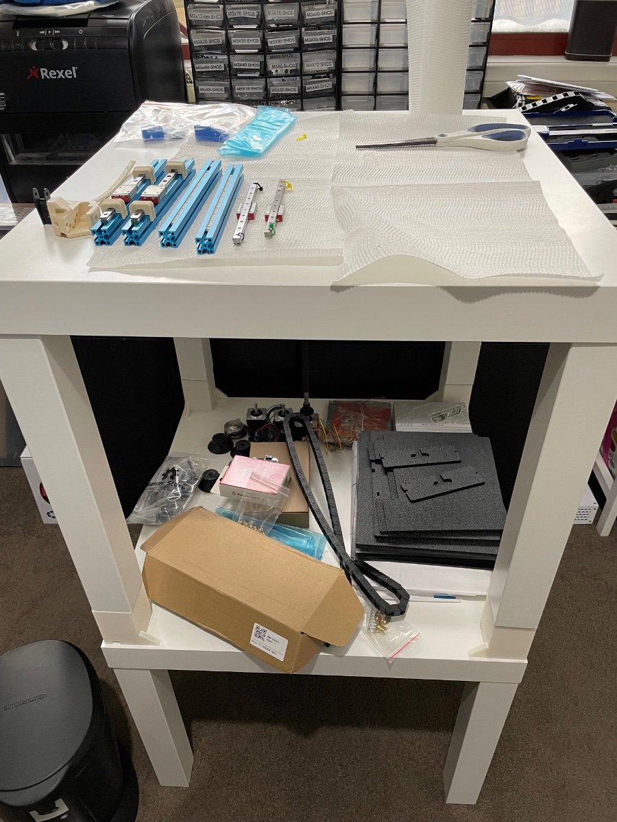

Again sourced all the parts individually - decided on a coler scheme - printed all the parts and finally started the build last Friday evening.

From this :
IMG_1590.thumb.jpeg.4293d0060a477cff28590bb4e978e827.jpegIMG_1593.thumb.jpeg.f332aa4173031999194b8bb733ef02c9.jpeg

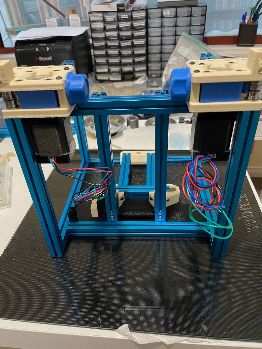

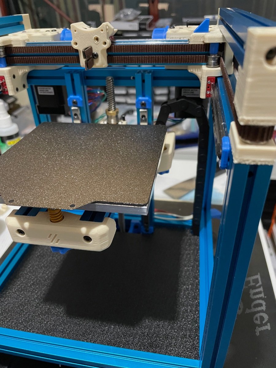

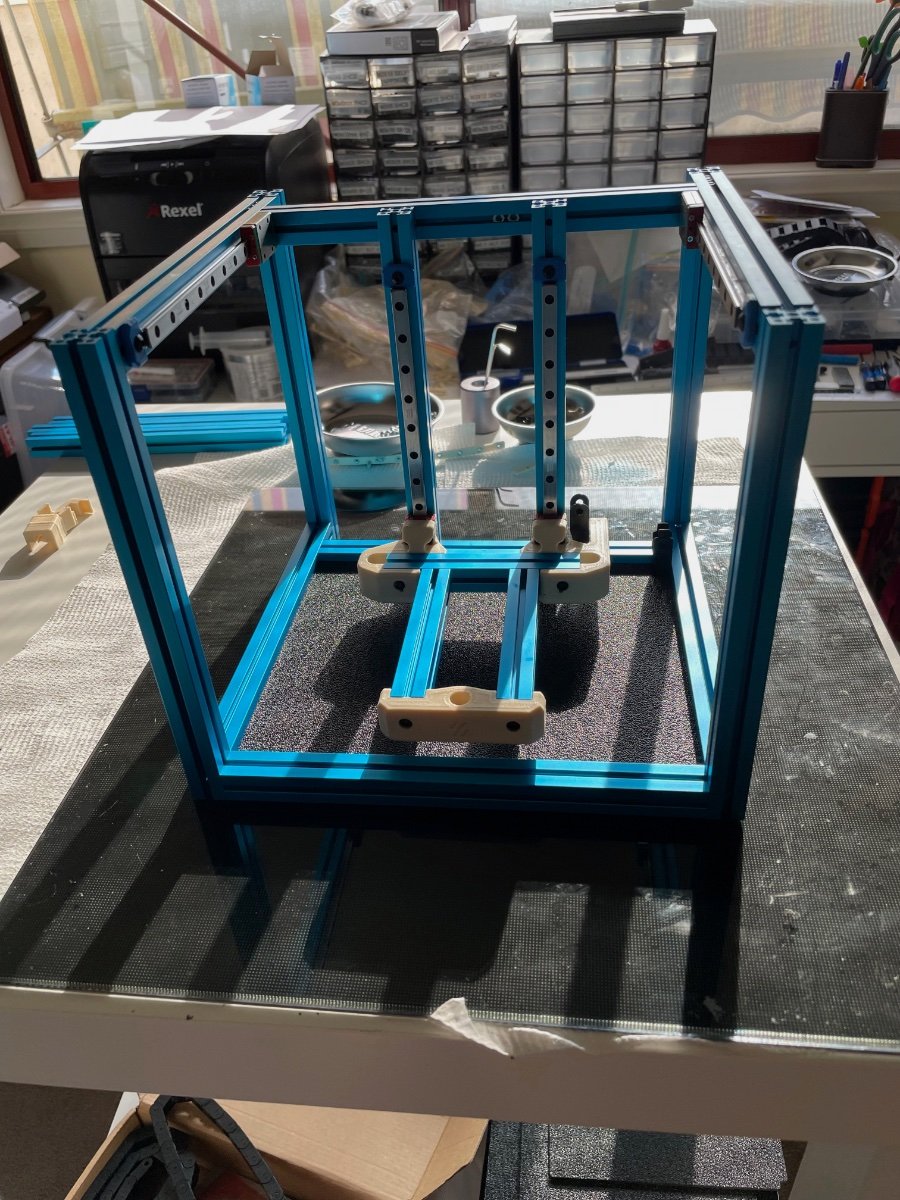

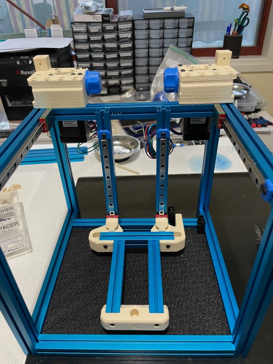

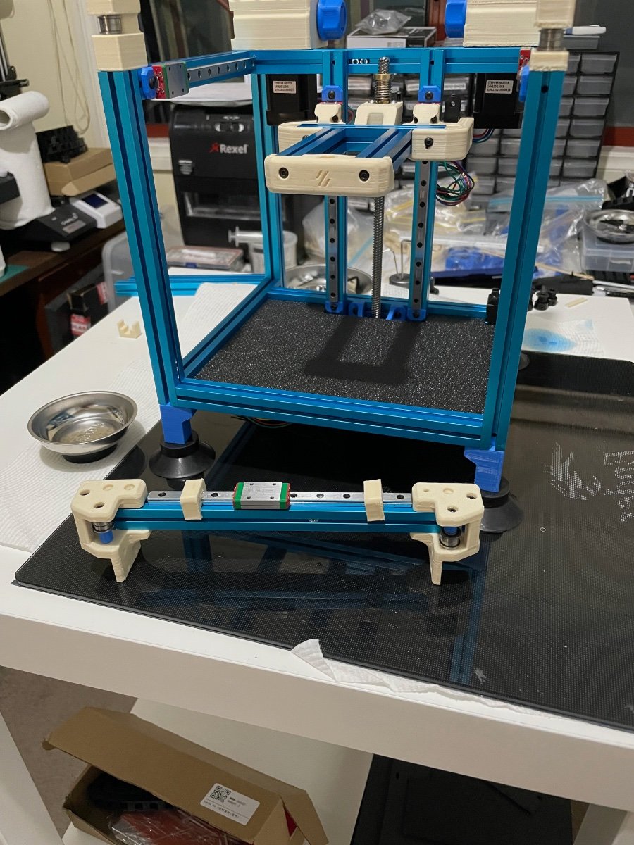

To this over 3 days:

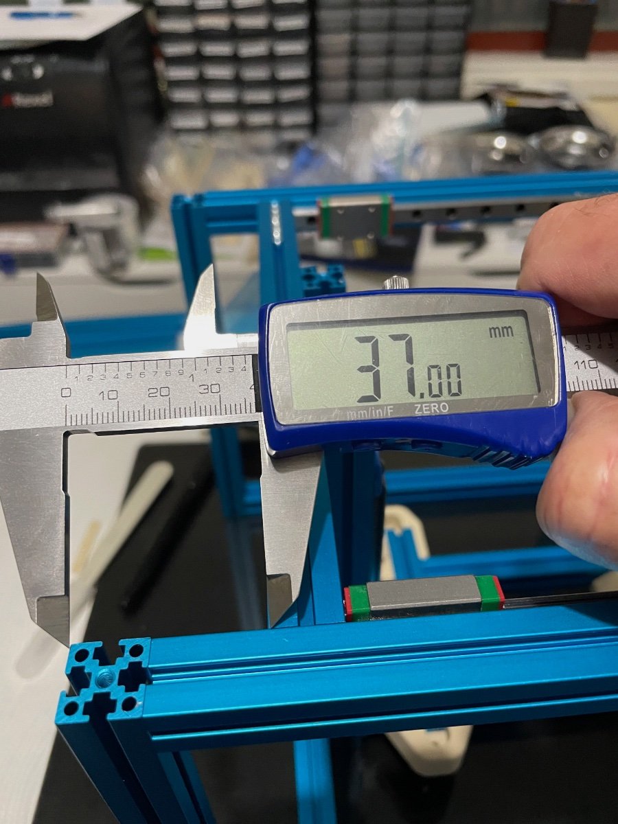

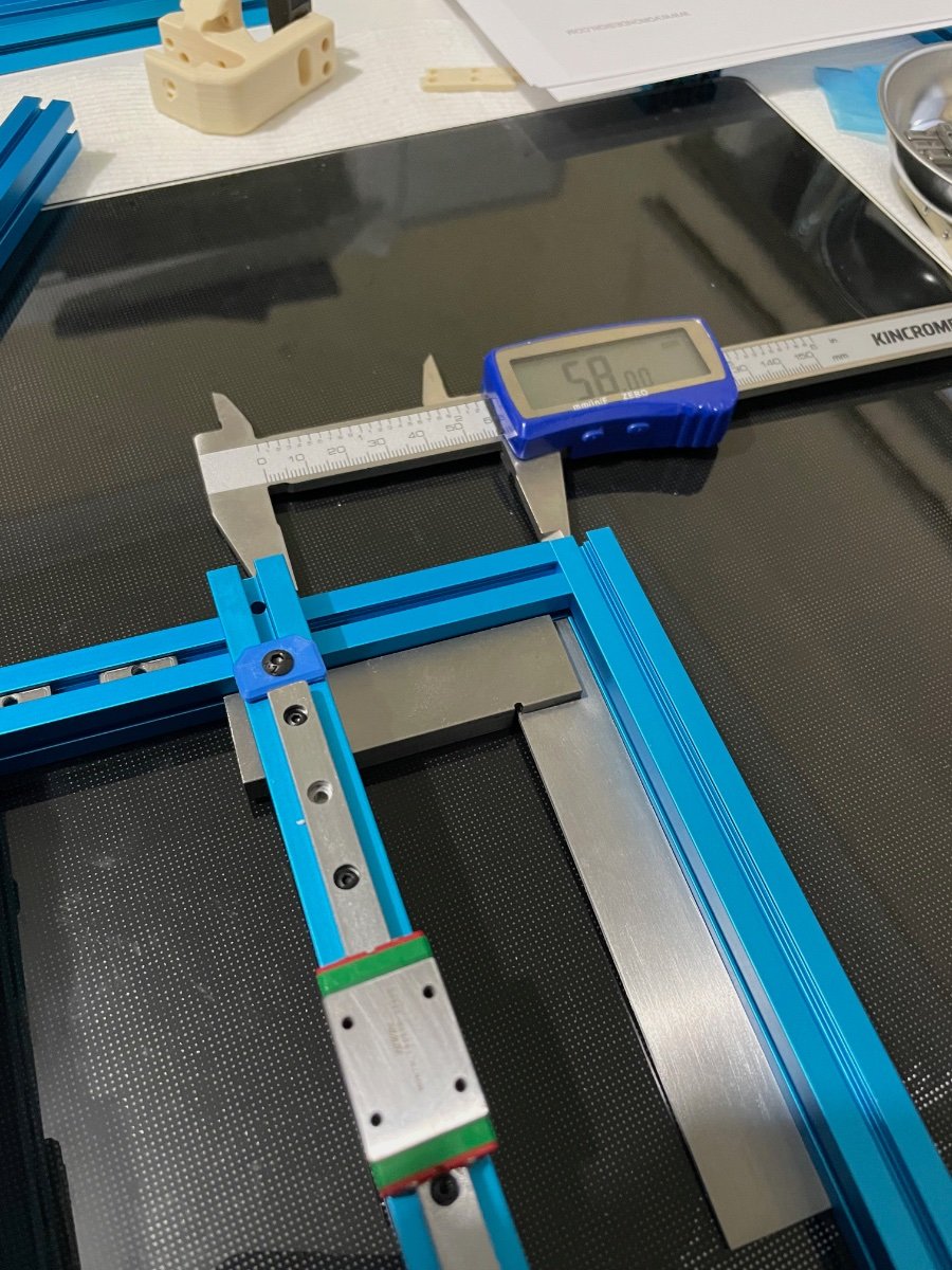

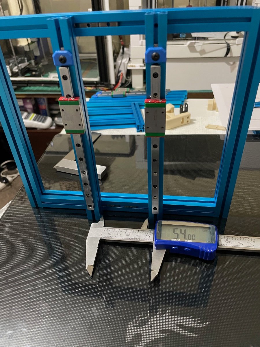

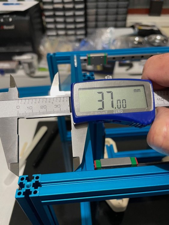

Measured trice, not just twice
IMG_1598.thumb.jpeg.95c6c248e331da5925b3b8d05be98ee0.jpegIMG_1599.thumb.jpeg.67499143e272c0dca0def36d0b6dc7bb.jpegIMG_1604.thumb.jpeg.1f3deb6bda9d840939b20334a0e8e8af.jpeg
Paid off as the bed just falls effortlessly along the Z-rails due to gravity alone.

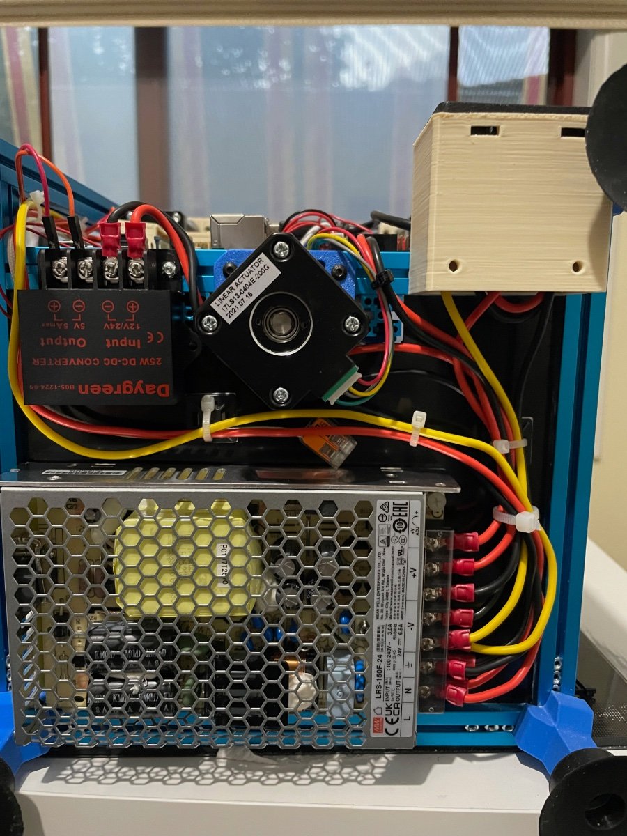

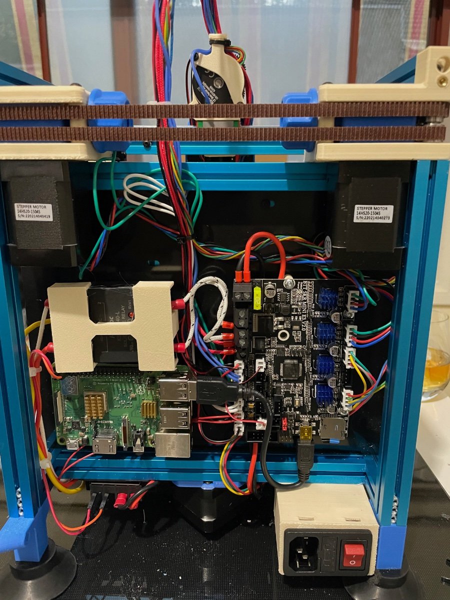

Ran into interesting problem. Decided to test the electronics prior to continuing the build - installing skirts and panels. could not get the machine to home X and Y correctly. Changed direction pins, etc. Rewired the motors - no joy. Did a lot of reading and came across a post mentioning NOT to change only one axis direction pin. If you reverse the direction for X-Axis, you need to reverse the direction for Y as well. Did that - only issue then - Y homed normally, X direction was reversed. Founds the following in the config under [stepper_x]:
   position_endstop: 120
  position_max: 120
  homing_speed: 50 # Can be increased after initial setup, Max 100
  homing_retract_dist: 5
  homing_positive_dir: true
Change the above values to position_endstop: 0
                                                homing_positive_dir: False
Homing perfectly now. Will have to see how it translates to printing later on. Don't know if this is a known issue. I find the Discord forums confusing and difficult to search.
Now to continue the build.

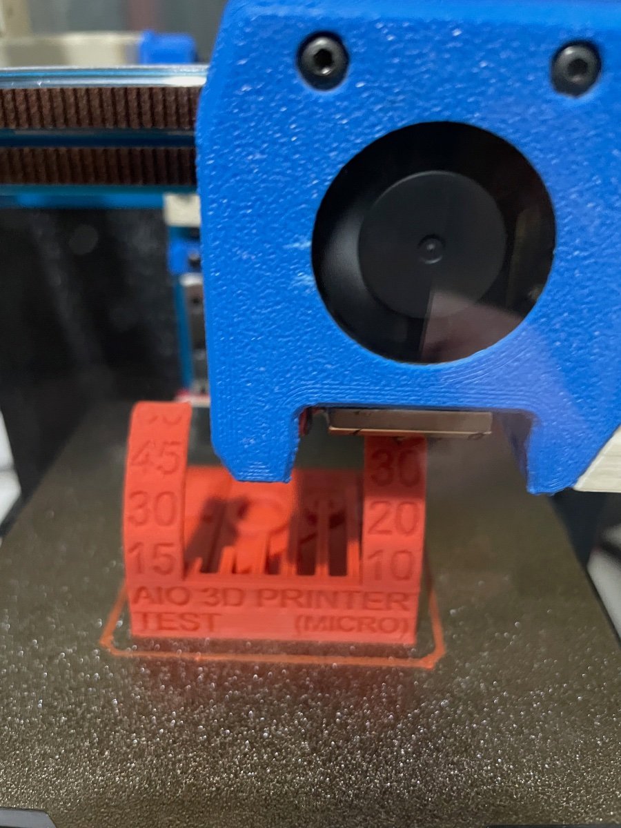

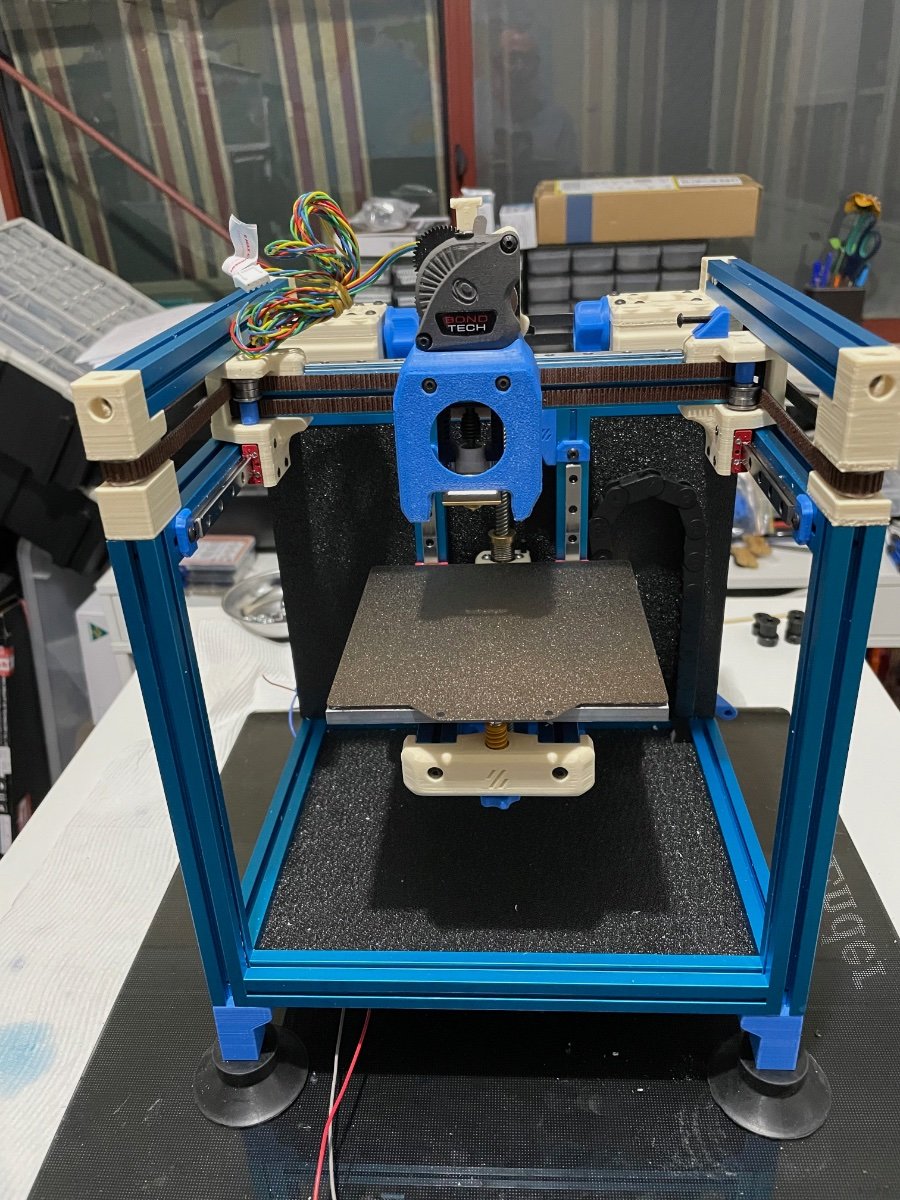

Well that hiccup was indeed a bit BURP. Did the first test print and everything was mirrored. Racked my brain, trolled the forums and finally it clicked - Reversed the A and B motors input on the SKR board. All up and running and printing great
. Great fun, lots of learning - now for the 2.4r build.
Initially did not have layer fan on for ABS and first time using this filament. HotEnd too hot. In process of reprinting these parts. Were printed on Ender 3v2. Now using the Voron0 to print replacements.
Serial Request submitted on Reddit.

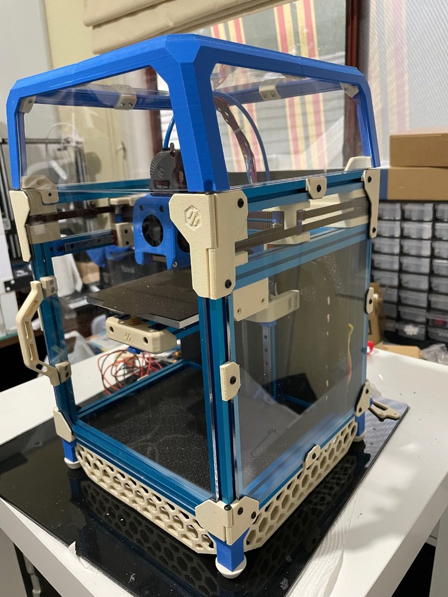

Happy with the build. What a great little printer. Even though it has such a small build volume, this has now become my goto printer and favourite of all.

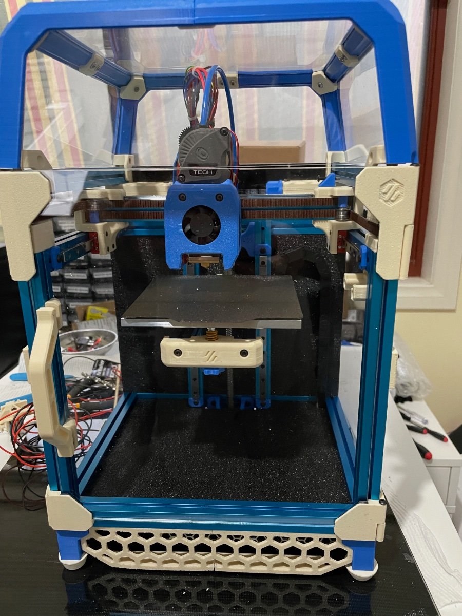

This build journey has ended. Serial number V0.1632
Printing great.
Next build - Voron 2.4r2 - will post as soon as I get started.
