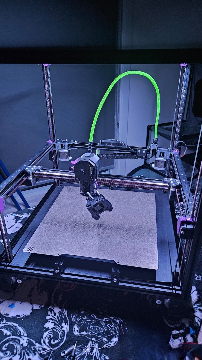

Frame went together really well after it was suggested I grab a frame jig, I'm not sure who it's made by but it's CNC'd and you just push in the extrusions and it gives a perfect lot straight cube once you finish. Think the frame was done in 10 minutes or so and after checking over with a square, was perfectly square.

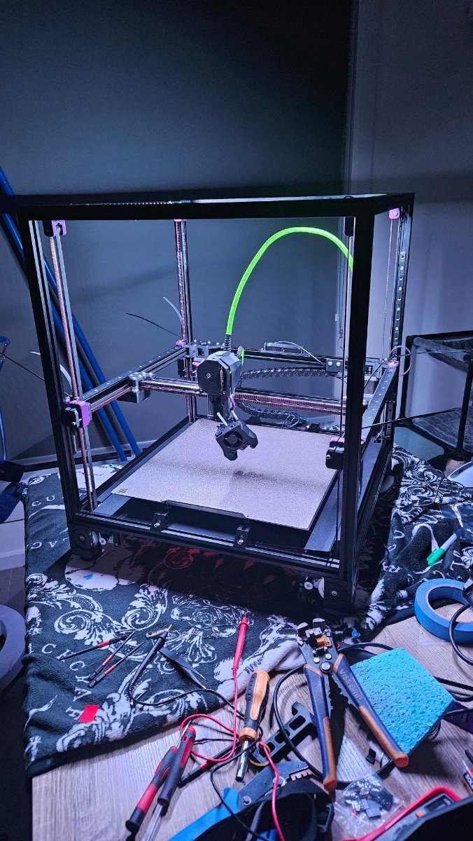

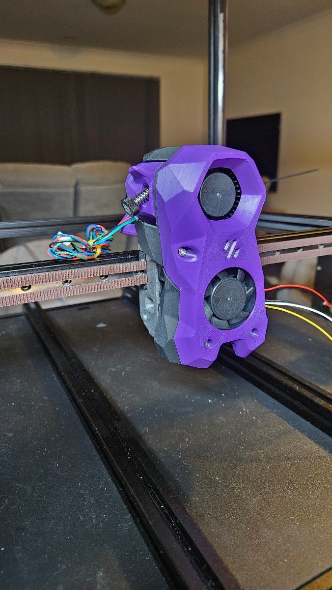

Finally got around to running it for the first time.. noisy motors but i think thats to be expected?
Its an MPX 2.4 R2 kit - https://magicphoenix.xyz/product/voron-v2-4-customized-kit/
Here are all my configs so far https://github.com/krautech/voron-2.4r2-octopuspro-sb2209
Motors for reference.
https://www.moonsindustries.com/p/nema-17-standard-hybrid-stepper-motors/ms17hd6p4200-000004611110008905
Ill attach a video or two of the motor sounds.

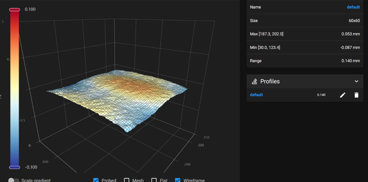

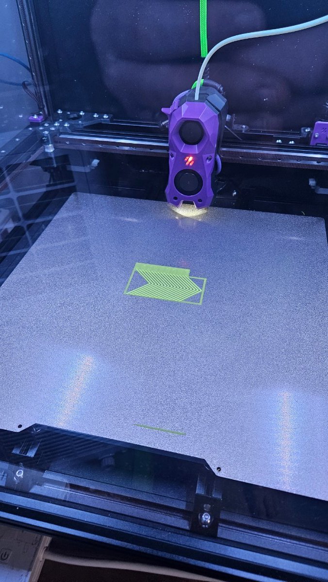

Well it's all fun and games.. had it calibrated, printing...now pull down again 🤣
Vyper printed the BFI and BZI mods so they're going in tomorrow as well as CNC cartographer carriage and I forget what else.

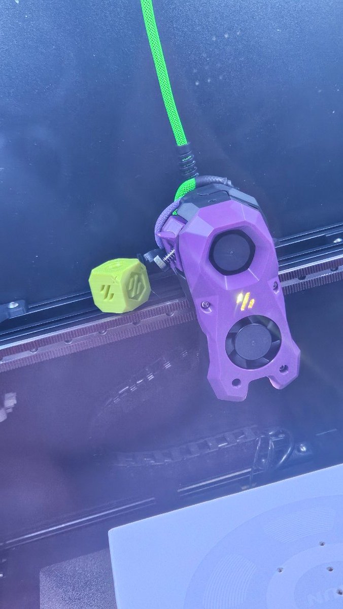

Also relocating the canbus cable from the rear gantry to the exhaust vent 20240528_220904.thumb.jpg.6a66c171d8908410398f7a6d69525900.jpg20240527_194420.thumb.jpg.d874eb3dbffbfc5bfc08724a6e78b08f.jpg20240526_160959.thumb.jpg.a9cc9a66059d698dcbf7df28cac7542c.jpg
Just now, Dirk said:
Can absolutely recommend that move 🙂
I'm glad to hear it! It'll tidy up the look of the Bowden and cable..didn't like them going on different directions. Sent my OCD haywire.

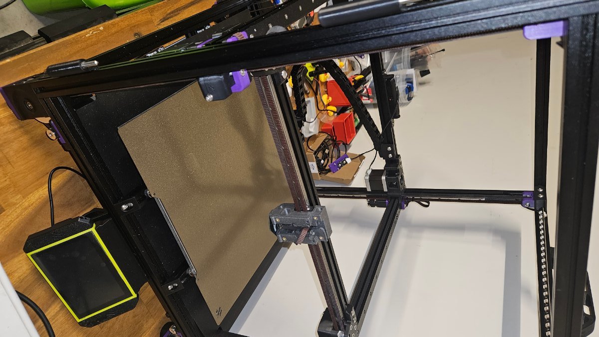

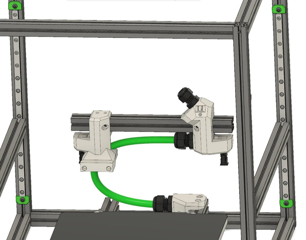

Considering removing the z chain altogether tbh
  • Haha 1
22 minutes ago, Dirk said:
Let us know when you have a good solution. I didn't like the ones around.
Yeah im not sure yet, contact strips up the extrusions somehow? bit dangerous though lol and id have to isolate each side
