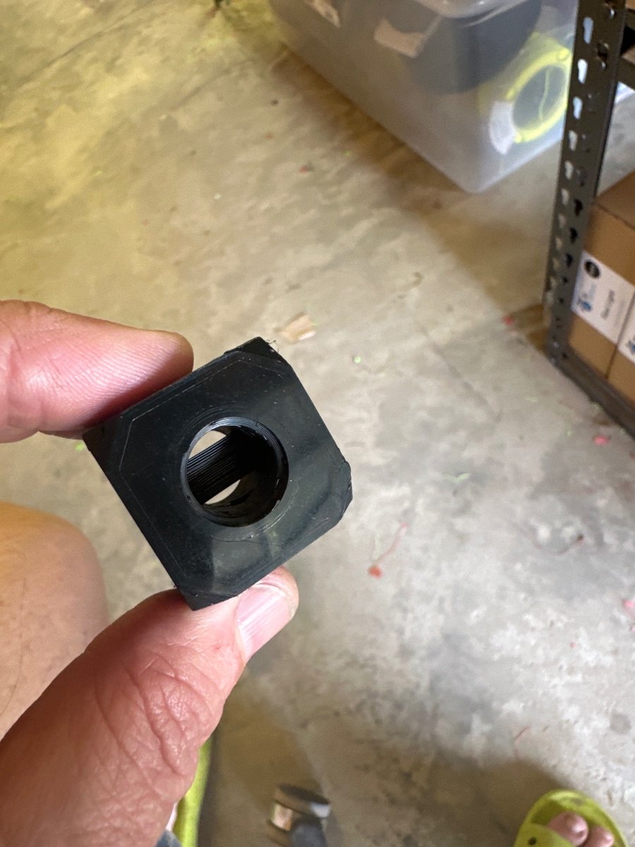

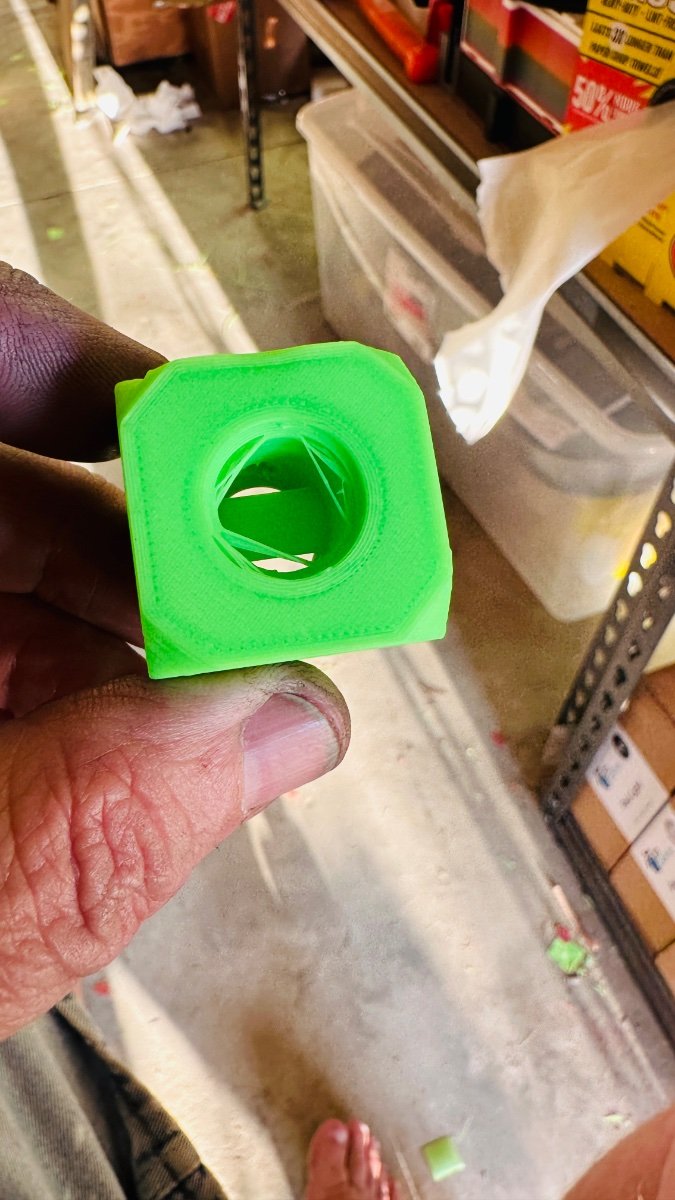

I have my V2.4 almost tuned to an acceptable level. Except for when it prints circles/holes. It looks like some of the lines either don’t adhere or the printer is skipping across the circle. What do I adjust in either the slicer or on the printer to fix this?

I think the reason those wires are visible, have to do with a few things at once. When you look at what happens when the circle of plastic is being laid on the previous layer, you will see that it becomes a 'string' of plastic and before it can stick to the bottom, it is pulled away by the nozzle, which is on the other side of the circle.
So if you would want to solve this, you would have to make the plastic more hot, so it melts and does not form a line. Or you would want to blow very hard on it as soon as it is out of the extruder.
So this would mean you would have to make your temperature higher, if the filament allows this. And Cooling more, like 100% during the circle movements would help or even solve the problem.
Finally you could consider going slower, which will give the plastic the time to stick to the layer below, by the time your nozzle is on the other side.

What order are you printing the walls? I wonder if that's trying to print the outer wall first so there's not much for the filament to stick to.
as a matter of fact I am doing outer first. Saw a couple YT videos stating getting better dimensional accuracy when doing outer walls first. Let me try inner first....

ABS/ASA didn't need that much cooling
That's true when you are printing on a bed-slinger, without enclosure or a heated chamber.
Check out the post where @TitusADuxass was tuning his Rapido 2... he shows there that in his case more cooling (+- 80%) gave better results for that print.
Also an idea to view the orca slicer capabilities in that post, since they have talked you into considering SS 🙂
After I saw his post, I experimented with more cooling. I almost exclusively print ABS and I use 100% cooling with SB on overhangs and bridges. Also when the layer time drops below 20 seconds.
My standard cooling for ABS in my printer is 50% after the 4th layer.
I have found the stealthburner perfect for ABS. But feel free to experiment with different toolheads, extruders, hotends... Just make sure that all things will fit (including the toolhead board) before buying all hardware or printing the parts 🙂

Aha, yes, cooling. When starting out I also found the "ABS needs no cooling" common "wisdom" first. Then I ran across more knowledgeable advice--mainly Ellis--who tell you probably 30% at a minimum. I think I'm at 35-40% to start and bump up like @Dirk for short layer times.
I have always printed the default of inner then outer walls and have always had good dimensional accuracy.
