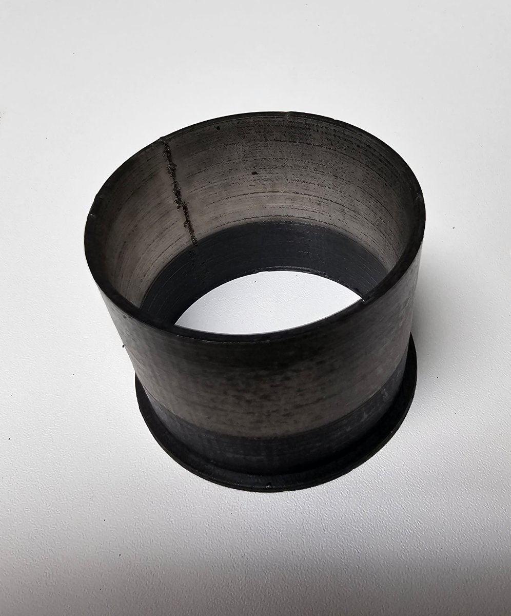

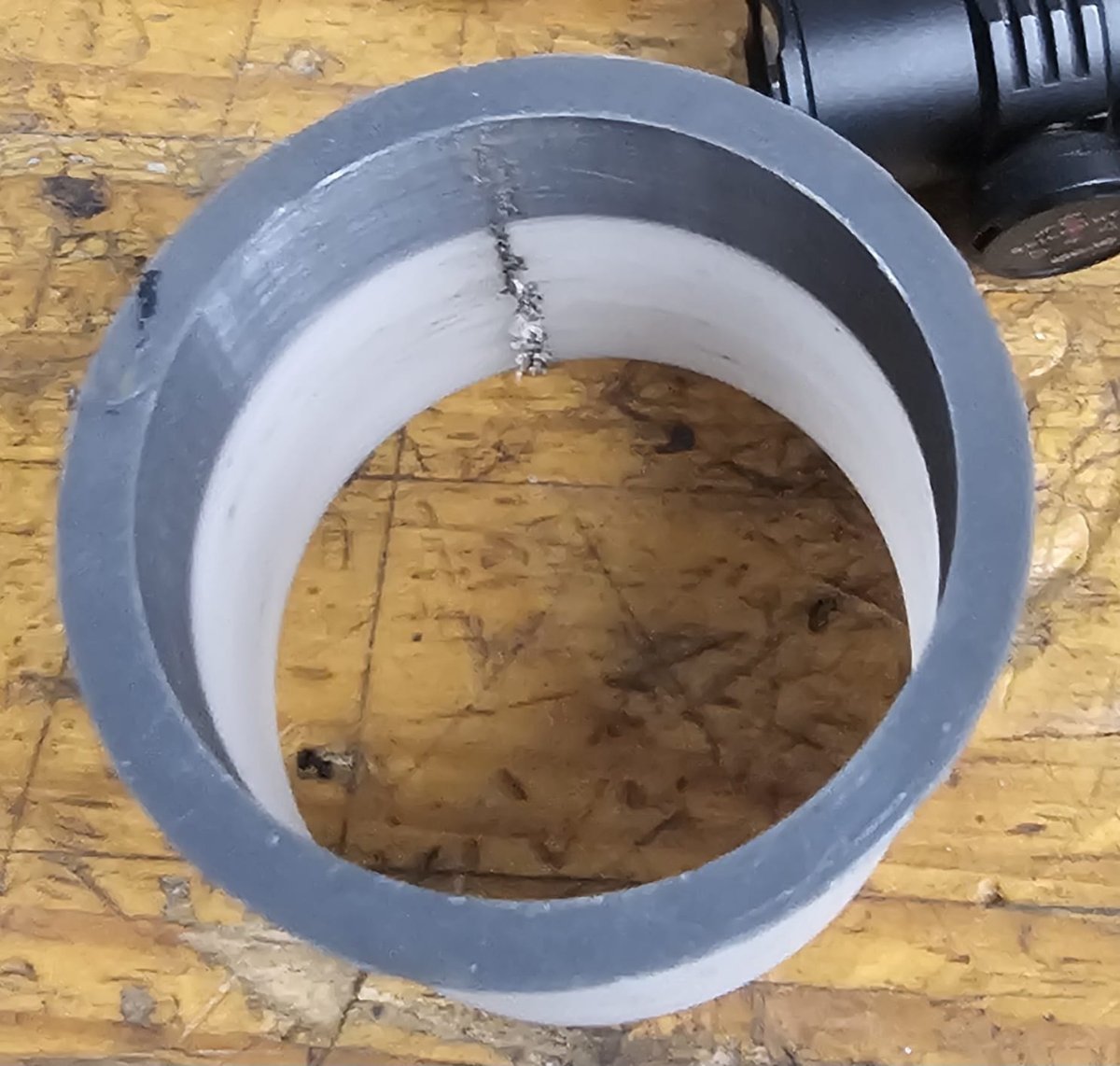

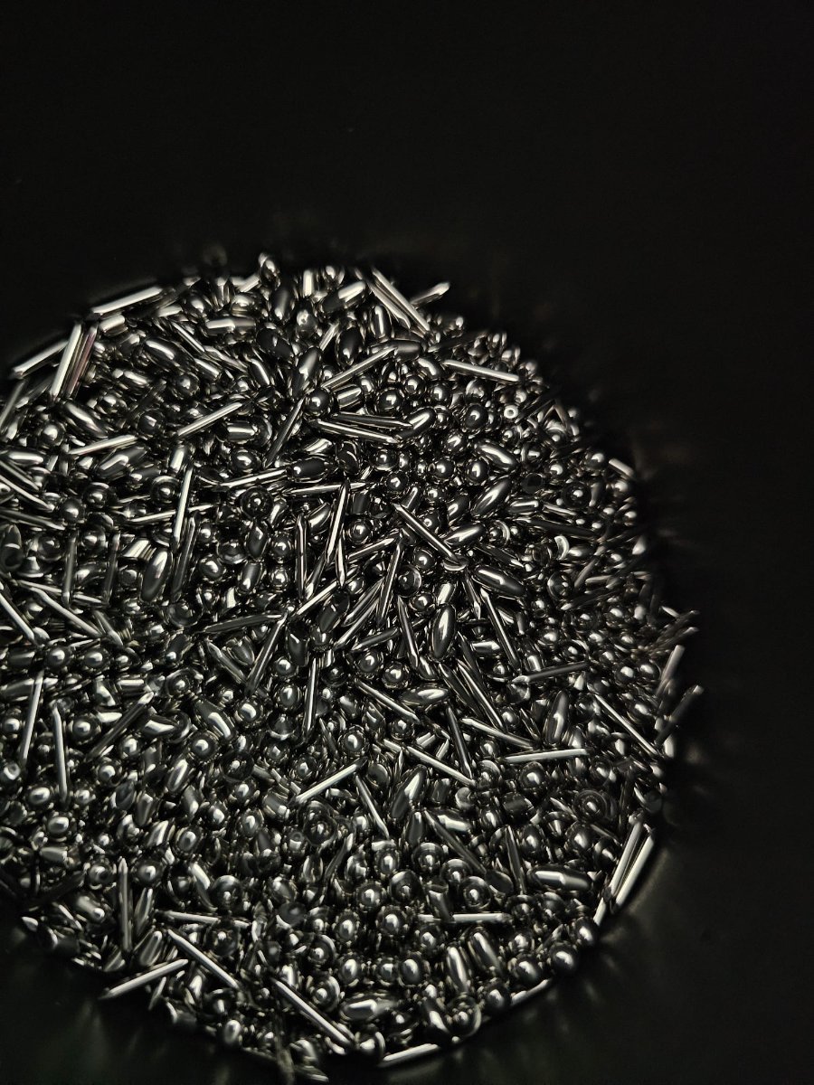

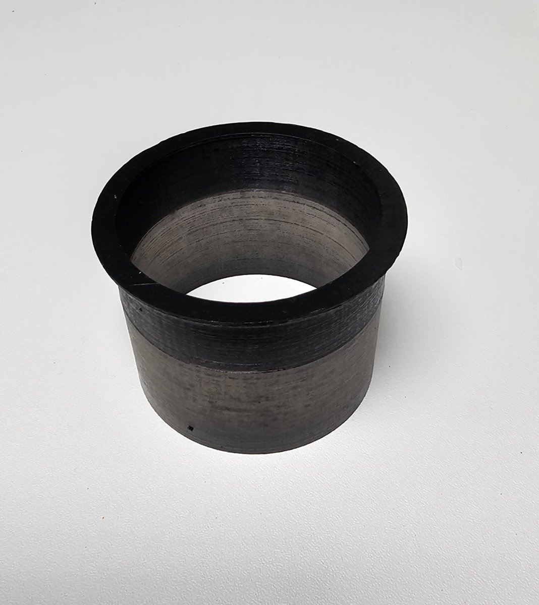

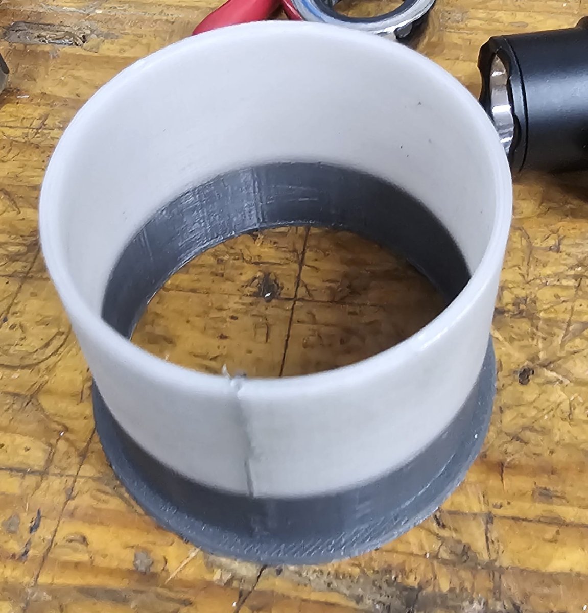

Ok guys, new discussion to take with you guys, i was gifted a rock tumbler with what i think is steel media, i added pictures for better understanding, i also added a test result from a piece that i had laying around, i am not turning at night as it's an old rock tumbler i am not entirely confident and letting it sit overnight, but overall this pictures might have about 20 hours of rocking tumbler
thing is i don't know how to proceed from here, i like the result even if it bleed the color from one side to the other, but i wanted other type of result,

i am adding the pictures of the piece and media that i used
edit: i am not sure which filament i used on this piece, i am almost sure it's PLA, but it could have being PeTG, it was a piece that i was using in a vacuum hose until it broke so i used as a test piece.

The steel media you showed I have used extensively - as in hundreds of hours use. But not for plastic. It is used with a specialty detergent made for this type of burnishing, and softer metal parts such as copper, brass, bronze, silver, and gold alloys are tumbled at a low speed for a period of time. This smooths and work-hardens the surface of the metal. Typical tumbling time in this application is around 1 hour but could be as much as 4 hours. It isn't magical. Garbage in, shinier garbage out. It can be one stage of a finishing process for some types of metal.
Typically the media is used in one tumbler barrel filled about a third to at most a half, covered with water/detergent, and used with one type of metal to prevent cross-contamination.
I would not expect it to be an ideal media for working with plastic.
