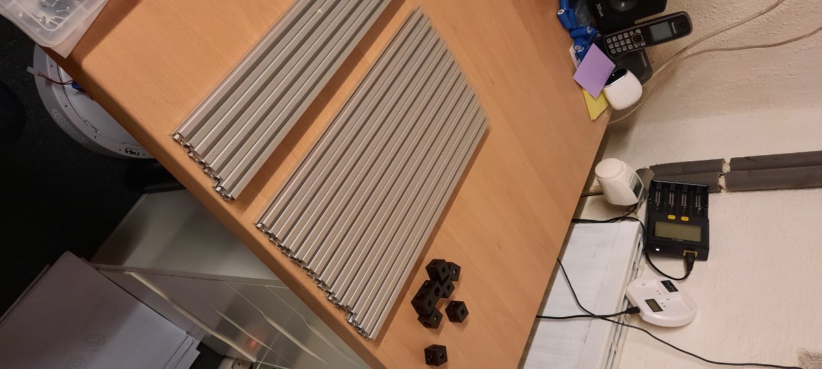

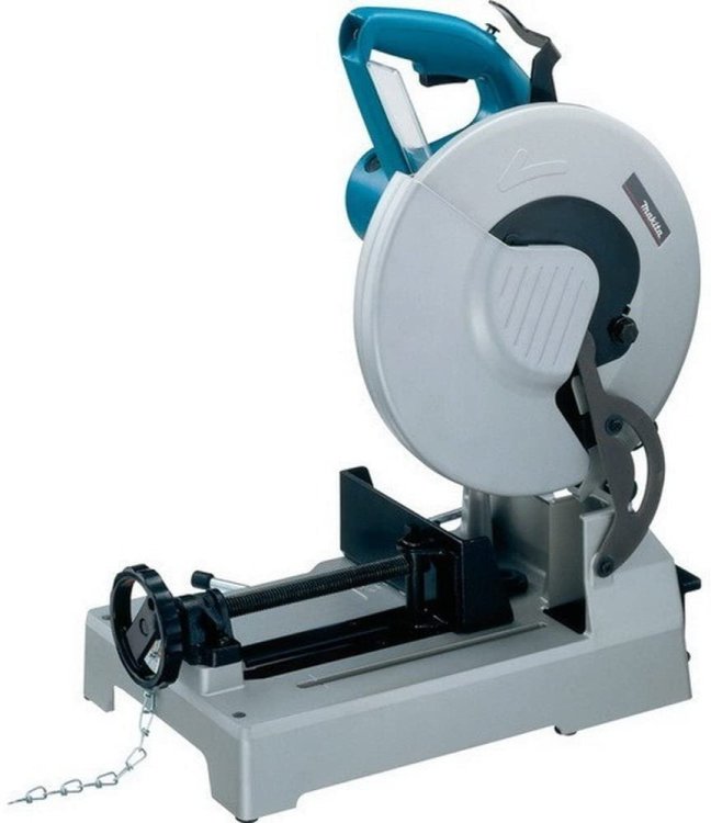

I am cutting my own also, but I have a Makita LC1230 12" Metal Cutting Saw, I bought it for business years back as part of a machine shop that I have. It does tremendously clean cuts in aluminum and steel (different blades).  I ordered 10mm oversize extrusions from Misumi and I just need to trim them precisely (Misumi has tolerances on their cuts which would possibly make them skewed in a build). Of interesting note, it was cheaper to buy cut lengths rather than longer ones for the same overall length of material.
