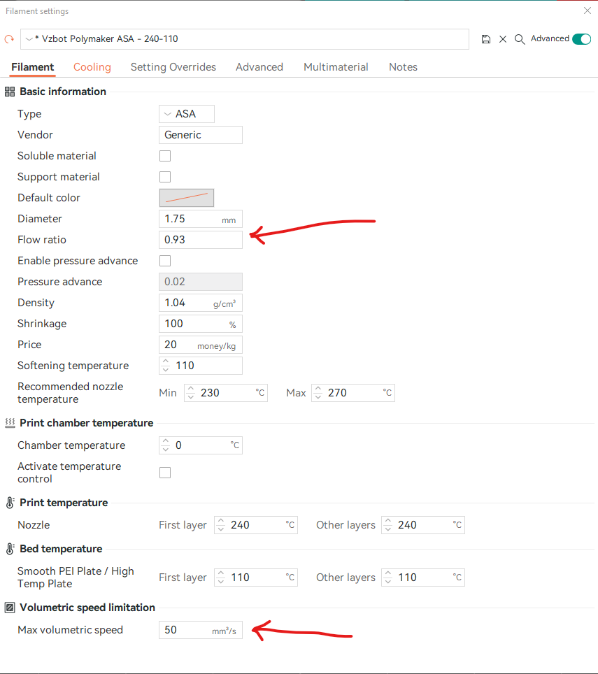

In the Filament Settings window, under the Filament tab...
Flow Ratio increases or decreases the amount of material that flows out of the nozzle. i.e. if parts exhibit over extruded anomalies at 1.00 then reduce to something like 0.95 etc.
Max volumetric speed in the Volumetric Speed Limitation section will slow down the print speed if the calculated flow exceeds your setting. For example, if you have a Rapido hot end and it can flow 40 mm3/s then set it to 40 or 35 just to be safe. This way the printer will never print faster than your nozzle can flow. If your prints are being slowed down, then set this to a higher value. Just understand that if you set it to a value that's higher than your nozzle can flow... you will get under extrusion.
