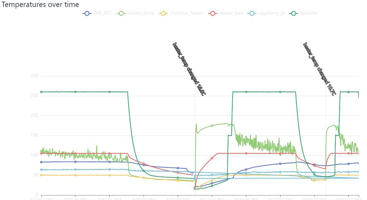

What I saw in your logs is that your thermistor heater_temp, fails. see graph I included. It has a very wavy pattern during printing, suggesting it has a loose contact. bad crimp or similar.
Further in the latest part of your log I see your CAN can not make contact. This might be because of your Rpi is damaged because of the loosened heater_temp thermistor.
So I would have recommended to check all cables and crimped ends again.
