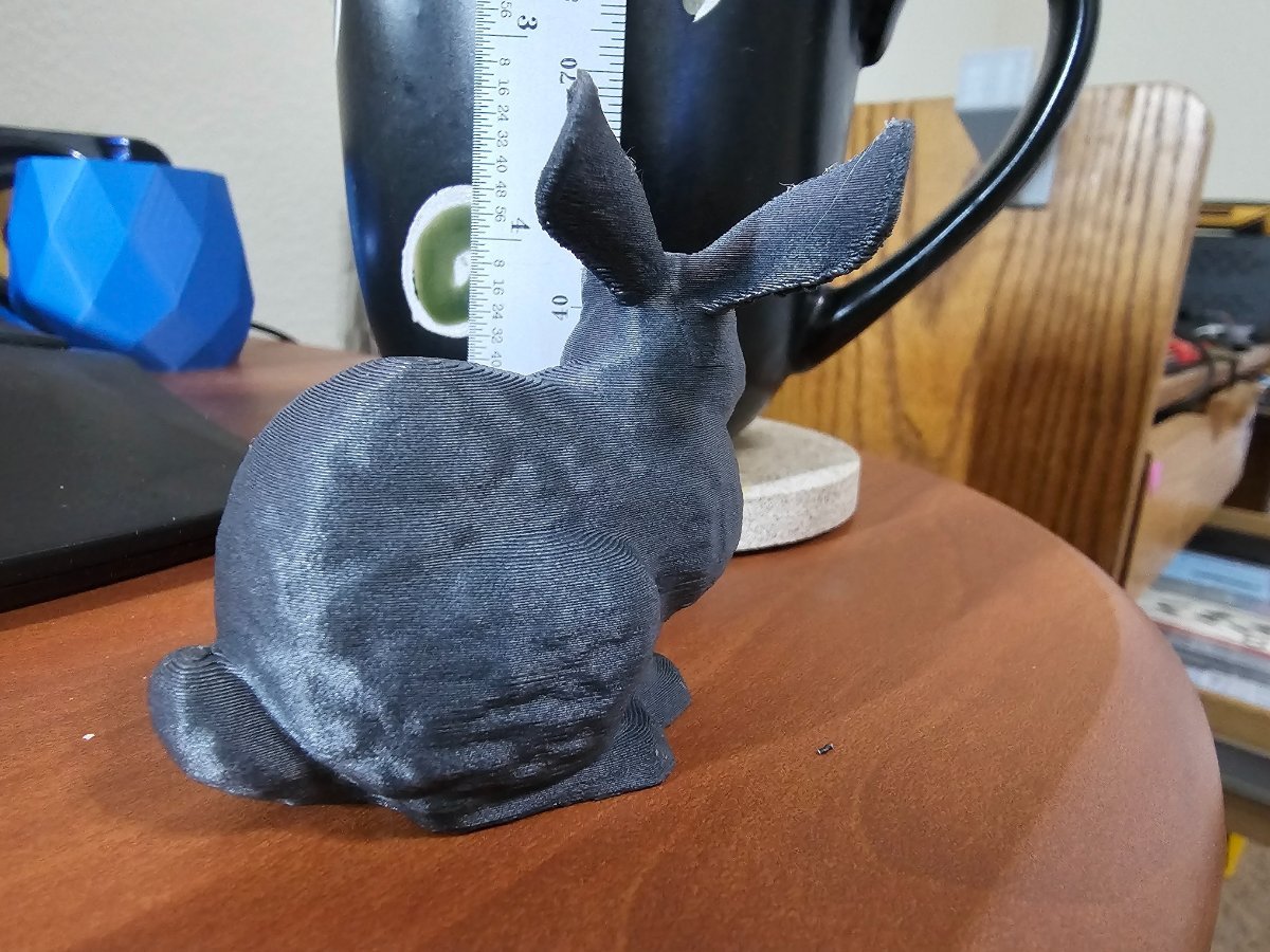

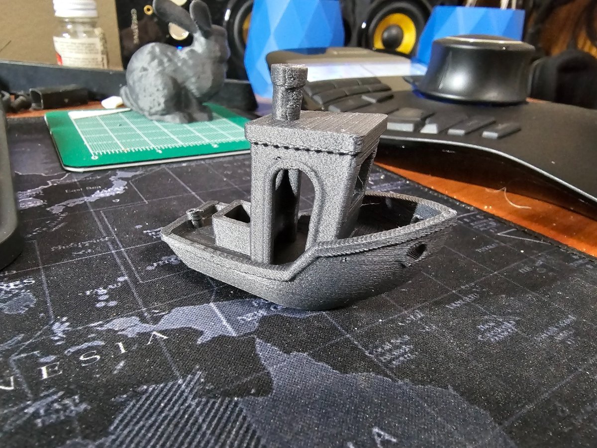

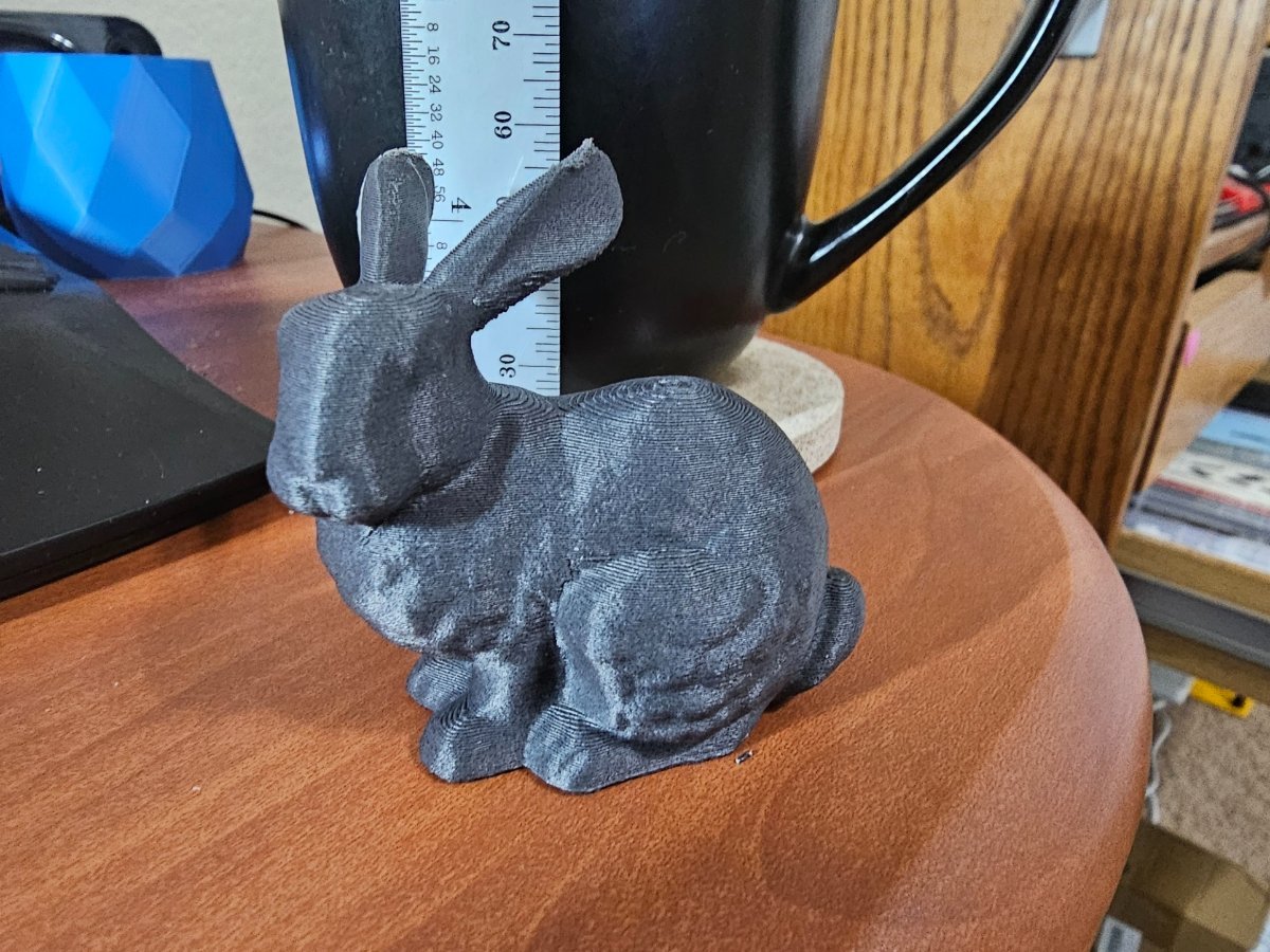

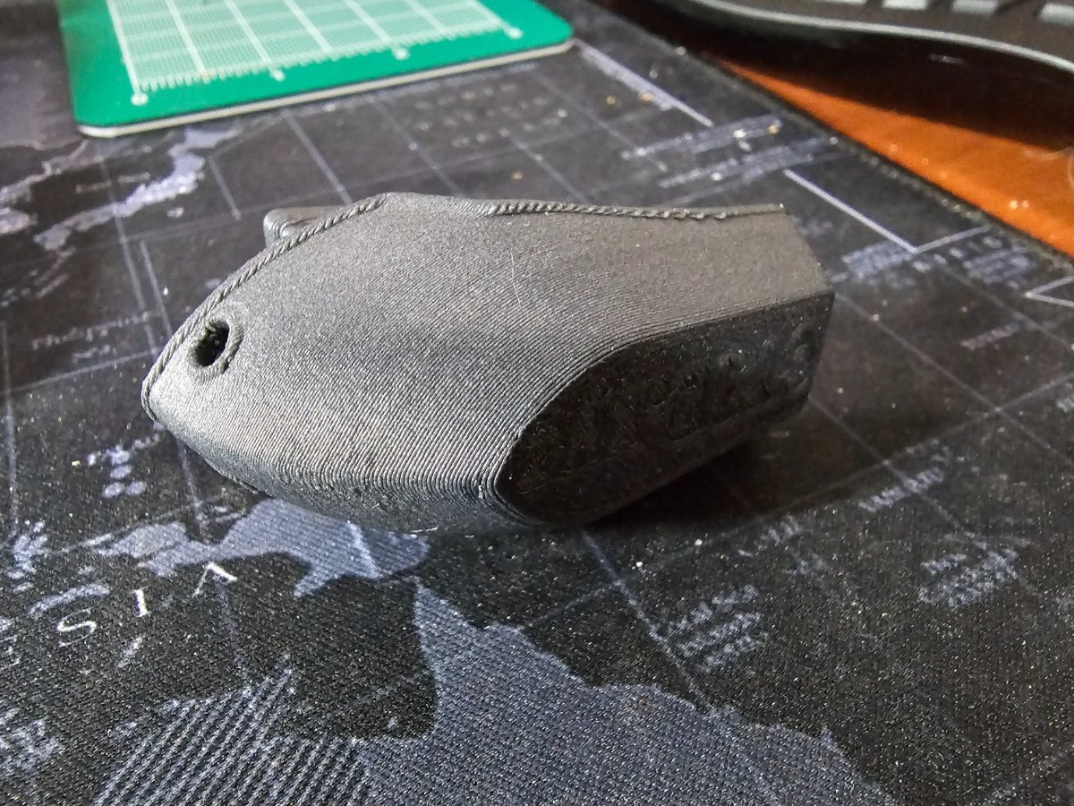

OK, Ran a couple prints. I'm not disappointed with the results either.
Printer: VzBoT 330 AWD
Filament: IEMAI CF-ABS Nozzle: 250c Bed: 110c
Speed: Min 100 mm/s 1st layer - Max 300 mm/s Acceleration: 10K
My first print was a Stanford Bunny @ 50% scale. Print time = ~50mins, No Support.
Next print was a Benchy. Same temps and speeds, no support. Print Time = ~20 mins.
So, overall good 1st experience. I'll print a few more things while I'm working.
