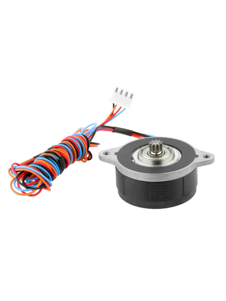

It started with poor top layer, poor layer adhesion and parts had no strength.
Has anyone had an issue with the pancake extruder stepper motor for the CW2?  Further investigation of the CW2, eliminated any possible filament friction issues (took PTFE tubing out of the equation by feeding filament directly in the CW2), then when doing a nozzle purge I could see the filament stop extruding ever so lightly. I rebuilt the CW2 with spare printed parts and installed a new gear, the only item I didn't have was a spare stepper motor. I took the CW2 assembly off the Trident to test my theory that the stepper has a tight stop in it. To confirm it's the stepper motor I installed the Trident stepper motor into the V2 CW2 and it now extrudes properly. Problem solved a new Moon pancake motor is ordered from a local supplier.
Diagnosing any problem is a process of elimination that eventually reveals the root cause. It's easier to accomplish when you have spare parts to test with. 😉

Depending on what you're troubleshooting throwing parts at it can become very costly. Knowledge or previous history of the problem is a great asset. I have over 40 years in the service and repair industry so have some first-hand experience. 😏 Knowing the sequence of operations is a must when diagnosing.
