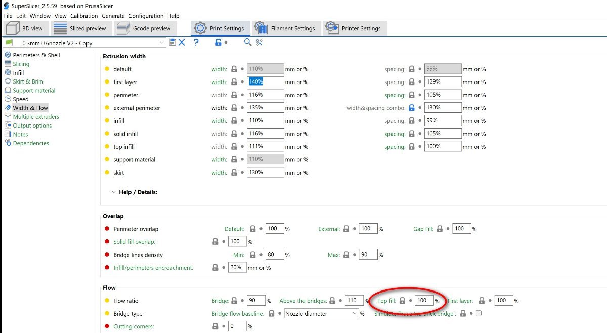

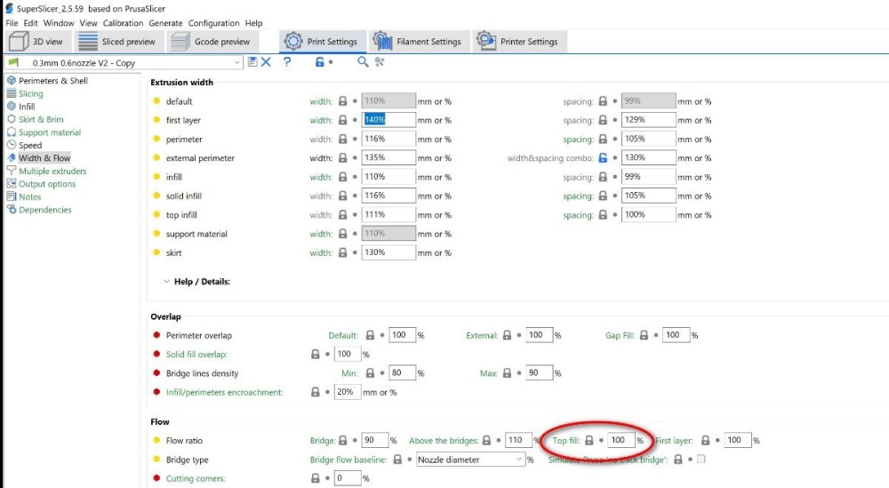

not sure if the top layer flow adjstement is unique to superslicer but a workaround I read about is to manually insert a gcode command to modify the extruder flow just before the last layer. Also, you may want to gave SuperSlicer a try. it's based on Prusa Slicer so it should be easy for you.
