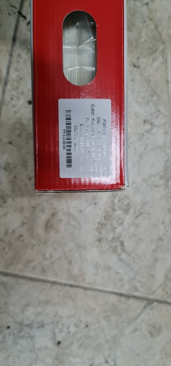

Do you have any experience with this filament? I have been trying to print this for several days with no success 😞
The first layer sticks ok but as the shape builds up the components detach from the surface. this is a pity as the material has
very interesting mechanical properties.
