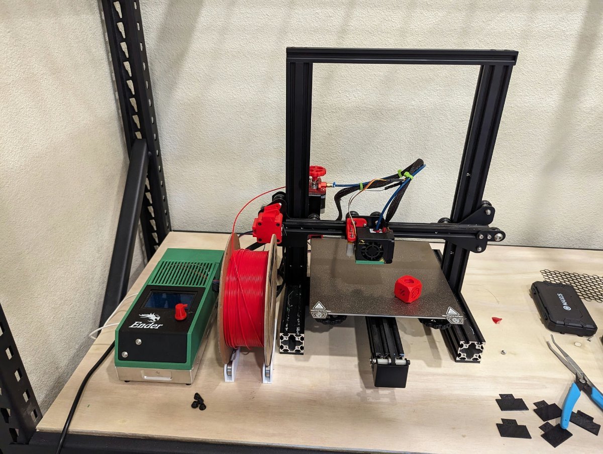

Started down the road of klipper on the ender. I have a Creality 4.2.7 board. Figured I'd try klippain, and by the time I finally got it to install and couldn't find a premade config for it I realized I don't want to go down that road. But it also seems to assume you are already running klipper so flipping between docs for the install didn't help me. (I went in expecting even easier to install 🤷‍♂️)
Couple hours later, the klipper cfg for the board is pretty bare, I've got it all not completely error-ed out and just started working my way through the BLtouch documentation z keeps showing as triggered. The pi for that printer must be just on the very edge of wifi because everything takes twice as long. May have to get ethernet run to printers someday, or a router closer. Will have to get bed mesh and start/end macros in the cfg too. And I should probably get it cleaned up a little before I go too crazy...

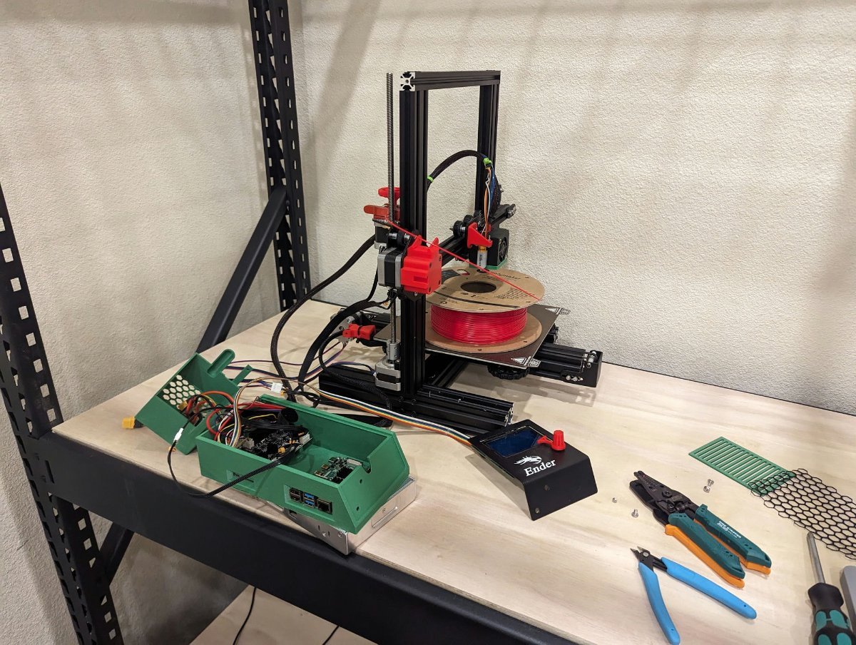

I think I had it running the next day or two after that last post. I also did get a router into the same room so wifi doesn't cut out. I installed all the electronics into its own box, its close to what I want but not quite there (also printed 2 sets of tpu feet for it then had a heatbrake clog and switched back to abs on the Trident). The electronics box I printed doesn't quite leave enough room in my opinion, I may reprint and move it to this instead.
I soldered in a buck converter for the Pi and pulled power off the PSU, then ran off a Voron Cube, but it shakes the shelf enough to mess up the trident's Z Tilt and Mesh. So next step is to anchor the shelf to the wall. It also stays powered off because the hotend fan runs full out 24/7 and isn't quiet (probably should've went BTT SKR instead).
 Still have to figure out a new enclosure for it before I can get much use out of it. (also put new textured pei on it instead of flat glass).
