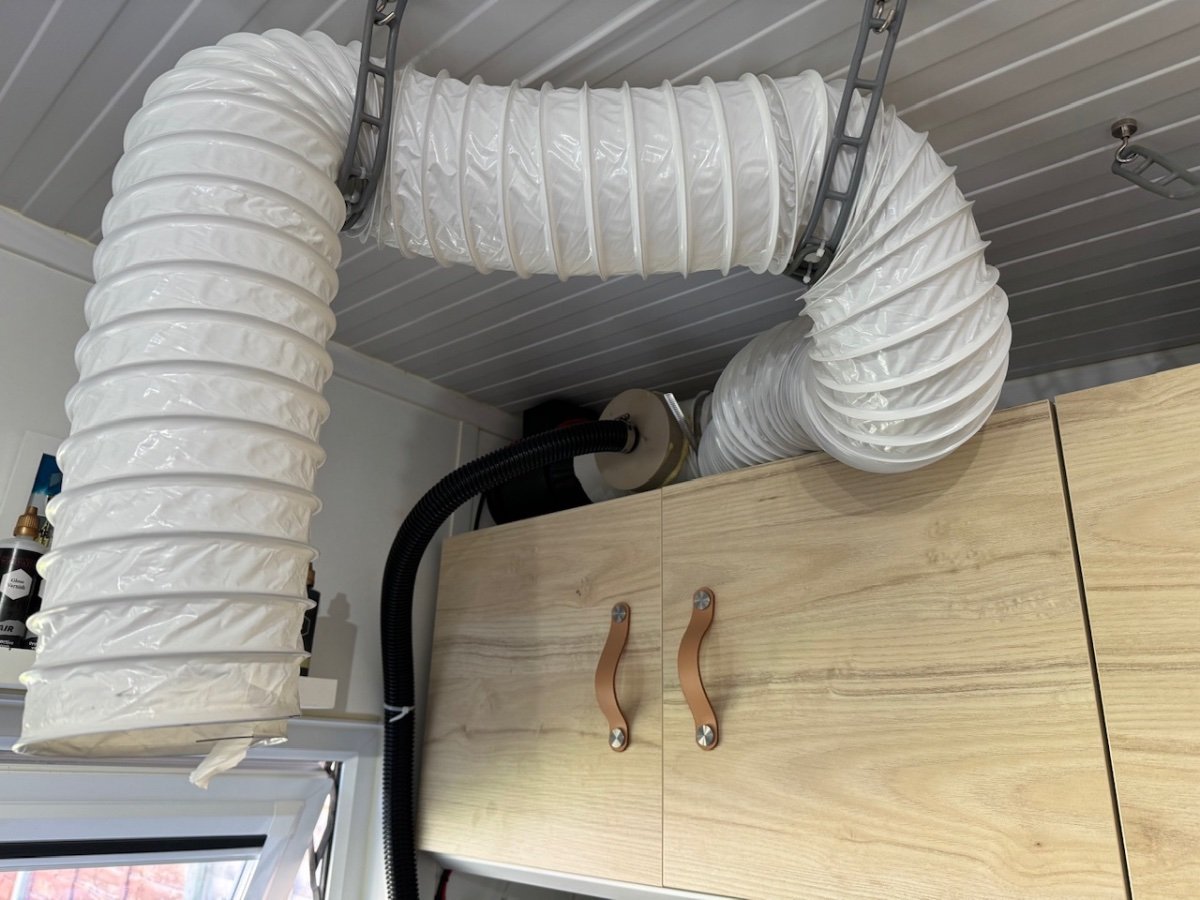

I do, however, need to get extraction to the outside air working before I can print in ABS at scale.  Even with the Nevermore it's hard to be in the same room as the printer when it's printing ABS and not get a headache from the fumes.  I just need to decide if I;
  • move the printer so I can use the existing extraction I put in place for my resin setup
  • extend the hose from there to the printer
  • drill a new hole in a different wall and vent this one separately
Edited by xyleth
The aforementioned existing setup. That’s a 100mm inline extractor of the sort used for hydroponics rooms - shifts plenty of air!
The 100mm hose is for general room extraction or fits onto my airbrush spray booth when I’m doing some base coating. The 32mm ID hose is for the SLA printer and it’s probably that I’d look to hook the Voron up to (it’s on a magnetic mount). The flow is lower but should be enough to provide negative pressure without dropping temps too much.
the downside is that fan is loud when it’s running!  So you don’t get a headache from the fumes, you get it from the noise instead 😝. With the SLA printer I’ve taken to only printing over night and then using the fan to turn over the air in the office before I come in of a morning.
a quieter option would be to use a 120mm PC fan inline with some 63mm dust extraction hose to the Voron and then out another 100mm hole in the office wall. Won’t be as much airflow, but should still be enough to maintain negative pressure.
would welcome thoughts from anyone with experience of doing this themselves!
I am using an inline 100mm fan, you know one for smoke extrusion, not connected to klipper or otherwise, its always running, slowly.
I used an adapter to get from 100mm to 60mm and connected that to the printer, still my printer has no issues heating up to 45/50 degrees and (almost) never have warping.
I used another exhaust print on the back so it connects to the top with magnets, very handy, if you need to move the printer a bit, for maintenance or other shit.. uhh, stuff.
https://thealuminumcarpenter.com/products/voron-2-4-exhaust-system-v2
You can use the fan mentioned on the website too ofcourse, I found that the inline smoke fan system is a bit of overkill, its running at 5% or so.
