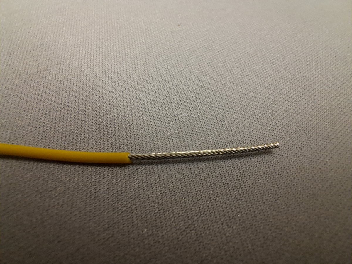

I see that the site promotes Tefzel for it's high heat and chemical resistance, and for motorsports for light weight. BUT. Is it motion-rated? That's really what we care about for the printers. Weight isn't a big deal in this application, nor is chemical resistance (maybe some ISO alcohol will spill on it). Heat won't get much more than 60C.

Motion rated, I'm not sure..With the references in the thread to wire from Aliexpress and Amazon, I'm sure real milspec tefzel is a step ahead. I try not to take motion ratings seriously on Chinese wire anyways.
I can't tell the difference in the insulation between tefzel and ptfe, except the tefzel might be tougher to strip. The strands of wire in Tefzel are neat and perfectly twisted.
Weight isn't a big deal but diameter starts to matter sometimes. Don't really need 600v insulation giving 24v pwm to a fan.
That's 20 gauge 19 strand Tefzel in the picture.

On their site they say that it is 'tin coated' but they don't state the conductor material. Being 20% lighter suggests to me that it might be aluminum wire which would not be great for a moving cables.
"ultra flexible" 20 gauge wire would have 100 strands, where each is 0.08mm in diameter.  The stands would not be twisted like that as the standes need to move relative to each other when the wire flexes.    The wire in the photo is a good and tough wire that would work very well in a vehicle's wire harness.   That is its intended use too.
It's absolutely not aluminum wire. Tin coated copper. This is the same wire used in fighter jets and missles.
The 20% lighter claim is comparing the insulation thickness between /16 & /32.
