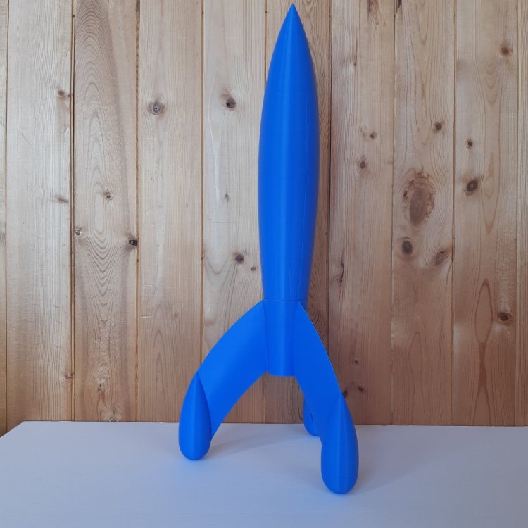

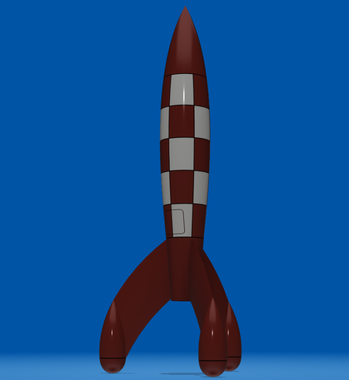

As a flying model builder, I have always wanted to make a replica of this rocket but the curvy art-deco style was a nightmare to make from 2d materials. 3D printing is ideal to reproduce curvy shapes so now that my F360 are getting better I tried to draw it and it turned out really nice.

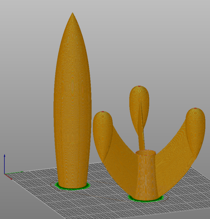

The model is split at the first segment line above the fins. The outline of the square pattern and cargo door is embossed on the surface. The fuselage is hollow and the pods are full so you can scale the STL and print with infill to have strong feet and use a raft to ensure good adhesion.

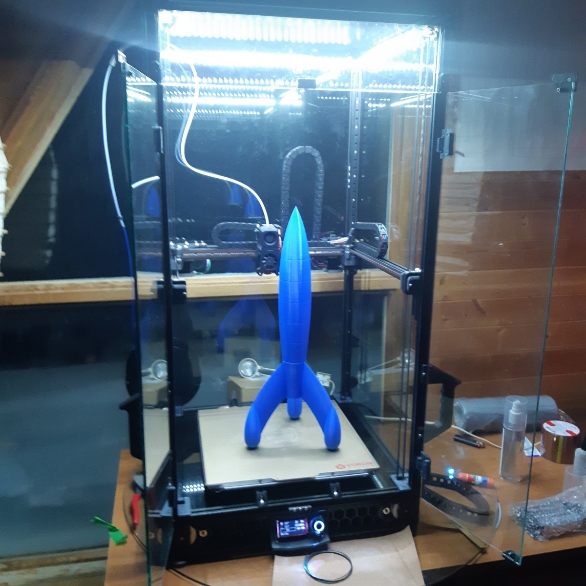

Probably too big lol.  my printer is very very tall. Scale in your slicer for your needs. the fuselage is 340mm tall as is.
Yes i saw your Voron build so i guessed it was big 😊 To big for my printer without scaling. Are you gonna paint it red/white?

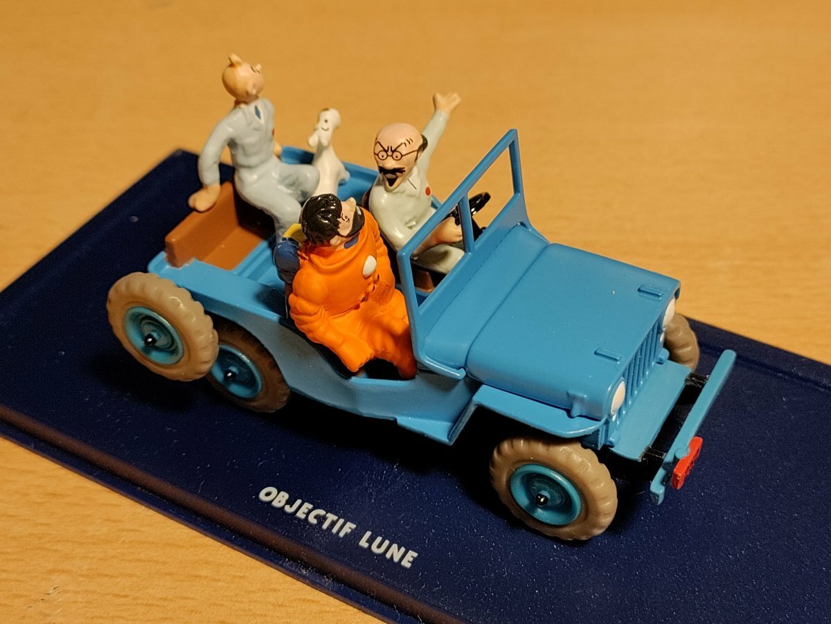

I have this beautiful scale model of the Jeep with the professor (don't know his English name) going : Is this the work of a fool ?  I want to print the rocket in scale to the Jeep.
I measured it in the comic book and it turns out to be about 120 - 140 cm high so it'll have to be printed in segments.
I'll have to figure out the best way to do this
the scale of the model car is 1:43  if the scale is true, then the 4.24m Jeep Willys should measure about 100mm, given the above scene with the trucks and workers, I estimate a proper scale model would be at least 20 time the jeep's length in height, so 2m at least. It's definitely doable but a hella project for sure. Keep us posted!
